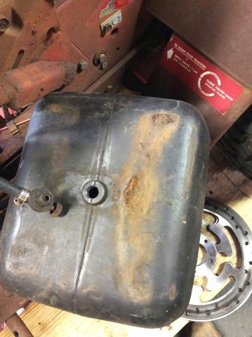

limited12 360 #1 Posted December 8, 2014 (edited) i need some advice on if this can be repaired, i have a fuel tank on my c-120 where the plug came out, can this just be reinstalled, should i use some type of glue/adhesive. the shut off still works and i would like to just reinstall, can this be done. Thanks for your help Edited December 8, 2014 by limited12 Share this post Link to post Share on other sites
jeremi3210 752 #2 Posted December 8, 2014 Napa sells new fuel tank bushings. If yours is not damaged or really hard maybe you could reinstall it. You will have to pull out the fuel valve put the bushing in the tank, then push in the fuel valve. Some silicone spray will make things go easier. 1 Share this post Link to post Share on other sites
gwest_ca-(File Mod) 12,488 #3 Posted December 8, 2014 The original 104047 bushing has been replaced by 46-6560 and still available from Toro. $3.77 at Partstree Stens 125-336 https://www.bantasaw.com/catalog/viewproduct.asp?i=&p=220 Garry Share this post Link to post Share on other sites
ericj 1,580 #4 Posted December 8, 2014 replace the rubber bushing and the shut off while your at it if not you will regret it later don't ask me how i know this eric j 3 Share this post Link to post Share on other sites
wheel-mule 46 #5 Posted December 8, 2014 I sell these bushings for $3.plus $1 shipping .I've never had any luck reusing them with out them leaking.There is a little secret to installing them.Coat the out side with a good lube spray or vasaline,start it in to the tank,about 1/4 the way.Than coat the fitting the same way start it into the bushing about the same 1/4 of the way.Than push the bushing in all the way than the fitting all the way.If you install the bushing all the way before starting the fitting you will never get the fitting in as the hole in the tank is a press fit. 2 Share this post Link to post Share on other sites
