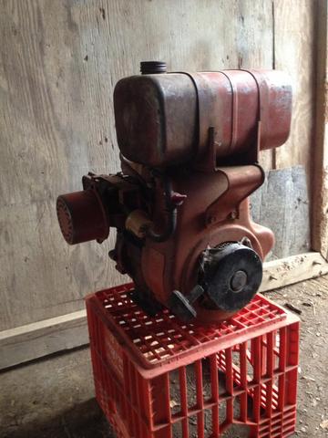

Bert 804 #1 Posted December 6, 2014 Picked this up about 1 min up the road, it was on a troy bilt tiller with electric start and a complete charging system. It runs great! I didn't realize it was cast iron till I got it home and noticed rust by the exhaust, so I got a magnet and it stuck to the block. Ive heard they were out there but had never seen one I think this will be a nice repower for the work horse 700 or the 653, can't decide which yet though I like the idea of stock apearance with some extra weight and durability. 3 Share this post Link to post Share on other sites

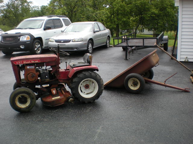

Geno 1,931 #3 Posted December 7, 2014 Very, very nice score Bert. I have one on my 657. I can take better pics of the decal on the engine if you like or this pic blows up pretty big. The decal had a big "XL" on it with "Extra Life" under it then "Cast Iron" under that. 2 Share this post Link to post Share on other sites
Bert 804 #4 Posted December 7, 2014 Very, very nice score Bert. I have one on my 657. I can take better pics of the decal on the engine if you like or this pic blows up pretty big. The decal had a big "XL" on it with "Extra Life" under it then "Cast Iron" under that. Yes Id like to get some close up pics if you wouldn't mind? It looks like the same decal thats on my HH100. Also would like to see the carb and cable setup. This one is a lil different then the wheel horse setup and i was wondering if id need to trade from my tired work horse 700 engine? Thanks 1 Share this post Link to post Share on other sites

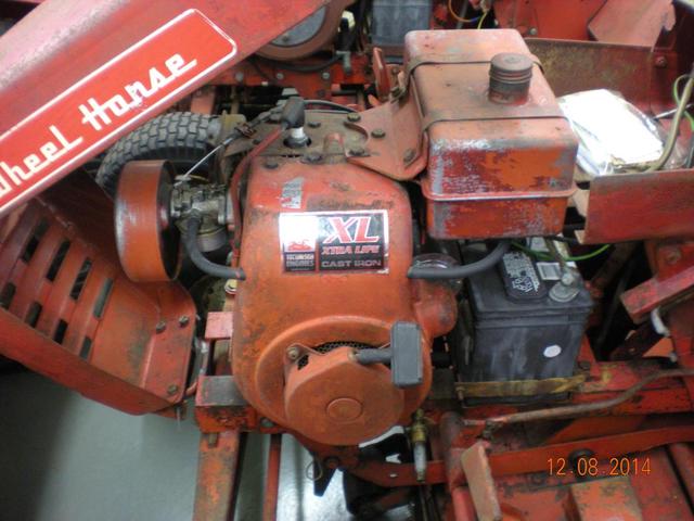

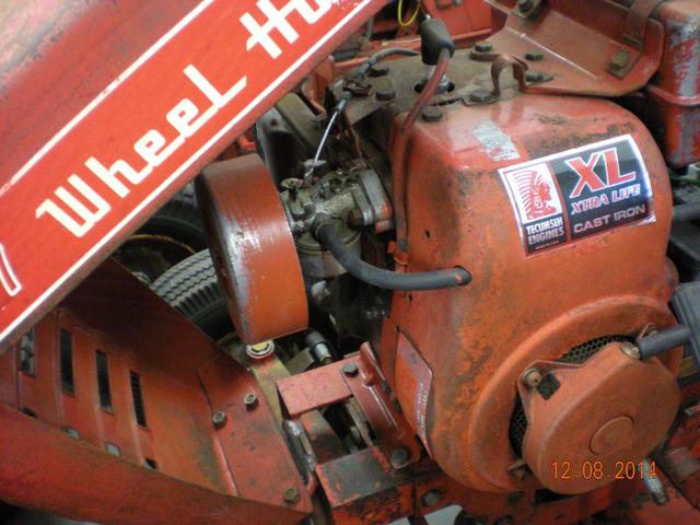

Geno 1,931 #9 Posted December 8, 2014 Hope these are good enough, I cant get the hood up all the way as it is buried in the back of a row. I can plan to get it out if you need more pics. You can click on them to enlarge them. 1 Share this post Link to post Share on other sites
Bert 804 #10 Posted December 9, 2014 So I guess I will be trading some parts from my tired h70. Thanks for the pics Geno, that decal looks like the one on my HH100. I wonder if they are still available? 1 Share this post Link to post Share on other sites
Geno 1,931 #11 Posted December 9, 2014 I don't know. Maybe Terry can make one from a good Hi-res pic like he does some other stuff, I'm not sure though. Wouldn't hurt to ask. Does your decal look better than mine? Share this post Link to post Share on other sites

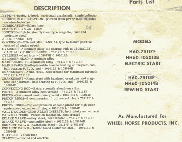

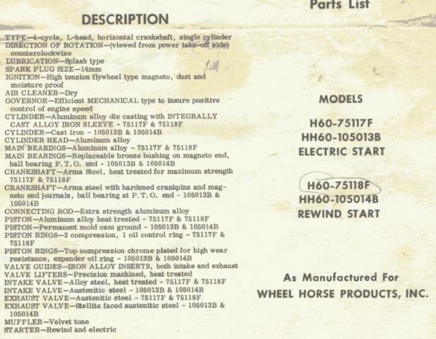

pfrederi 20,629 #17 Posted December 9, 2014 This summarizes the differences. Valves could interchange, same size just different materials 2 Share this post Link to post Share on other sites
Bert 804 #18 Posted December 10, 2014 Pfrederi, great page thanks for info. Share this post Link to post Share on other sites
Retired Wrencher 6,694 #19 Posted December 14, 2014 Very, very nice score Bert. I have one on my 657. I can take better pics of the decal on the engine if you like or this pic blows up pretty big. The decal had a big "XL" on it with "Extra Life" under it then "Cast Iron" under that. Geno the XL like this see the original underneath is not the original engine it should have the balloon emblem. That would be a HH60 engine. Share this post Link to post Share on other sites

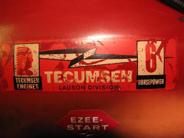

AMC RULES 37,259 #20 Posted December 14, 2014 (edited) My '63's original tin decals...these have recently been repopped, have the link if interested. Edited December 14, 2014 by AMC RULES 2 Share this post Link to post Share on other sites
Bert 804 #21 Posted December 14, 2014 Thats neat, Ive never saw one like that. Share this post Link to post Share on other sites

Retired Wrencher 6,694 #24 Posted December 14, 2014 My '63's original tin decals...these have recently been repopped, have the link if interested. sweet looking Craig Share this post Link to post Share on other sites
Bert 804 #25 Posted December 14, 2014 My '63's original tin decals...these have recently been repopped, have the link if interested. repopped? not sure what you mean but Id like the link to see. thanks Share this post Link to post Share on other sites
