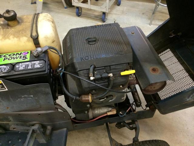

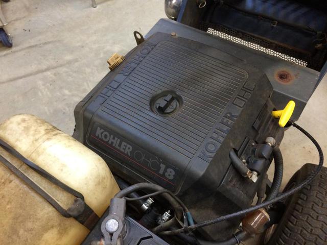

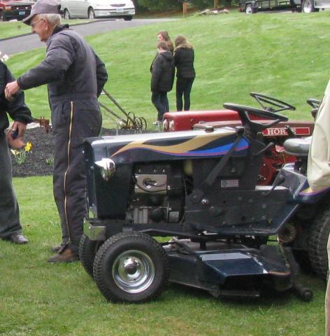

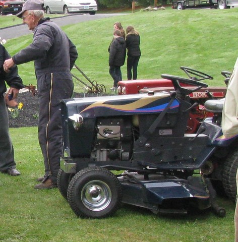

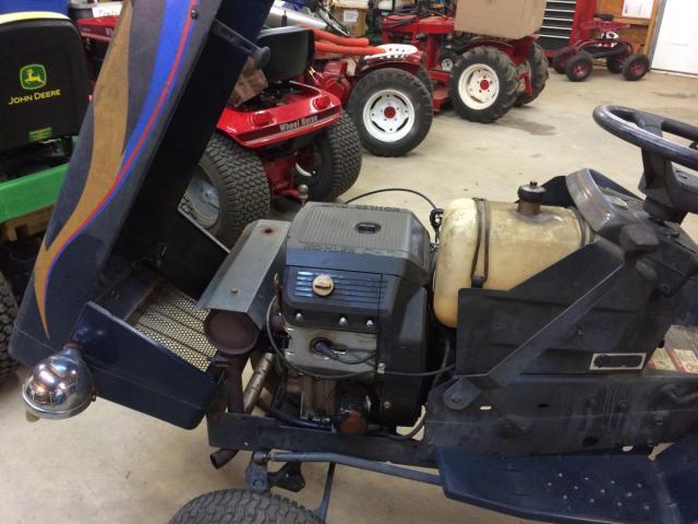

clueless 3,440 #1 Posted December 3, 2014 Pictures of the Kohler OHC that some people say they never made. Over 900 hours and still running strong. -Chris in Florida Share this post Link to post Share on other sites
546cowboy 302 #2 Posted December 3, 2014 I've never had any Wheel Horses newer than 1991 so I've never seen an OHC Kohler. Thanks Share this post Link to post Share on other sites
joel_400 59 #3 Posted December 3, 2014 Ive seen them but never on a wheelhorse. Isnt that a simplicity? 1 Share this post Link to post Share on other sites
craigbic 47 #4 Posted December 3, 2014 Sweet! Looks like a cool paint job too! Share this post Link to post Share on other sites

Jim_M 179 #6 Posted December 3, 2014 Thanks for posting the pictures. Just like a new car engine, they keep it covered so you can't see much. If you ever have any of the covers off of it, snap some pictures for us. I'm going to download the manual for it when I get a chance so I can see the insides, but pictures are always better. Share this post Link to post Share on other sites
clueless 3,440 #7 Posted December 5, 2014 Sorry, didn't mean to imply the engine came on a Wheel Horse. Just showing the motor because some people didn't know they ever made them. The tractor that it is on is a 75th anniversary Simplicity Sovereign. Jim, I would like to take the valve covers off to show you, but they are the biggest flaw in the design. The plastic covers eventually flex and warp, leaking oil down on the fins. You can't see it and it becomes dirty and clogged with grass clippings. The engine starts overheating and you can drop a sleeve or the piston sticks to the cylinder. The valve covers have been siliconed to prevent this, but if I ever have to remove them we will take pictures. The link below is information about this engine from a man who knew them well. http://www.simpletractors.com/Club2/topic.asp?TOPIC_ID=124577 -Chris from Florida 1 Share this post Link to post Share on other sites
