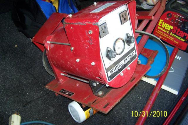

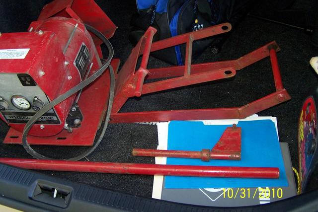

whtractors24 3,572 #1 Posted December 2, 2014 I've owned 3000 watt generators and normally those click in where the mule drive goes and in the center attach a matic and then there's a knob on the bottom of the generator to tension the belt.... on the 5k same concept plus an added flag pole like a snow blower setup when you lift and lower the arm it moves generator minimal is this to help support ?? 1 Share this post Link to post Share on other sites
Lane Ranger 12,133 #2 Posted December 2, 2014 Both 3000 watt and 5000 watt versions has lift pole underneath. The manual for these is on Red Square. Generac made these for Wheel Horse. I have a 3000 watt. Share this post Link to post Share on other sites
whtractors24 3,572 #3 Posted December 2, 2014 I saw the manual why does it need to have a lift arm ???? It lifts it maybe a 1/2 inch Share this post Link to post Share on other sites
Lane Ranger 12,133 #4 Posted December 2, 2014 support when running the generator at higher speed. It's heavy and the frame for the generator is probably not enough support for all that weight out front on the tractor. Share this post Link to post Share on other sites
