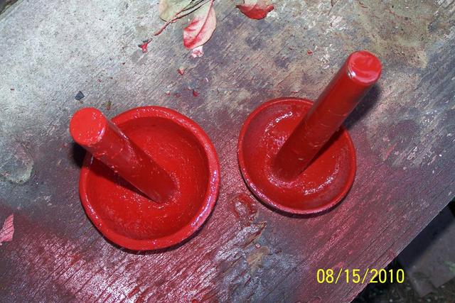

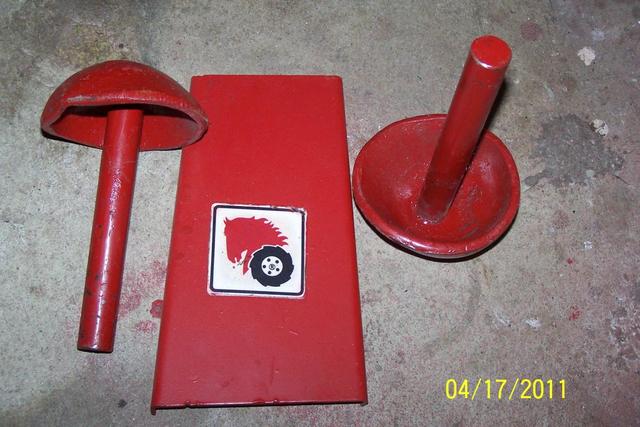

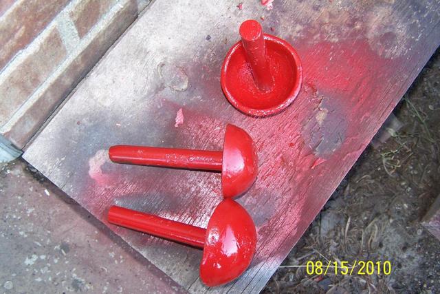

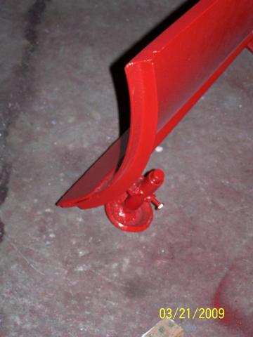

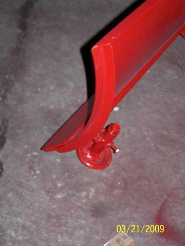

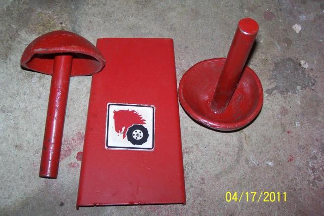

Lane Ranger 11,680 #5 Posted December 2, 2014 The 54 inch plows and earlier plows had skids. The skids were on 3/4 round stock rods with half rounded cups welded to the bottom of the 3/4 inch rod. These skids could be adjusted up and down for various applications. The later plows had skids like Garry has in his guidance above. We made four of them four years ago in my dad's blacksmith shop. We made the cups heavier for longer wear. Here are some of the pictures. Here they are on a 54 inch plow: These are the ones we made: 2 Share this post Link to post Share on other sites

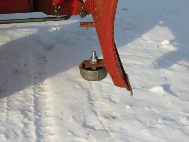

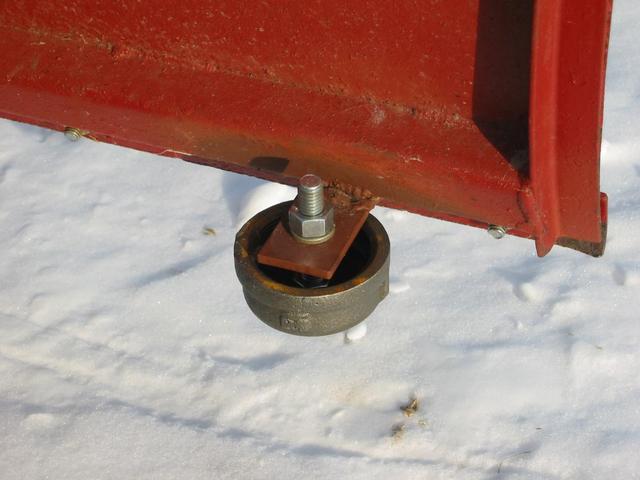

pfrederi 19,278 #6 Posted December 2, 2014 I made these for cheap using carriage bolt and black iron Pipe cap. On this blade the support is welded to blade. On another one I bent the steel and bolted it using one of the blade edge bolts. Product improvement will be to weld the carriage bolt to the pipe cap. Currently the bolt head wears off and the cap falls off after about a season and a half. 3 Share this post Link to post Share on other sites

Tankman 3,525 #9 Posted December 2, 2014 I made these for cheap using carriage bolt and black iron Pipe cap. On this blade the support is welded to blade. On another one I bent the steel and bolted it using one of the blade edge bolts. Product improvement will be to weld the carriage bolt to the pipe cap. Currently the bolt head wears off and the cap falls off after about a season and a half. Great idea! I'm headin' that route quickly. Thanks for the pic's! I reading, "Drill the pipe cap and weld in a 1/2-13 carriage bolt." Nice! I like the "use blade edge bolts" for mounting, smart! Share this post Link to post Share on other sites

pfrederi 19,278 #11 Posted December 3, 2014 Great idea! I'm headin' that route quickly. Thanks for the pic's! I reading, "Drill the pipe cap and weld in a 1/2-13 carriage bolt." Nice! I like the "use blade edge bolts" for mounting, smart! You got it. One thing make sure you use lock washers (and i add loctite) as they seem to want to unscrew themselves. Share this post Link to post Share on other sites
