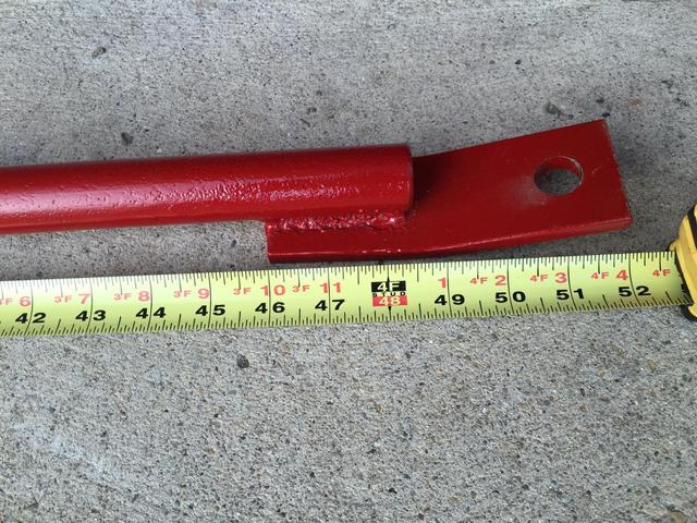

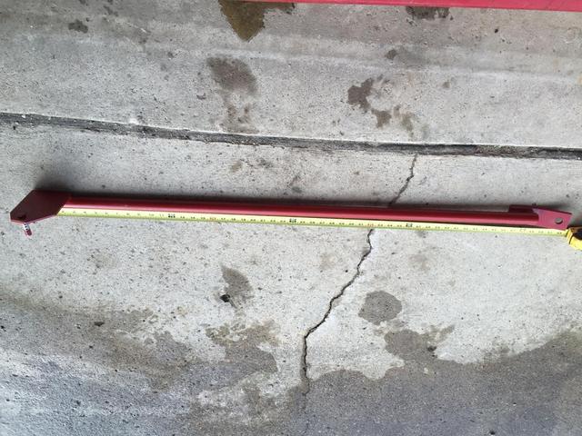

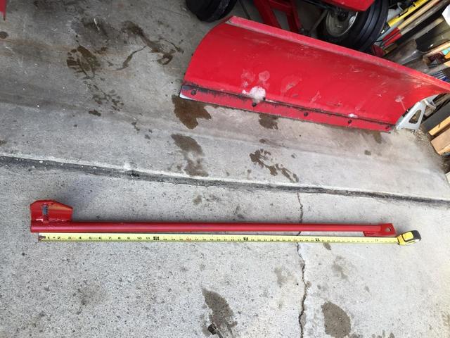

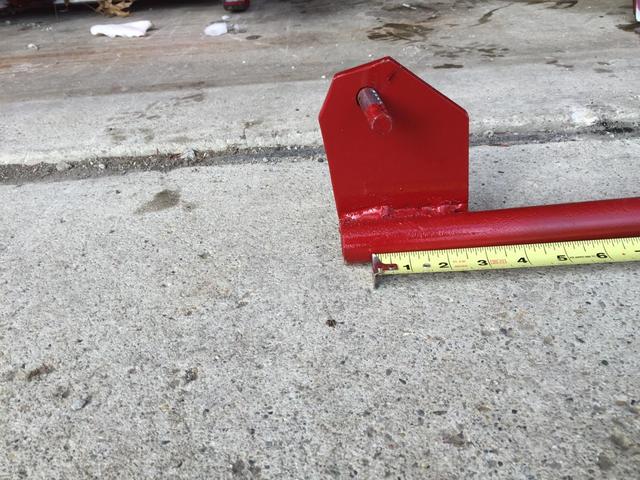

Well I thought of doing that before hand but low and behold I didn't. Suppose to warm up this weekend so I will go out and unpin it snap a picture, put a tape to it and I'll go from there. Best I can do

Ok, well I got the flag and rod removed today for pictures. From the center of the hole where the rod mounts to the snowblower back to the flags clevis hole is 51" the hole is approx. 4 5/8" up from bottom of the rod. Pictures to follow
ronwh
Burly,
Thanks,that helps a lot.
Ron
