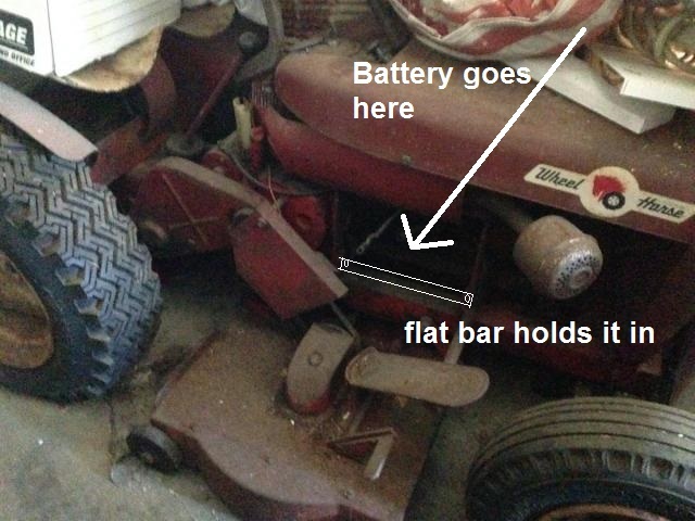

wallfish 20,572 #14 Posted November 29, 2014 (edited) The place for parts will depend on what you need. You already have all the good Wheel Horse parts like belt guards, foot rest ect. The mechanical parts can be found at local mower shops and around the web at places like Partstree.com, Pats small engine, Moparts ect. ect. ect. Once you figure out what you need then search around and ask questions here, members can direct you to the places they use. It is a 12v electric start Lauson (Tecumseh) H55 engine. Use a quality lawn & garden size battery, It fits right in the space on the right side of the tractor and sits on the frame. Right where I see battery cables in one of your pics Recently sold sickle bars that fit that tractor. They are model # CBR-32 front sickle bars. You can also find snow/dozer blades, snow blower, moldboard plough, trailer, roller and a bunch more of hard to find attachments. Do a search here on this site for "suburban attachments". There's plenty of data already posted here on those tractors too so there's plenty of good info to read up on. Edited November 29, 2014 by wallfish Share this post Link to post Share on other sites

Beagles 72 #16 Posted November 30, 2014 Thanks for the reply's, I spent some time today cleaning it up with wd40 and steelwool, I also put some MM oil in the eng and let it sit, and then turn it over to check if it was seized up.(all good) I then put a jump pack on the battery cable too check the starter, she turned over fine, ( plug out ). I am going to clean the carb next and then try and start her up. I have a few questions, There was a problem with the steering so I removed the front wheels and started checking things over and found a loose nut at the bottom of the steering shaft. That will be an easy fix, I notice the steering linkage look different, and I wanted to know if this was OE? ( see attached photo 2078). Front tire are filled with cal I think, what is my best plan for them. The tires are good front and back. Rims might need paint, looking for ideas on that. I would also like to see a photo of how the battery was tie down on the frame, if any one has a good photo. Thanks, Dave 4 Share this post Link to post Share on other sites
wallfish 20,572 #17 Posted December 1, 2014 Looks like the tierod was changed but that looks OE to me Rim paint, antique white is very close to linen beige The battery is held in by a piece of 1/8" flat bar with 2 holes that match the 1/4-20 studs if they are still there http://www.wheelhorseforum.com/files/download/1074-tractor-1961-401-551-701-da-om-ipl-wiringpdf/ SEARCH "suburban 551" in the manuals section for more info for the trans ect. Share this post Link to post Share on other sites
