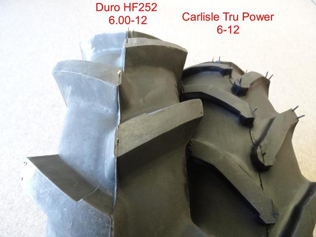

shallowwatersailor 3,222 #7 Posted November 27, 2014 I am using the published manufacturer specifications for Duro and Carlisle tires. The Duro HF252 6.00-12 is 25 inches tall and 6.1 inches wide when mounted. The Carlisle Tru Power is 22.7 inches tall and 5.7 inches wide when mounted. Duro does not sell a 6-12, and Carlisle does not sell a 6.00-12. The photo is from a vendor on eBay. It probably is not important on a 2wd tractor but makes a big difference on a 4wd tractor like the older Kubotas for their drivetrain to not bind. Yes, different manufacturers make the same size tires yet end up being different actual dimensions. For example, Kenda and Titan both make a 16X7.50-8 size turf tire but the Kenda is approximately 1 inch taller. I know as I have both on two different 5xi. 1 Share this post Link to post Share on other sites

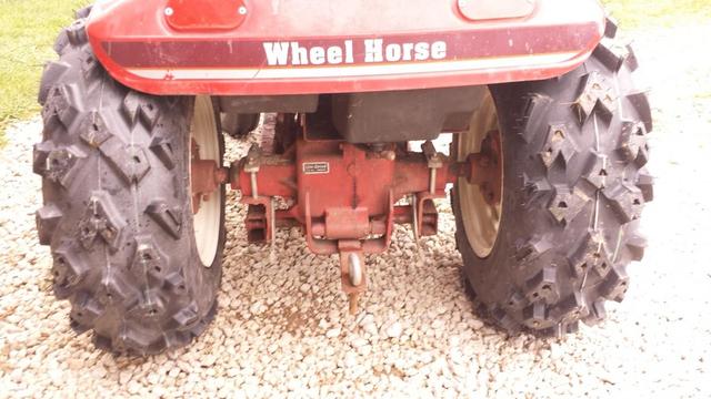

diamondred 63 #13 Posted November 29, 2014 (edited) You gotta run what ya brung. 25-8-12 utv tires, if you want to move when the tires spin. Best tire investment yet. Best because: 1. Tallest tire you can fit in the fender without mods. 2. Nice fit on a 7 1 /2" rim. 3. 6 ply. 4. Don't need chains. Edited November 29, 2014 by diamondred 3 Share this post Link to post Share on other sites

Geno 1,932 #17 Posted January 2, 2015 The Duro tire is wider but the tread is not, the Carlisle has much wider tread, I have quite a few of both of them here. Gotta watch specs closely it seems... Share this post Link to post Share on other sites
