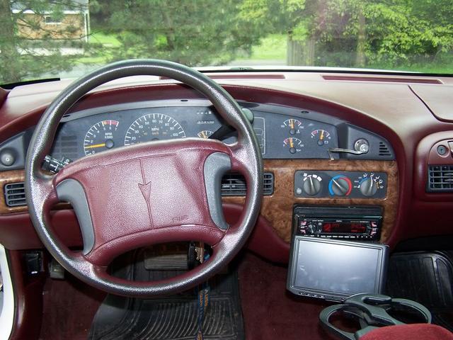

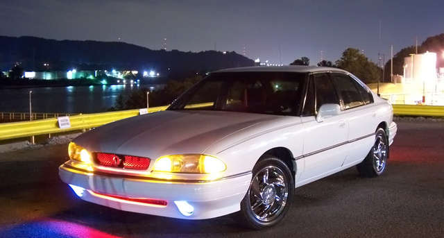

bmsgaffer 2,064 #7 Posted November 26, 2014 (edited) Haha just about! Had the power to back it up too! Get this, I had a bright white bonneville with a velvet red interior (stock color!). I was an electrical guy so I even hooked up LED lights under the dash that made the floor glow red. I thought i was hot stuff... It was my first car, despite the fact that it was a little odd color, i kept that car immaculate. And to think my wife still married me after dating me for a few years with that car! The car was only sold because it was totaled by a toyota tacoma rear ending me at 35mph. Edited November 26, 2014 by bmsgaffer Share this post Link to post Share on other sites
