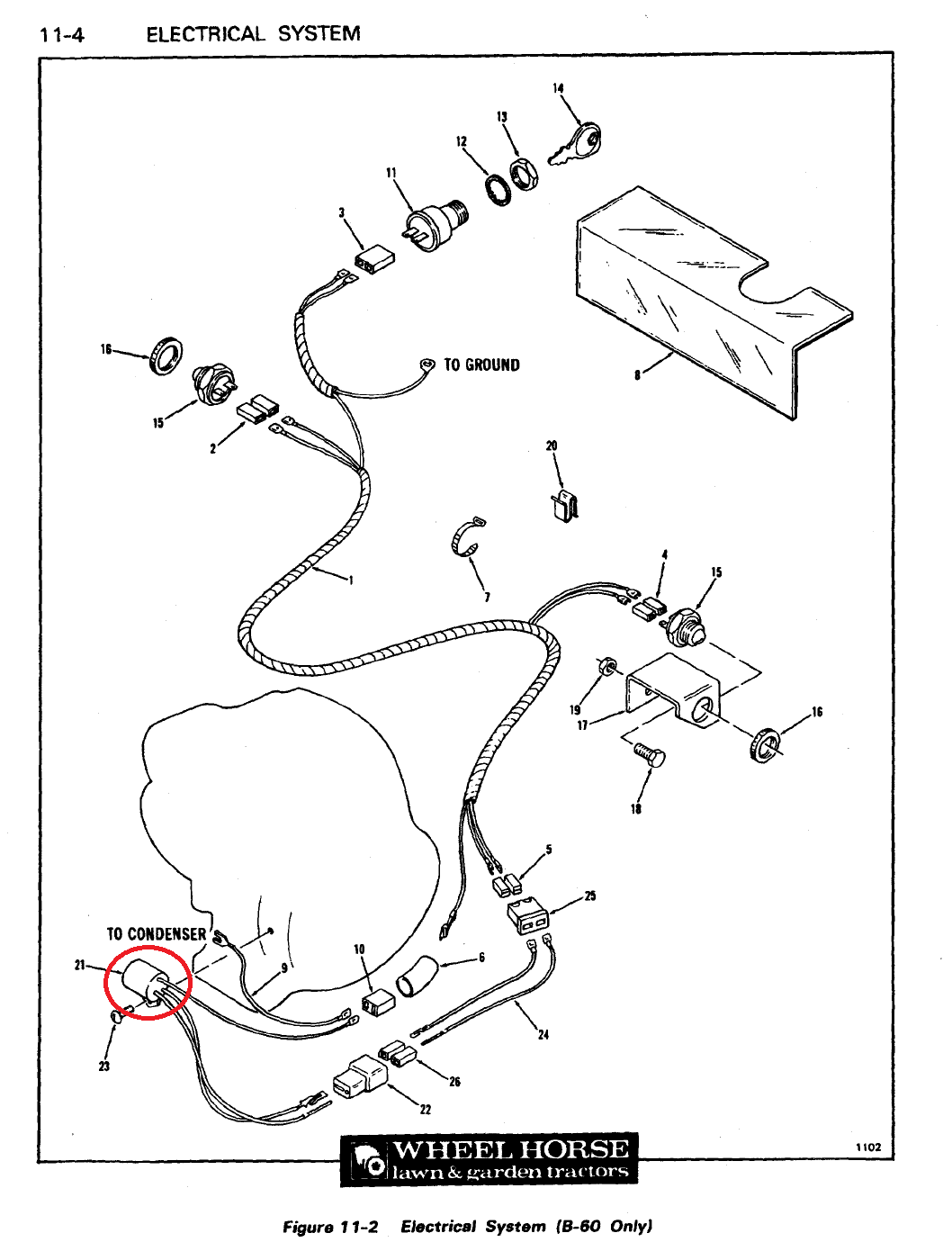

rmaynard 17,659 #1 Posted November 24, 2014 Pictured below is the electrical system of a B-60. This machine has the K-161T engine with a magneto ignition. Item #21 is described as an interlock module. Does anyone know what exactly this little can is/does. I have not been able to start the engine yet, but I am a little suspicious of this item since the wire coming from it which is supposed to go to the condenser is disconnected, and a new condenser has been wired in. Share this post Link to post Share on other sites

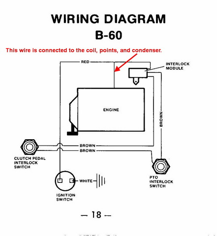

gwest_ca-(File Mod) 12,557 #3 Posted November 24, 2014 Wiring diagram Connected to the condenser would be the same as connecting to the points or magneto kill wire. Garry Share this post Link to post Share on other sites
slammer302 2,157 #4 Posted November 24, 2014 I have a b-60 and I had the same question I ended up removing it and she runs great Share this post Link to post Share on other sites
rmaynard 17,659 #5 Posted November 24, 2014 (edited) According to the wiring diagram, it looks like you have to depress the clutch while starting. Now I can see that with electric start, but I generally need two feet on the ground when I yank a starter. Guess I'll have to read the owners manual and see what it says. Edited November 24, 2014 by rmaynard Share this post Link to post Share on other sites

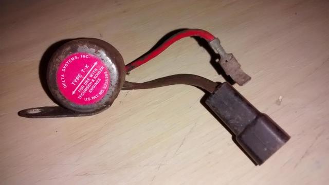

slammer302 2,157 #7 Posted November 24, 2014 Just a round piece with wires this what it looks like without it Share this post Link to post Share on other sites

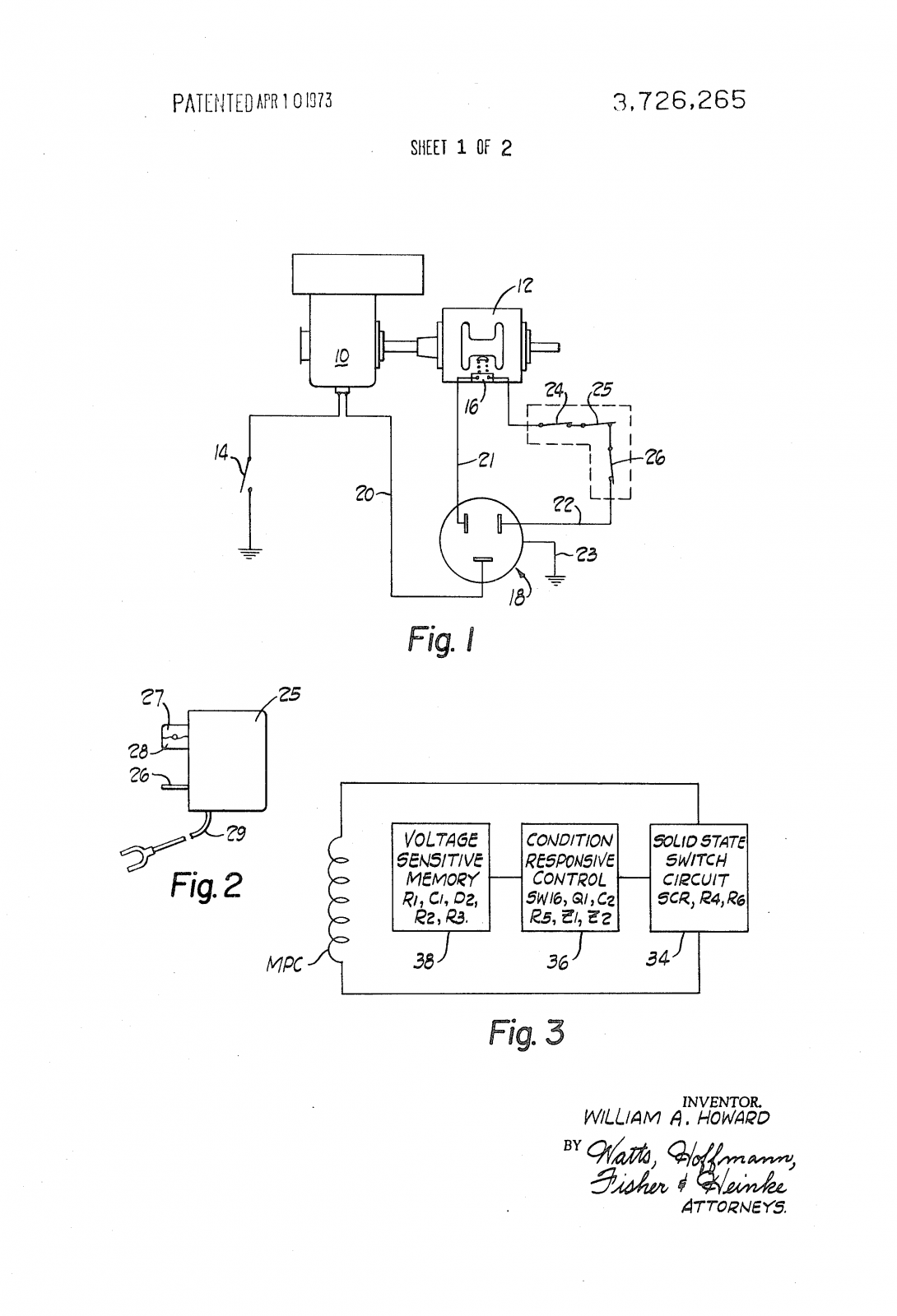

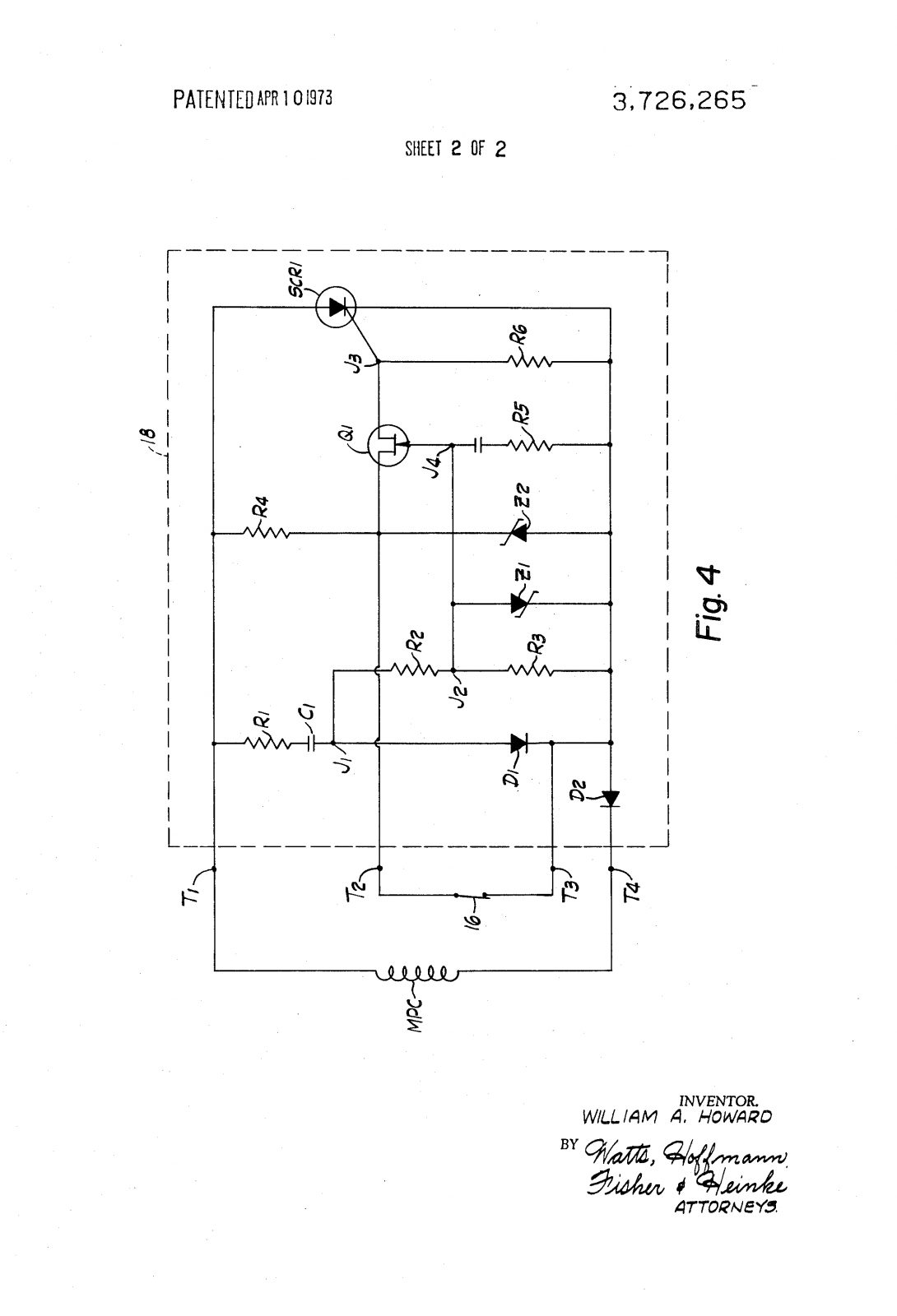

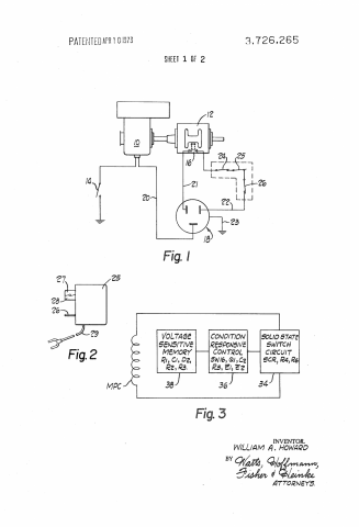

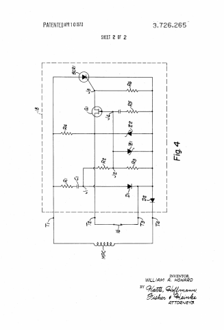

rmaynard 17,659 #12 Posted November 25, 2014 (edited) I found the patent number for the module. Here is a description of what this little thing does. Ignition magneto safety interlockUS 3726265 A ABSTRACT Circuits for controlling the starting of an internal combustion engine that has a magneto ignition system including a primary winding that can be shorted to prevent ignition. The circuits include a position-responsive switch and an electronically controlled switch to selectively control a shorting switch that is, in use, connected across the primary winding of a magneto. In the preferred arrangement, the shorting switch is normally nonconductive and is maintained nonconductive (1) when the position-responsive switch is closed, indicative of a condition in which it is acceptable to start the engine, or (2) when the electronically controlled switch is changed from its normal level of conductivity in response to the running of the engine. When the position-responsive switch is opened before the motor is started, the normal condition of the electronically controlled switch permits the shorting switch to be made conductive by the spark producing pulse and thereby prevents ignition. The position-responsive switch is actuated through a transmission of the engine being controlled and in the embodiment shown is normally closed when the transmission is in neutral. Got that? Added picture: Edited November 25, 2014 by rmaynard Share this post Link to post Share on other sites

gwest_ca-(File Mod) 12,557 #14 Posted November 25, 2014 These go with the patent description which is quite large. Garry Share this post Link to post Share on other sites
km3h 543 #15 Posted November 25, 2014 If I read this right, this will ground out the ignition when the key is turned off causing the engine to shut down. Share this post Link to post Share on other sites
gwest_ca-(File Mod) 12,557 #16 Posted November 25, 2014 The ignition switch on it's own will shut the engine off the way the tractor wiring diagram shows it. With the key ON to start the engine the module must ground the ignition also unless the clutch switch and the pto switch are both closed. Once there is coil output the module must open the ground so it continues to run with the clutch switch and pto switch open. These switches are the same switches used on the C-Series in 1977. The poor online parts lists for 1976 show different switches but can't find a wiring diagram for them. The A-Series rear engine riders also used this modeule with the B&S engines. Garry Share this post Link to post Share on other sites

rmaynard 17,659 #18 Posted November 25, 2014 (edited) I'm pretty sure that I have the wiring diagram for the 1976 B-60. As soon as I find it I will post it. Brian - Sometimes it's difficult to pull that recoil from the drivers seat. I can see why this was defeated. Edit - here is my B-60 wiring diagram. Apparently it is the same as the one in your file above Garry. Edited November 26, 2014 by rmaynard Share this post Link to post Share on other sites
