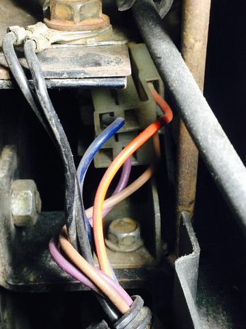

Vincez 1 #12 Posted December 29, 2014 (edited) I've installed (2) new PTO safety switches. Unfortunately ALL wiring diagrams that I've seen for my 1989 310-8 tractor isn't clear as to the connection points for each wire, particularly for the (2) tan wires, so I don't know where they are suppose to connect to? I thought I took them off the old switches and replaced them one for one, but it wasn't working. I've since changed them around and connected the battery, manually held the switch fingers down, and the tractor DID turned-over. However, when I reattached the switch assembly into the tractor it would not start! So now I am thinking that there is a short in one of the PTO connection wires?? At this point I am confounded by this??? The Test Light works and the Headlights work, so power from the battery is not the issue. Any thoughts about how to test the wires that connect to the PTO switches, would be appreciated.... Edited December 31, 2014 by Vincez Share this post Link to post Share on other sites
gwest_ca-(File Mod) 12,524 #13 Posted December 30, 2014 Sometimes I have to pull the pto lever back to make the starter switch work and it has not changed in years so I don't think it is a fast wearing problem. Have you seen the detailed wiring diagrams? Each circuit has it's own diagram making it easier to understand. Garry 1 Share this post Link to post Share on other sites
Vincez 1 #14 Posted December 31, 2014 I've installed (2) new PTO safety switches. Unfortunately ALL wiring diagrams that I've seen for my 1989 310-8 tractor isn't clear as to the connection points for each wire, particularly for the (2) tan wires, so I don't know where they are suppose to connect to? I thought I took them off the old switches and replaced them one for one, but it wasn't working. I've since changed them around and connected the battery, manually held the switch fingers down, and the tractor DID turned-over. However, when I reattached the switch assembly into the tractor it would not start! So now I am thinking that there is a short in one of the PTO connection wires?? At this point I am confounded by this??? The Test Light works and the Headlights work, so power from the battery is not the issue. Any thoughts about how to test the wires that connect to the PTO switches, would be appreciated.... Share this post Link to post Share on other sites
Vincez 1 #15 Posted January 3, 2015 Please look at my last (2) posts... I can't figure this out, perhaps I damaged or burnt out something else - - I don't think so, but no matter how I connect the PTO wires (Blue & Orange to one switch) and what appear to be (2) tan wires to the other. Does it matter which switch these attach to> top or bottom once installed? I've tried both ways... Connections as follows: The Blue wire w/plastic harness connects to the NC2 terminal, the NO3 terminal then is covered by plastic from the harness, and the Orange wire connects to the COM connection on the side of the switch. What confuses me is the connections to the other switch, especially since I'm not certain of the color of the (2) wires: I assumed, just like above that one connected to the NC2 terminal, the NO3 was left empty, and the other connects to COM. However, the one time the engine turned-over, I had on on the NO3 and one on COM - - MANUALLY holding the fingers down. Unfortunately, once I screwed the switch assembly into the tractor, again NOTHING. Share this post Link to post Share on other sites
gwest_ca-(File Mod) 12,524 #16 Posted January 3, 2015 I take it both switches are identical. I take it that the pto lever pushes the buttons on both switches when the pto is in the OFF position The starter circuit from the wiring diagram "N.O. Contacts closed when pto disengaged" Rewritten - "The normally open contacts are closed with the pto OFF." The Com terminal is the where the tan wire goes from the ignition switch S terminal. The ignition circuit from the wiring diagram "N.C. Contacts open when pto disengaged" Rewritten - "The normally closed contacts are opened with the pto OFF." The Com terminal is the where the dark blue wire goes from the M terminal on the ignition switch for magneto ignition Com means that terminal is common to the NC and NO terminals. It is either connected to the NC terminal or the NO terminal. Has to be one or the other depending on button position. Normal means the status of the switch at rest - in other words button not pushed. Make sense? Garry Share this post Link to post Share on other sites

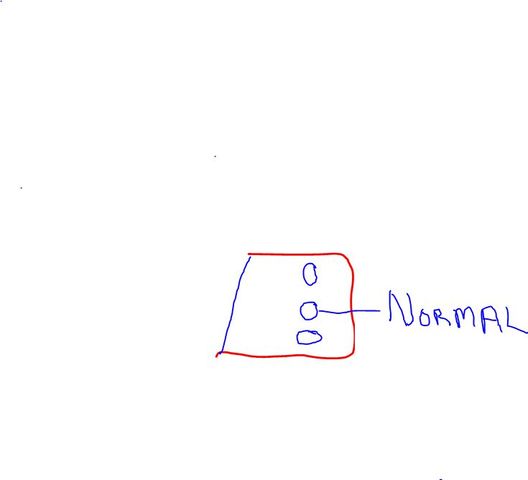

Vincez 1 #20 Posted June 1, 2015 I do have an ohm meter. I have gone back and fourth with JackHammer prior to winter. I replaced the (2) switches and replaced the solenoid. The machine runs fine if I jump start, but the minute I put the PTO switch connections in place, I get nothing from using the key. Also, checked the key switch. Share this post Link to post Share on other sites
Solex 27 #21 Posted June 1, 2015 Remove the the bolt from the switch mounting bracket so that you can get acces to the switches. Pull the mounting bracket aside with the wires and connectors still attached. Tape the bottom switch closed or in the made position. Leave the top switch open. In my case, (312-8) this simulates a PTO disengaged situation and the engine starts. If your your engine starts, this is the condition you want to replicate when the switches are bolted back in relationship to the cam on the PTO handle. Again in my case the top switch metal actuator was shortened and the cam actually rubs up agiainst the plastic contact on the switch to make this top switch function. So when the PTO is engaged both switches are made. Share this post Link to post Share on other sites

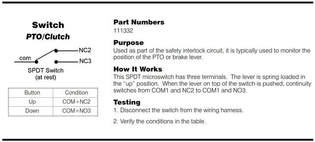

gwest_ca-(File Mod) 12,524 #22 Posted June 1, 2015 (edited) Take at least one of the switches back out and study it so you understand how they function. Use your ohmmeter to verify the status of the switch in each position.GarryAdding - The illustration is not correct in labeling the NC3 terminal. Should be NO3 = normally open 3. The NC2 = normally closed 2. Normally is the switch status when it is not activated by the button or lever. Edited June 4, 2015 by gwest_ca 1 Share this post Link to post Share on other sites
