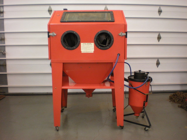

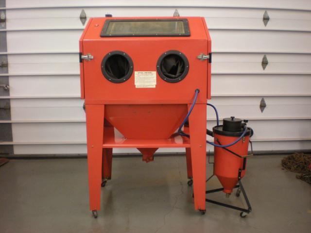

pacer 3,181 #5 Posted November 23, 2014 My experience with the HF cabinet is different from Maynards -- I have had the large HF cabinet for some 4 years now and and is arguably in the top 2-3 tools in my shop, I'm constantly going by it and cleaning anything from a rusted bolt/nut up to what ever will fit in the cabinet. You DO have to assemble it and while a bit 'fiddly' I didnt find it to be that big a deal. I DID pay attention to any area that could possibly be leak prone and caulked or added weather stripping to a few places, it has little to no leakage. The gun that came with it was not useable - the design of it caused a venturi effect at the tip causing condensation thereby causing 'clumping' of the media (any media I tried) Changing to the gun shown below solved all that problem. (Since my cabinet is older, HF may have changed the design) I have had one of these - very inexpensive - kits for many years and is my go to for large pieces, just setting up out in the yard and letting it fly. I use fine Black Beauty for out side blasting, (any thing coarser than fine in Black Beauty will clog my guns) Then I use a media from "Tacoma company" -- http://stores.ebay.com/tacomacompany/Media-Blends-/_i.html?_fsub=2605752010&_sid=739735460&_trksid=p4634.c0.m322 Called "power blend" for the cabinet Here the kicker in most cases -- it takes a LOT of air to media blast, with a 2 stage compressor really needed to realize/gain the wonderful benefits of blasting. My compressor is rated at 19 CFM and when I'm doing a largish piece it will run constantly, but will hold some where around 80-100 psi. Thats not to say that any compressor wont do blasting, what happens is you will get an initial burst of air and the gun will perform well, but will quickly fall off and will not move the media, pausing and letting the compressor recover and get another short burst of use (this is where the CFM figure comes in) Another kicker is the dust inside the cabinet - it will be BAD, requiring some means of getting it out of there ... Lighting - ya gotta have it! The small fluorescent light in my cabinet performed very well for some 3 yrs and when it failed, I simply went to Home Depot and got one of the inexpensive 24" 'under the cabinet' fixtures and mounted it in there, to my old tired eyes it give plenty of light 2 Share this post Link to post Share on other sites

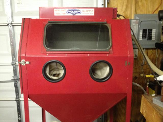

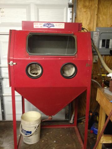

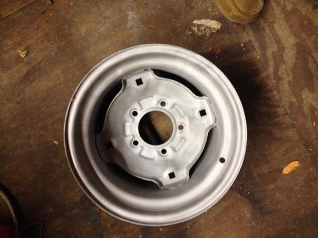

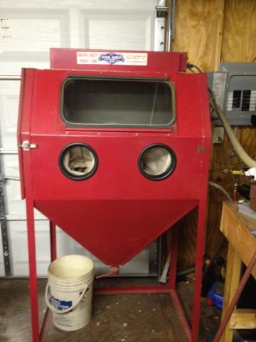

km3h 543 #11 Posted November 23, 2014 I just bought this one on Friday for $125.00 on CraigsList. Don't know what make it is but there is a sticker on it that says it came from Tool Shed. It is 36"x24"x36". Has a florecent light on the top and a home made foot pedal that works great. Took me about 40 minutes to do the rear wheel for my 416-H. I havbe a 5hp, 80 gal tank compressor and it ran continually. I bought a dryer but did not install it yet. A dryer is a must as I saw evidence of moisture while doing the wheel. 4 Share this post Link to post Share on other sites
