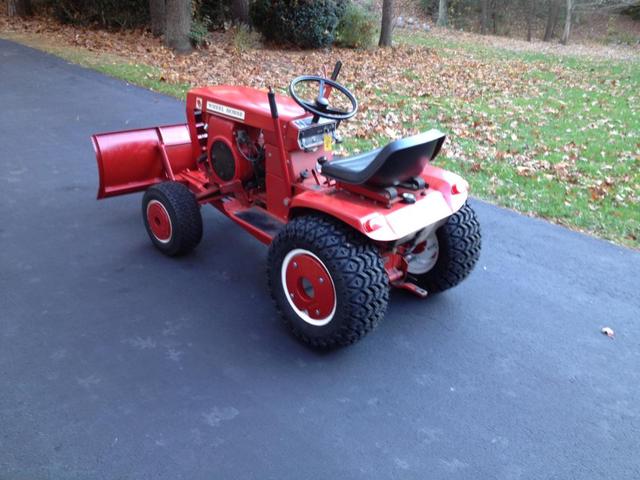

WheelHorse79 271 #4 Posted November 23, 2014 (edited) Last winter I installed a 48" snow blade on my '79 C-101. I spent most of the time fabricating a "lift link" between the lift arm on the tractor and the lift point on the blade, because my plow didn't have one. I started with a small link of chain and some washers/bolts to keep the blade from binding. It worked o.k. but allowed too much side-to-side movement of the blade. I finally fabricated a solid lift link that works well. If your plow has the lift link, then it should just bolt right up. Good luck. Edited November 23, 2014 by WheelHorse79 Share this post Link to post Share on other sites

WheelHorse79 271 #6 Posted November 23, 2014 I removed mine so that it doesn't interfere with the A-frame of the plow when it's raised all the way. It a simple one bolt attachment anyway. Share this post Link to post Share on other sites
Buckshot 1 15 #7 Posted November 24, 2014 I removed mine so that it doesn't interfere with the A-frame of the plow when it's raised all the way. It a simple one bolt attachment anyway. Thank you for your reply. It will be removed. Share this post Link to post Share on other sites
