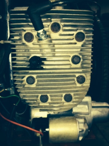

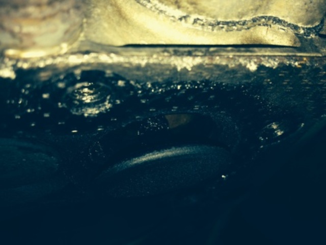

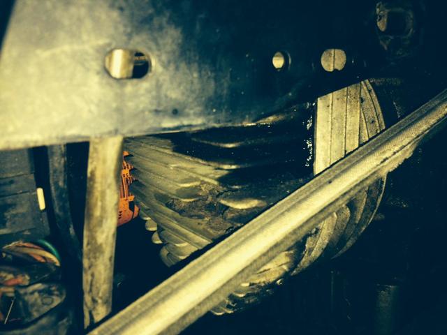

oe espo 32 #10 Posted November 24, 2014 Ok ill look for the connectors. In the meantime I pulled the tins except for the muffler can't get the screws out. Here is a picture of what I suspect is a blown or leaking head gasket. The black area that looks wet. Where I'm baffled is the 90 psi on both cylinders. I hear that is adequate? Share this post Link to post Share on other sites
boovuc 1,090 #11 Posted November 24, 2014 On the Onan, 90 PSI is adequate but don't expect a lot more hours from the engine with 90 PSI on both cylinders. I would crimp in a new 9 pin connector and pull that motor to replace the gaskets and decarbon each cylinder. If you adjusted the valves recently, they should be OK. There are "how to" threads with tips on how to remove the carbon from these engines. Share this post Link to post Share on other sites

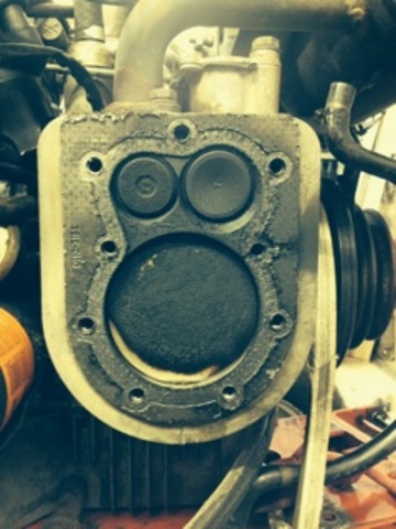

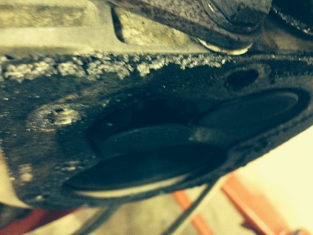

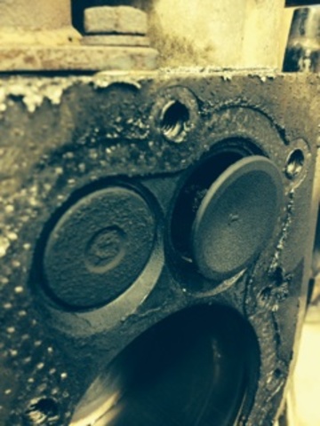

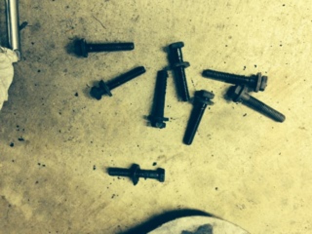

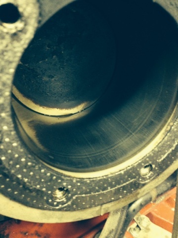

oe espo 32 #15 Posted November 25, 2014 Haven't looked up head bolt torque yet but some were almost finger tight. Standard bore. Seemed like a lot of oil on bottom of cylinder. Intake valve is pretty carboned up on stem. Not sure if this is normal or a concern. What do you guys think of the scoring. Two on each cylinder catch a fingernail Share this post Link to post Share on other sites
km3h 543 #16 Posted November 25, 2014 The carbon is normal and should be cleaned. Scoring is never a good thing but a lot depends on how bad it is. Would cross hatching it and a new set of rings fix it? Share this post Link to post Share on other sites
