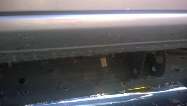

varosd 1,185 #1 Posted November 22, 2014 I was going to use POR-15 on the 48 SD before putting it away for the Winter. I saw this VHT Expoy paint and decided to try it out. went on real nice w/o primer. I wire brushed the grass and rust off and used one can. it was $6 or 7 for a can. I might do another can in the spring and see how it holds up. Share this post Link to post Share on other sites

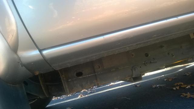

shallowwatersailor 3,222 #5 Posted November 22, 2014 For what it is worth, I used this paint on my truck's frame three years ago. The only prep that I did was to use a hand wire brush and wipe with a cleaner. No primer. It sees a lot more use than a mower deck and I only rinse it when the truck gets washed. For the money, it has held up well. I will probably do it again next spring and take more time with prep. Share this post Link to post Share on other sites
