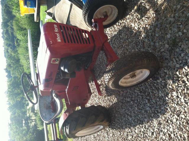

Rad1 8 #1 Posted November 21, 2014 Hi guys! New guy obviously, but I recently started bringing a WH 735 back to life. Needing a fuel pump, so my question is where do you go and what part numbers etc. I've been searching and not having any luck! Kohler Model No. K161(S), spec no. 28626E If I am in the wrong category please advise! I've always had a "thing" for Wheel Horses, just now being able to act! 1 Share this post Link to post Share on other sites

rmaynard 17,563 #6 Posted November 21, 2014 Take the fuel pump apart and see what's bad. A pulse pump (many K161's had them) has only 5 moving parts. A diaphragm, two one-way valve discs, and two springs. It may just need to be cleaned and have the diaphragm replaced. That's a lot cheaper than buying a new one. However, if you do need a new one, NAPA auto parts along with many other vendors sell replacement pumps for under $50.00. 1 Share this post Link to post Share on other sites
