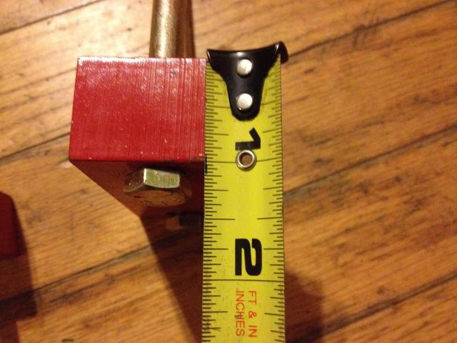

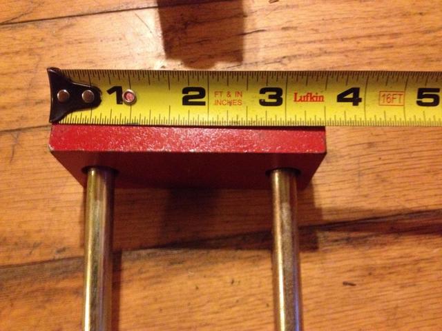

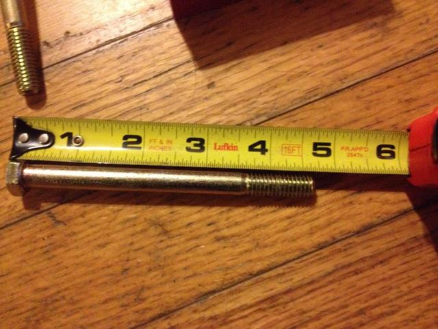

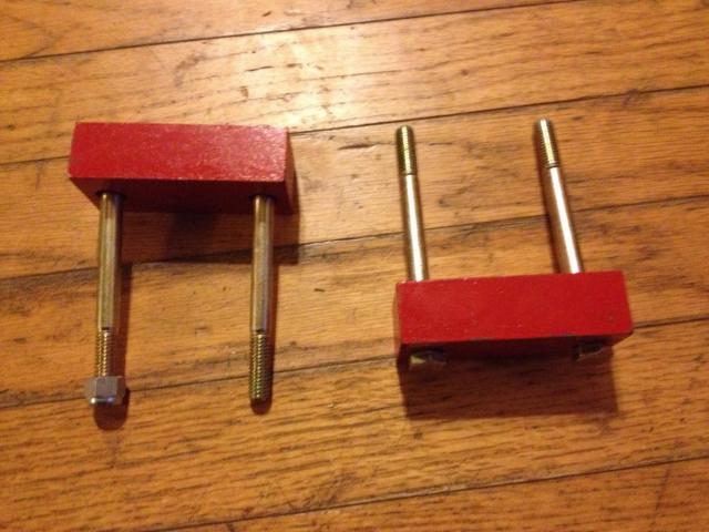

Bert 805 #2 Posted November 21, 2014 When I bought a NOS extension kit it came with two blocks and longer bolts to lower the axle bracket for the 520 8. I'm off for work now but i can get a pic and measurement tonight if you'd like. Share this post Link to post Share on other sites
bmsgaffer 2,071 #3 Posted November 21, 2014 That would be great if you got a chance! Thanks! Share this post Link to post Share on other sites
Bert 805 #4 Posted November 21, 2014 Hope this helps, I forgot to take a pick of the width. They are 1 1/2" wide. Share this post Link to post Share on other sites

bmsgaffer 2,071 #9 Posted November 22, 2014 Yea, what he said. It hits the very low drive pulley on my c-145 8 speed. Thanks for the block measurements! Ive never seen these on any used kit (as im sure the original owners set them aside and forgot about them) I will have to see what I can come up with. 1 Share this post Link to post Share on other sites
Bert 805 #10 Posted November 22, 2014 I bet your right, they were probably set aside most of the time. They should be easy to make if you have a chunk of steel that thick? May be able to stack some thinner pieces to get the right thickness. Good luck and keep us posted. Share this post Link to post Share on other sites
