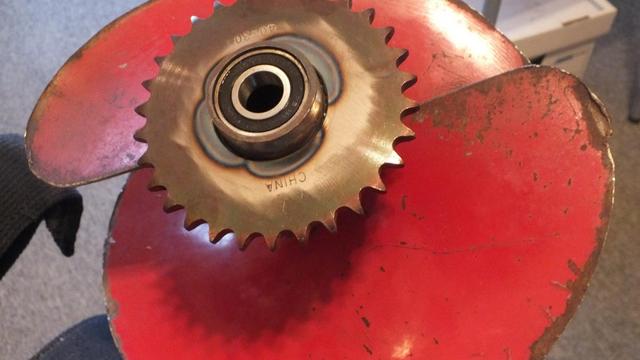

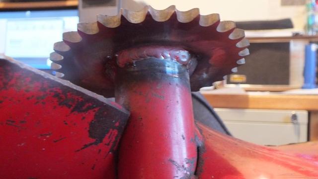

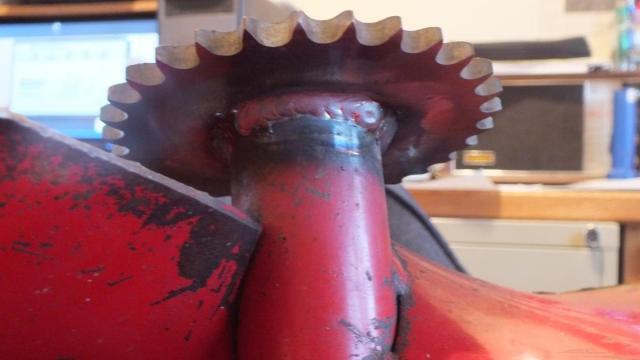

Deer Whisperer 66 #8 Posted December 10, 2014 Thanks for all your help. Got the gear from T.S for 20 bucks and had it welded for 40. Took the bends out of the auger and ready for primer and paint. 2 Share this post Link to post Share on other sites
gwest_ca-(File Mod) 12,511 #9 Posted December 10, 2014 Make sure you replace the chain. It is a worn and stretched chain that wears the sprocket teeth. A #40 chain is 1/2" pitch - that is the distance center to center between the pins and rollers. As the chain wears that pitch increases to lets say 9/16" (it's not actually that much) so now the rollers have to ride higher on the sprocket teeth where they rest at the 9/16" location and that is a weaker part of the sprocket teeth. Garry 2 Share this post Link to post Share on other sites
Deer Whisperer 66 #10 Posted December 11, 2014 YUP,Have a new chain ready to mount and also put in new bearings. The only concern is the sprocket is made in china. Share this post Link to post Share on other sites
