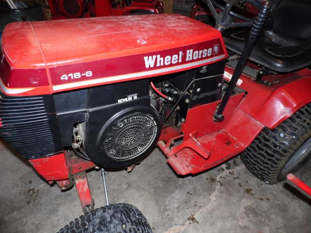

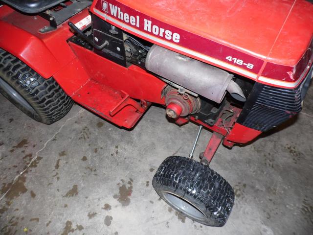

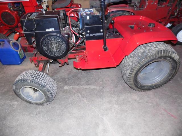

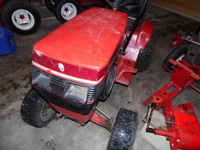

Molon_Labe 731 #1 Posted November 19, 2014 Less than 10 miles from home and I couldn't resist, been wanting one of these with the 16hp Kohler for some time. A little rough around the edges but with a little work everything will clean up just fine. Probably next winter's project. 11 Share this post Link to post Share on other sites

Molon_Labe 731 #4 Posted November 20, 2014 Thanks guys, the poor thing was painted with a brush and has a lot of hardware missing but for the price it couldn't be passed up. This one will be fun. 1 Share this post Link to post Share on other sites

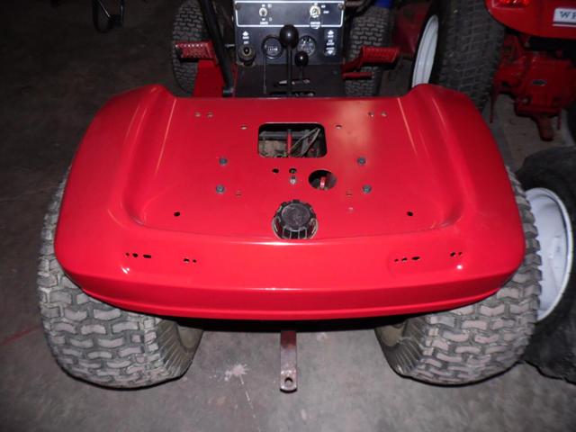

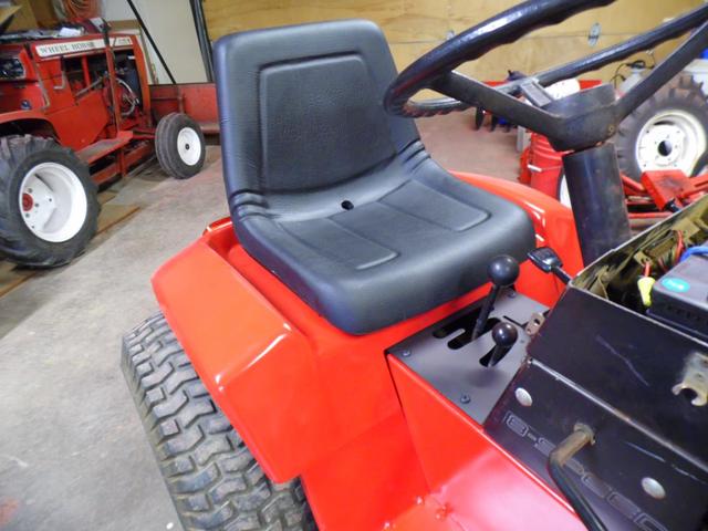

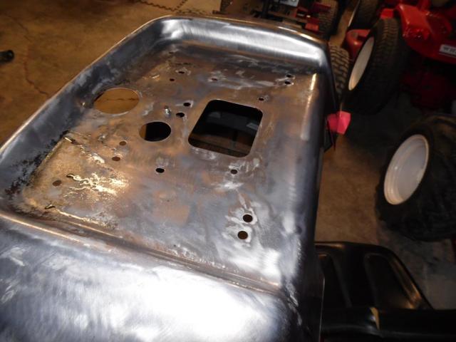

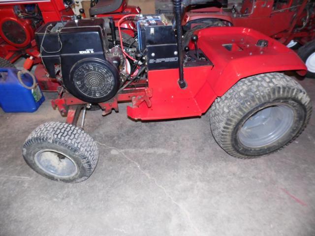

Molon_Labe 731 #11 Posted December 3, 2014 I took a break from the Suburban project to start giving this old girl a much needed face lift, not a restoral. Lots left to do but it's getting there. 3 Share this post Link to post Share on other sites

PaulC 342 #17 Posted December 4, 2014 thanks m bailey guess I could have looked that up myself haha. that makes sense though because all the 416-h's ive seen have had onans. there must be a small window for the 16hp magnums then, they started with the magnums in 86 or 87 so that means only 2-3 years? seems like more of a rare machine u have now m bailey!! by the way your paint looks great!! what did you use to strip the fender pan? 1 Share this post Link to post Share on other sites
Molon_Labe 731 #18 Posted December 4, 2014 Paul the stripper used was Tuff Strip from Lowe's. Followed that up with a wire brush then Jasco Prep & Primer for the rust then a good coat of Dupicolor primer. I noticed a huge difference in the factory paint (when I got down to it) compared to my early model tractors. Is this stuff a powder coat they used on the 300 400 and 500 series? I wonder because of all the moisture ingress and rust where the paint didn't adhere well. This appears commonly on a great number of this series. 1 Share this post Link to post Share on other sites
PaulC 342 #19 Posted December 4, 2014 Thanks for that info when I redid my 312-H I had all the tins sandblasted but ive been thinking if I decide to redo my 312-A or maybe new tractor I don't have yet (glad my wife isn't on the forum ) I would try to use some stripper and do it myself? Them using powder would make sense due to the lack of priming but was powder coat around in the 80's? Never heard of Jasco? I just used rusto primer for the heavily rusted metal and then rusto farm and implement IH red. 2 Share this post Link to post Share on other sites
Molon_Labe 731 #20 Posted December 5, 2014 Jasco is a rust converter/primer also sold at Lowe's. I've used it on several projects with good results. The paint is Ace Hardware Very Fast Drying enamel in Banner Red. Honestly, you can paint with this stuff and 2 hours later assemble the parts, it really dries that fast and that's at 60 degrees! Just painted the right foot rest and belt guard today. 1 Share this post Link to post Share on other sites

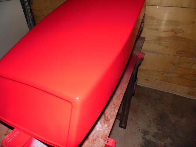

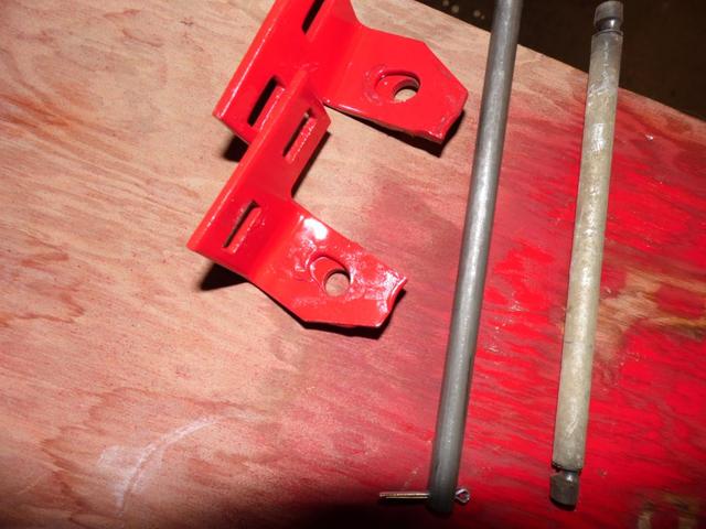

Molon_Labe 731 #25 Posted December 6, 2014 The old horse got a little more attention over the last few days. The hood hinges and rod were completely shot as the following pics illustrate. Had to weld in a couple of 3/8 washers on each side to provide enough support along with a new pivot made from 3/8 rod with a couple of holes drilled for external cotter pins. Also painted the hood (all red at this point) satin black to follow. With any luck this old girl should be back into the working rotation soon. With 1810 hours on the clock, it's no wonder she needs some attention!!! :) 5 Share this post Link to post Share on other sites
