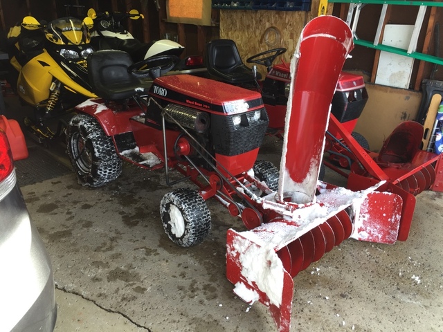

PaulC 341 #1 Posted November 19, 2014 As you have probably saw on the news we have plenty of snow here in buffalo so I had an opportunity to try out a really tall chute I made. Pretty happy with the way it performed. Here is the video proof enjoy!! https://vimeo.com/112324227 https://vimeo.com/112324336 Here is a quick one that shows how I tackled this really deep snow. I did the whole driveway that way yesterday. Took a while but sure beats shoveling!! https://vimeo.com/112324600 10 Share this post Link to post Share on other sites
Lane Ranger 10,530 #2 Posted November 19, 2014 Paul: Looks like you did a great job and prepared for more than you asked for or thought was coming! It is amazing how well this equipment works! 1 Share this post Link to post Share on other sites
AMC RULES 36,957 #3 Posted November 19, 2014 Surprising how well it throws it... without being enclosed...guessing any clogs are history now? 2 Share this post Link to post Share on other sites

PaulC 341 #11 Posted November 19, 2014 You are going to give other 'tall chute' blowers a chute complex... not to mention the short chute! Haha look how pathetic that little short chute looks next to that monster!! I made another version close to the normal height of a tall chute and I'm gonna play around some more and if I like this extra tall enough I will replace the shorty with the medium 2 Share this post Link to post Share on other sites

PaulC 341 #14 Posted November 19, 2014 And Craig without that cover piece in the front I do have some snow shooting straight ahead even when I'm directing it to one side or the other but not enough to really worry about. I may experiment a little with a piece there but I did not have a single clog with it as is. 1 Share this post Link to post Share on other sites

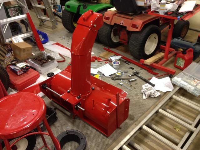

Martin 2,130 #18 Posted November 19, 2014 looks like you did ok with the tall chute fabrication, Paul....... mines getting closer...... I'm back and forth on whether its going to be too high to be effective, seeing yours i can't wait to try mine out...... 3 Share this post Link to post Share on other sites
PaulC 341 #19 Posted November 19, 2014 Martin I really like that!! Looks very close to the factory version it was a good idea picking that Ariens chute up. On both that I made I don't like the top deflector piece as much as those die formed ones. I'm gonna keep an eye out and see if I can find a cheap one like you did. As far as your height I think you will be fine. These single stages fly and really get that snow moving. I actually thought about trying to check the auger rpms with my new laser tachometer lol 2 Share this post Link to post Share on other sites
