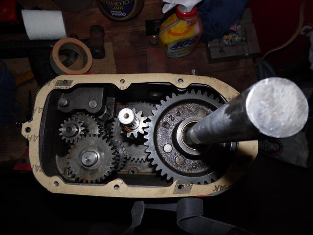

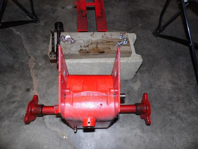

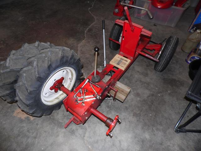

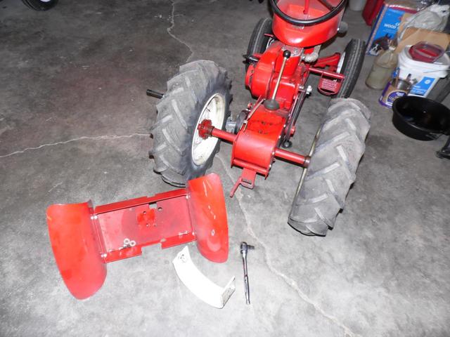

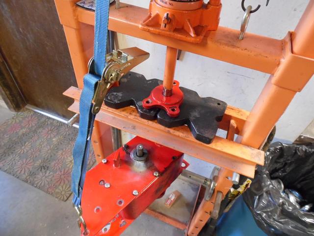

Molon_Labe 731 #1 Posted November 17, 2014 First real snow and now it's time for the winter project, tear down the 400 Suburban!! Here we go! And now for the hub removal...... 12 Ton press and away we go...... More to come. 8 Share this post Link to post Share on other sites

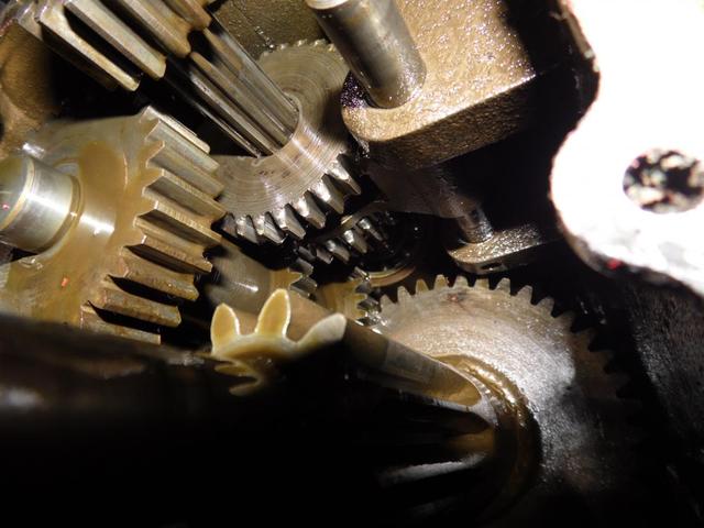

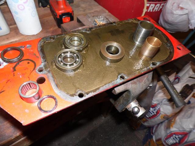

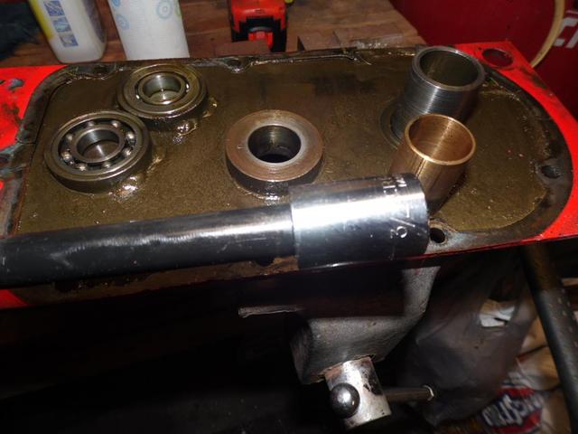

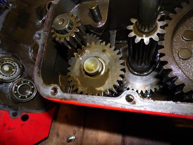

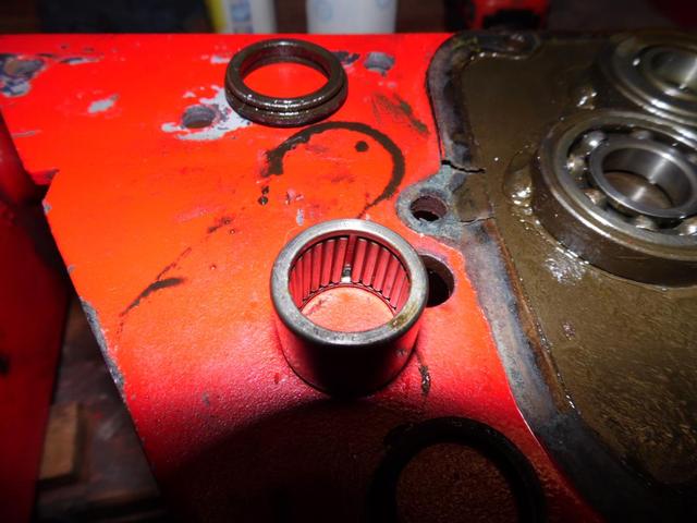

Molon_Labe 731 #10 Posted November 23, 2014 Here's what we have so far with the transmission. The brake shaft was known to be loose and here's why. There is no sign of the missing needle in the case and no metallic shavings. Left side axle bushing and seal removed. And some internal shots. All of the gears look good at this point. Bushing removal tool. 5 Share this post Link to post Share on other sites
Racinbob 12,878 #11 Posted November 23, 2014 (edited) That looks pretty clean to me. Did you flush it first? How does the hi/2nd gear (3523) look? Especially the inside teeth that mesh with the input gear. That gear was pretty well shot in my transmission. Edited November 23, 2014 by Racinbob 1 Share this post Link to post Share on other sites
Molon_Labe 731 #12 Posted November 23, 2014 That looks pretty clean to me. Did you flush it first? How does the hi/2nd gear (3523) look? Especially the inside teeth that mesh with the input gear. That gear was pretty well shot in my transmission. No flush Bob, just pulled the drain bolt a couple of months ago and let it do it's thing. The 3523 gear has some leading edge wear but it doesn't look bad enough to worry about. If folks would just depress the clutch and wait for the tractor to stop before shifting this would not be an issue. Here is the best pic I could get of it. Share this post Link to post Share on other sites

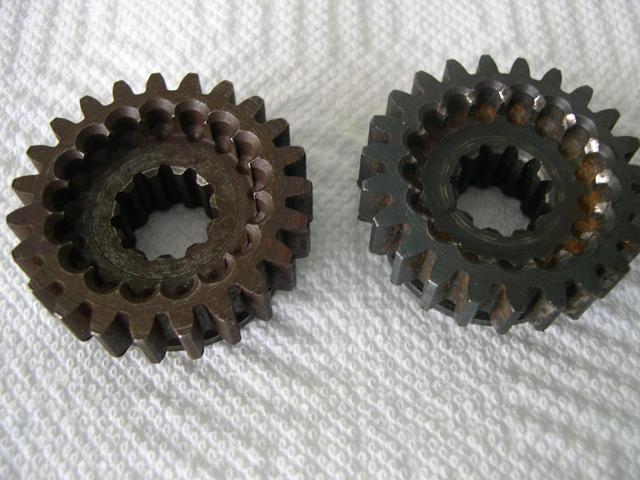

Racinbob 12,878 #15 Posted November 23, 2014 That doesn't look too bad. The main problem could be the inside teeth that can't be seen without pulling the gear out. The input shaft chomps on the those teeth in 3rd gear. In my opinion that where the biggest weak link is in these transmissions. Here's a picture of a NOS gear and one that is worn. You're so right about letting things stop before shifting. I'm so guilty of not doing that but it was 50+ years ago when I would run my Dad's Suburban through the gears just like Daddy did with the car Keep in mind that I'm just expressing my opinion here. The real experts will chime in. 1 Share this post Link to post Share on other sites
Molon_Labe 731 #16 Posted November 23, 2014 That doesn't look too bad. The main problem could be the inside teeth that can't be seen without pulling the gear out. The input shaft chomps on the those teeth in 3rd gear. In my opinion that where the biggest weak link is in these transmissions. Here's a picture of a NOS gear and one that is worn. You're so right about letting things stop before shifting. I'm so guilty of not doing that but it was 50+ years ago when I would run my Dad's Suburban through the gears just like Daddy did with the car Keep in mind that I'm just expressing my opinion here. The real experts will chime in. I'll know more tomorrow Bob when the tear down is complete. I grew up on a Farmall "H" and was told to always stop the tractor before changing gears! 2 Share this post Link to post Share on other sites

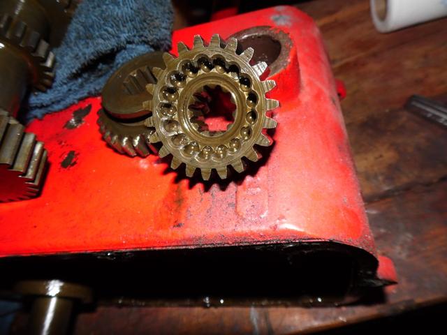

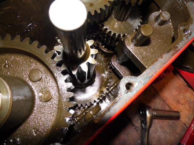

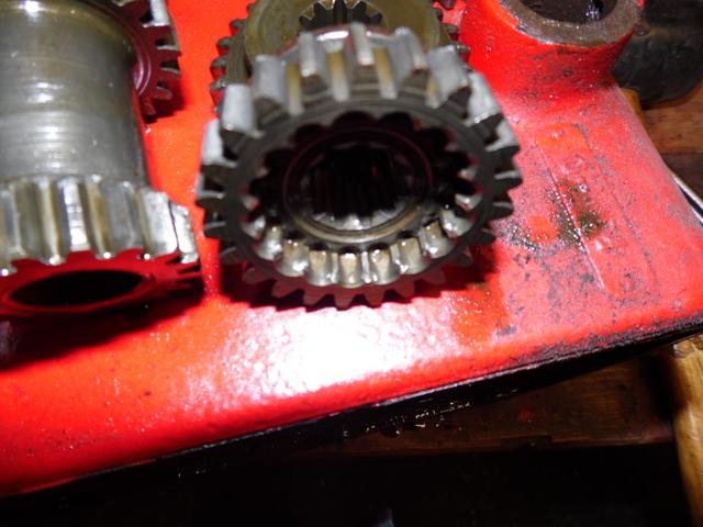

Molon_Labe 731 #17 Posted November 24, 2014 Pulled the left side plate off and removed all the gears. Aside from the axle bushings, seals and brake shaft bearing everything else looks good. Bob here's a pic of the inside of the 2/3 gear. 2 Share this post Link to post Share on other sites
Racinbob 12,878 #18 Posted November 24, 2014 I'm thinking definitely iffy. Hey Stevasaurus!! What do you think? OK for a non-worker? 1 Share this post Link to post Share on other sites
Coadster32 793 #19 Posted November 24, 2014 (edited) That doesn't look too bad. The main problem could be the inside teeth that can't be seen without pulling the gear out. The input shaft chomps on the those teeth in 3rd gear. In my opinion that where the biggest weak link is in these transmissions. Here's a picture of a NOS gear and one that is worn. You're so right about letting things stop before shifting. I'm so guilty of not doing that but it was 50+ years ago when I would run my Dad's Suburban through the gears just like Daddy did with the car Keep in mind that I'm just expressing my opinion here. The real experts will chime in. No expert here, but did a write-up on these trannys a few years back on the old forum, showing and expressing the same thoughts on third gear. The mating input gear gets a little trashed on the end as well. Between this and the ball detent getting whacked out, third gear will slip out under load. Very common in these trannys. Another thing to look out for is the thickness of the shift forks. I had one so worn out, it wouldn't keep the gear engaged. If your's is worn, you'll know it by looking at it. The gear in M_Bailey's tranny could still be good if the mating gear is ok, he gets full throw with the forks, and the ball detent does it's job. The question is did it slip out of gear before? If not, and it won't be a worker, I'd say use it. Edited November 24, 2014 by Coadster32 1 Share this post Link to post Share on other sites
Molon_Labe 731 #20 Posted November 24, 2014 No expert here, but did a write-up on these trannys a few years back on the old forum, showing and expressing the same thoughts on third gear. The mating input gear gets a little trashed on the end as well. Between this and the ball detent getting whacked out, third gear will slip out under load. Very common in these trannys. Another thing to look out for is the thickness of the shift forks. I had one so worn out, it wouldn't keep the gear engaged. If your's is worn, you'll know it by looking at it. The gear in M_Bailey's tranny could still be good if the mating gear is ok, he gets full throw with the forks, and the ball detent does it's job. The question is did it slip out of gear before? If not, and it won't be a worker, I'd say use it. Coadster thanks for chiming in, all help is appreciated. The tranny has never jumped out of any gear and the shift forks look good as does the ball detent. The mating surfaces of the input gear shows little wear and mates up the the 2/3 gear solid. I'll post another pic that may give a better perspective of the 2/3 gear than the post above. Share this post Link to post Share on other sites
Racinbob 12,878 #21 Posted November 24, 2014 (edited) That does offer a better perspective. I believe it would be OK from that shot. If you check out my thread I had an additional problem. I could shift into 3rd and then move the shifter past the detent a little bit. Releasing the shifter would allow it to move back to the detent but then it disengaged the 2/3 gear from the input gear about 3/32". My forks, rails and detent ball were in good shape. Ultimately the fix was to use a properly sized arbor shim behind the input gear. It worked and now I maintain full engagement. I suppose it's possible that the input shaft bearing was too thin or it was driven in too deeply but the shim did the trick. I actually would like to tear it apart again to have another look but it's all together and ready to go so I don't want to go to that extent. From what you're saying you are getting a good engagement and it didn't slip out of 3rd so that won't be an issue for you. Edited November 24, 2014 by Racinbob 1 Share this post Link to post Share on other sites
stevasaurus 23,662 #22 Posted December 5, 2014 I just saw this thread. I think you would be OK with the 2nd/3rd fork gear...pushing snow with a blade in 3rd gear at full throttle is when you may have that issue. Rebuild looks nice. 2 Share this post Link to post Share on other sites

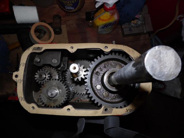

Molon_Labe 731 #24 Posted December 21, 2014 (edited) The transmission is all back together now (whew!!) and everything looks good. The only issue was with the axle bushings which were slightly undersized and required honing (.996 ID) but not a big deal. The axle seals are the same ones taken off which have been soaking in brake fluid for the last month and are now soft and supple, they really grip the axle. Time will tell how well they hold up. A couple of pics - No binding at all and no leaks so far so the next step is to resolve the steering issues followed by paint prep. A special thanks again to Stevasaurus for posting the MI part numbers which was a tremendous help!!! More to come. Edited December 21, 2014 by M_Bailey 5 Share this post Link to post Share on other sites

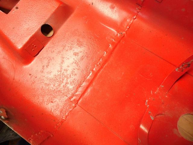

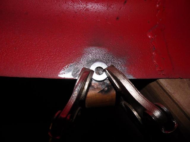

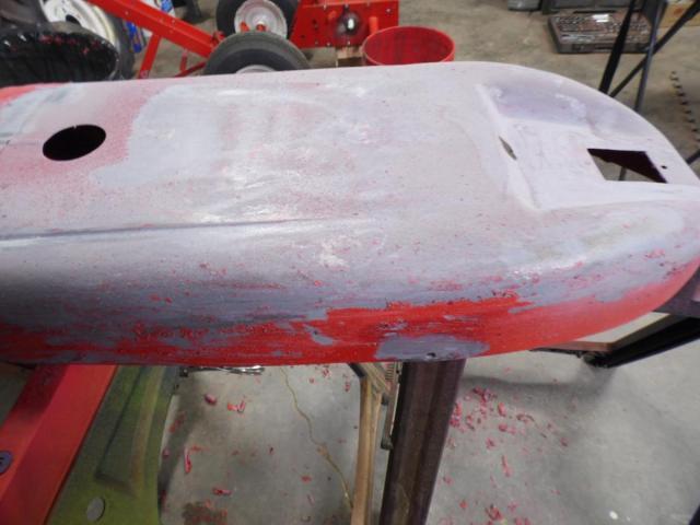

Molon_Labe 731 #25 Posted December 30, 2014 (edited) This is the pits!!!!! Literally! Started stripping the hood and could not believe the pitting and prior filling once I got started on it. There were welds, brazing, lead and Bondo. Not to mention that all of the hood mounts were cracked out. Here are a few shots of it. The hood mounts are all repaired now but the question is what to do about the pitting? I have used 3M Plastic Metal in the past with good results but not on an area this large. Also note that it appears that two hoods were cut and joined in the middle to form one via the weld and re-form below!!!! I'm having more fun than a hog in mud........ Edited December 31, 2014 by M_Bailey 2 Share this post Link to post Share on other sites
