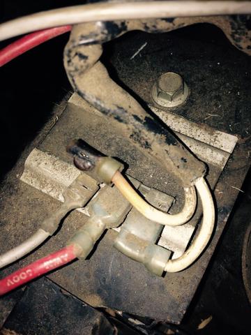

dstriker 2 #12 Posted November 17, 2014 (edited) i checked the volts and got nothing given i checked it right i believe i did there is power to the coil and power to the starter when we tried checking the power to the coil with just a probe light and had the key turned over there was a humming noice not sure where it was coming from sounded like under the battery also when this happened one of the lights came on on the dash i had two guys helping and they were stumped as to why there is power everywhere but no spark and why we cant get anything from the key. i also talked to a dealer that told me it sounded like a safety switch of some sort but said that shouldnt cause no spark but wouldnt say much else trying to get me to bring it in. i also noticed on the top of the motor towards the battery there is a wire that is burnt it plugs into a plate on the motor along with a few other wires not positive what its to Edited November 17, 2014 by dstriker Share this post Link to post Share on other sites
Theroundhousernr 590 #13 Posted November 17, 2014 The plate is the rectifier if I am understanding you correctly. And whatever dealer told you safety switches should have nothing to do with spark...... well Share this post Link to post Share on other sites

dstriker 2 #21 Posted November 17, 2014 here is the pic of burnt wire Share this post Link to post Share on other sites
N3PUY 1,031 #22 Posted November 17, 2014 From the looks of the wire it is a poor connection. Replace that wire terminal. BUT that shouldn't have anything to do with starting. Share this post Link to post Share on other sites
