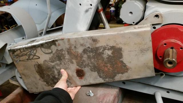

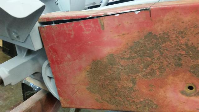

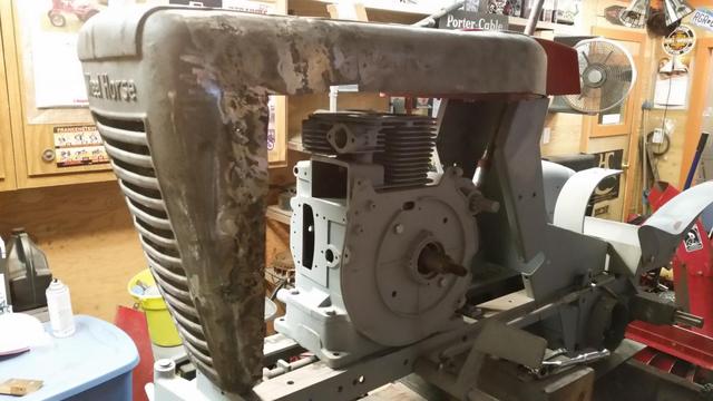

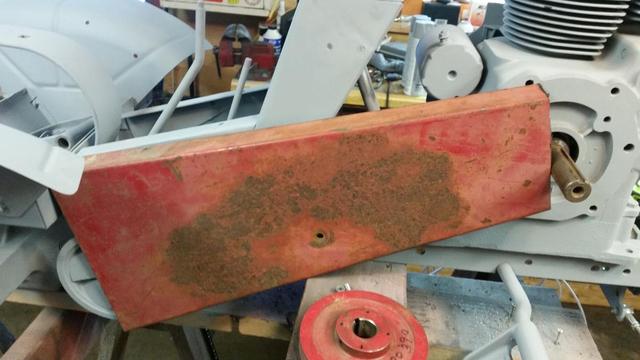

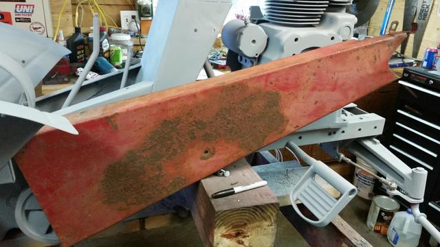

prondzy 3,889 #28 Posted January 25, 2015 WOW! things have been crazy busy around here, made a little time in the shop this week, and some quality time with the welder today. I took a 1257 belt guard which was way too long! I shortened it by a couple inches to fit between the toolbox and the motor (no I didn't leave it this long either wouldn't want to rub on the crankshaft) made a few cuts to match the profile of the hood stand I added tabs and welded everything back together filling a few holes so I can drill my own later. And as mentioned in the previous post the hood still managed to be short, so I had to cut and add another 1 3/4" section to the length here it is mocked up I need to make little patches for the sides of the hood. other than some welding on the hood I think this is the last of the BIG modifications, hope you like it!! 1 Share this post Link to post Share on other sites

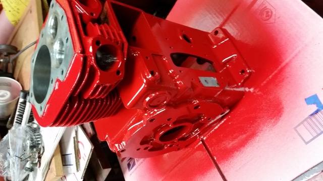

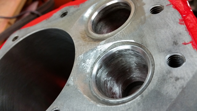

prondzy 3,889 #32 Posted April 22, 2015 Been busy lately trying to finish up school. I got the block off to the machine shop. Painted the engine tins. I just got the Block back .030" kohler piston. Ported the intake and exhaust decked the block and received my torque regrind cam in the mail. So here's a couple pics of the Block all painted up. I will build this engine this weekend. 2 Share this post Link to post Share on other sites
Terry M-(Moderator) 2,296 #34 Posted April 30, 2015 I agree..Looks good Mike Share this post Link to post Share on other sites
