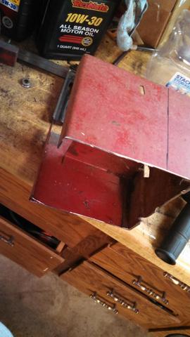

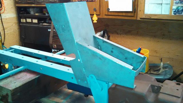

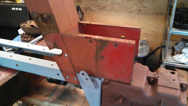

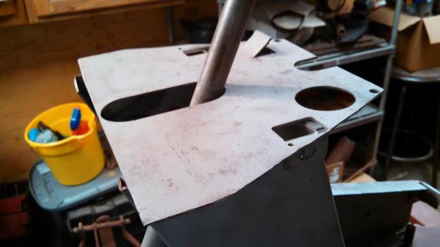

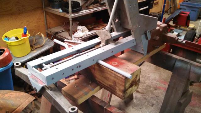

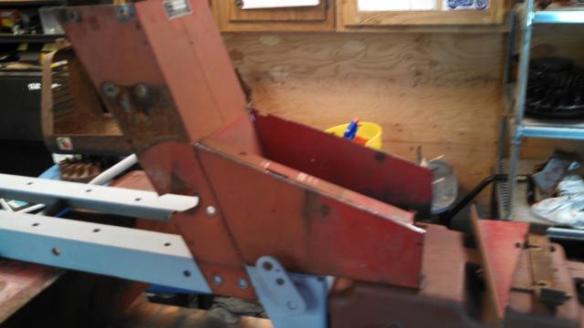

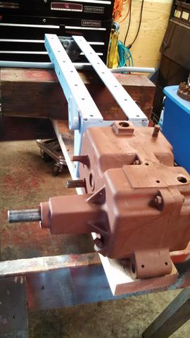

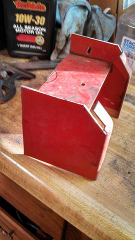

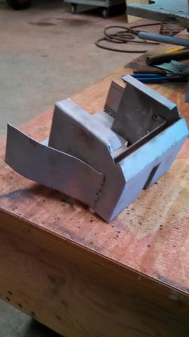

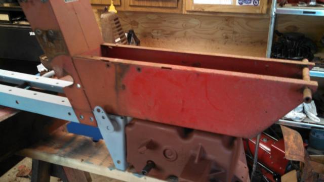

prondzy 3,891 #1 Posted November 17, 2014 Well, I finally got started on my project tractor (I have a name picked out but for now we'll just call it CLASSIFIED). I started with a L-155 lawn ranger frame and an 8 speed rear end. The transaxle was split, cleaned, I replaced one outer axle bearing and have new seals that will get installed before final assembly. Because this tractor is being fabricated with parts I had laying around, I thought It best to blast and prime parts before assembly, to keep things clean, then I will tear down, paint and reassemble. So here it is the start: I then took a hood stand/tunnel from a 1257 and decided to modify it so I can install a toolbox , Here is where the cutting begins of course I needed to shorten it Then to make the profile meet the toolbox Then I took the triangle pieces I cut off of the tunnel and welded them into the inside so I can achieve a factory look. and added the tab across the back of the tower so I can tie the tool box to the tower . of course I modified a stock gas tank dash to mount on top of the tower but I forgot to take pictures of that process so I will just take pics of It mounted when I am update my post. I have done some blasting of other parts to get things ready for the next stage, I will be working on the steering setup, I need to shorten a long frame fan gear to fit this short frame. along with moving the steering block back a couple inches. as you can see in the pictures I have moved the tower back further than the stock location, this of course will be to shoe-horn in a 14hp kohler that I will rebuild. I will be using a c- series axle, but I am on the hunt for a swept axle, unfortunately all are expensive, and I am wanting one cheap. 11 Share this post Link to post Share on other sites

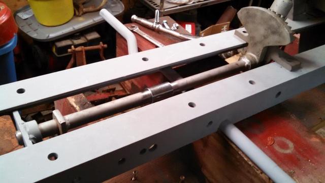

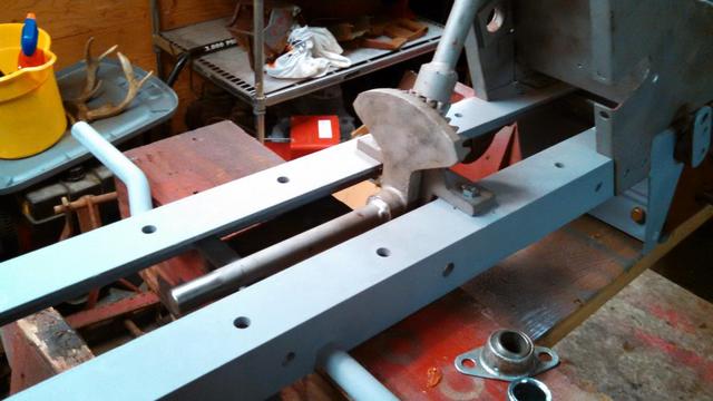

prondzy 3,891 #9 Posted November 22, 2014 (edited) Well I managed to get a few hours in the garage this morning, have plans this afternoon so I thought I share what I have done this morning. Here is the start to mocking up the steering, I had to shorten the lower shaft because it came from a long frame. I measured the frame and used this steel collar to re-join the shaft I wont weld it until I have tie rods to make sure the upper and lower fans are lined up. Another shot Here is a shot of he modified gas tank stand. it started as a c1-60 dash complete with steering shaft. This is a rough cut, I still need to make final dimensions, but it gives you an idea. I started to plan the brake rod and have a pretty good idea of how I want to make it. Getting excited maybe ill get a chance to make the brake rod tomorrow. Edited November 22, 2014 by prondzy Share this post Link to post Share on other sites

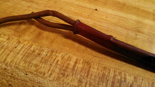

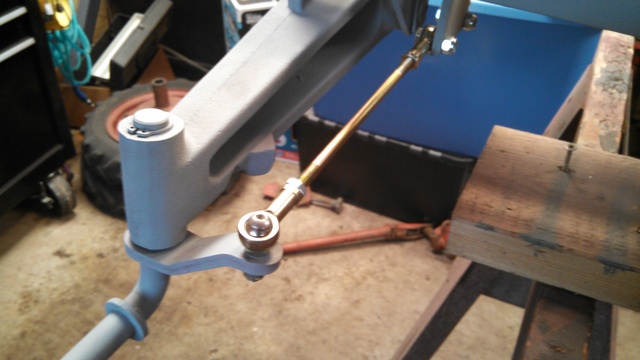

prondzy 3,891 #14 Posted November 29, 2014 Update I haven't had much time in the garage this week. But I did get my tierods in the mail so I had to try them out they are go cart tierods 2 Share this post Link to post Share on other sites

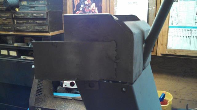

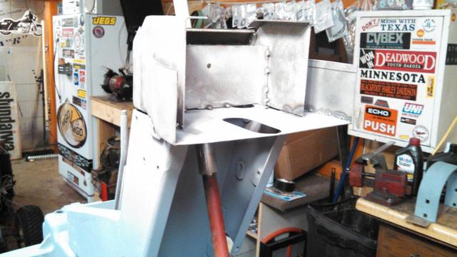

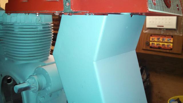

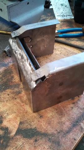

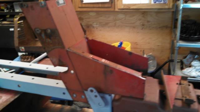

prondzy 3,891 #15 Posted December 4, 2014 Got a little more fabrication time in the shop today, so I thought I'd tackle making the hood stand taller so I can clear the engine ( I mocked it up earlier and have some dimensions figured out. Because I am doing this build with parts laying around I am trying to use every available part so I don't waste or have to spend money (saving for the engine rebuild, going to be a fun one!) I decided to use the tail section of the tunnel that I cut off earlier because it was roughly the same dimensions as the top of the tower. I cut off about 5 inches figuring this would give me enough height After checking hood fitment I realized I needed to 45 these corners so I could make the hood sit right I added a thicker backplate because I have some ideas for a collar to support the steering shaft but I haven't decided anything yet so this gives me options I welded this to the gas tank support I cut up earlier in this post, and took some thin sheet metal and made some tins to follow the profile of the tank support, it kind of looks like a smaller gas tank from the side profile Here it is sitting on top of the tower I need to make something to cover or fill the gap between the tower and the new extension hopefully something will come to mind so it looks like it could have come from the factory. well I'm not a metal fabricator, things could have been done cleaner, but it was fun, needs a little bondo and some grinding to clean it up. hope you enjoy it! 1 Share this post Link to post Share on other sites

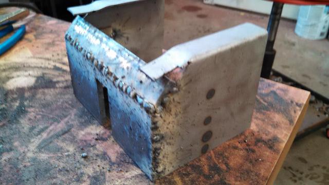

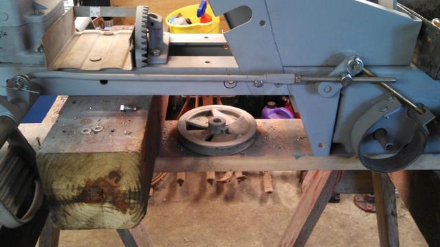

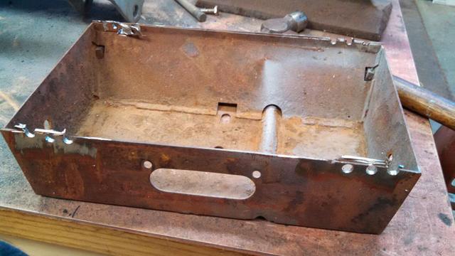

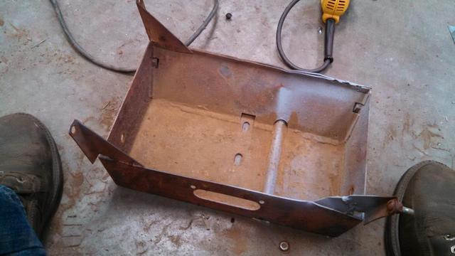

prondzy 3,891 #17 Posted December 8, 2014 Well I got the brake system mocked up today pretty happy with the way it turned out. you can kinda see how much I need to put in this short frame and why I moved the tower as far back as I could. I also decided to start working on the toolbox as it needed a little attention. I thought about trying to fix the ones that were there in bad shape and recreate the missing one, but to get them to match would be difficult and the opportunity to make them stronger with four new ones sounded nice. I drilled out the spot welds to remove the old supports and have filled them back in. The box was in rough shape after I threw it in the media blaster. the prototype supports were made out of 1/8" X 1 1/4 angle, it is a little narrower than the factory ones might try to make them out of larger angle iron. 1 Share this post Link to post Share on other sites

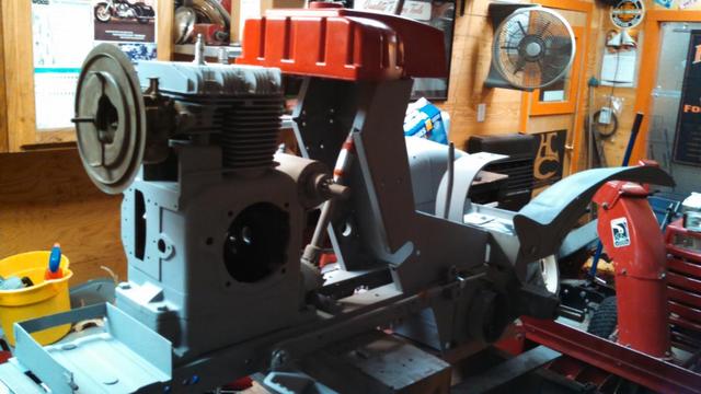

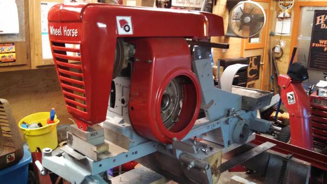

prondzy 3,891 #18 Posted December 15, 2014 I changed plans, the original plan was to use a ranger L-155 style hood but looking at the amount of modification needed will be above my skill level to make it look "factory". I grabbed a tank from another project and the hood from my 62 lawn ranger just to test fit and this is what i came up with, I like it a lot! and the 14hp is too big to fit the carb under the hood so to make this problem work i moved the engine back and i put the battery in front of the engine. this solves fitting the carb and air cleaner issue. I have hood pieces laying around and i will be making the grill taller and the hood longer to make sure i meet the frame like factory and i need to make an extension for the tower so the tank sits at the correct level. Took a small break on the heavy modification and worked on a few "small" things, checked the brushes in the starter, re-wired the stator the old wires were in terrible shape I cleaned the windings with electric motor cleaner and soldered on new wires to the stator, I used 10g wire ( i know overkill) but hey I'm building this tractor to be "super" right? and then i wrapped the two wires in 5/16" shrink wrap to hold the together and added new spade terminals (sorry no pics of that) 6 Share this post Link to post Share on other sites

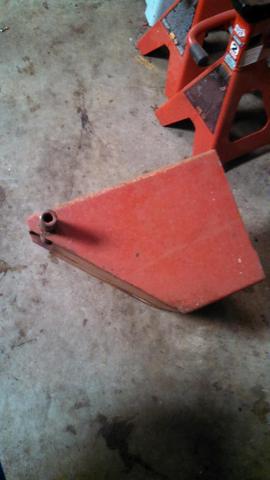

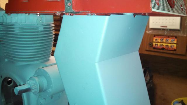

prondzy 3,891 #20 Posted December 21, 2014 Made some progress in the shop today After some careful thinking this week I found the perfect solution for my tower extension, I took another hood stand that was busted up and used the top 3 1/4". I flipped it upside down so it would match up my tower and this way the tower comes back to the driver so the engine doesn't loose space (cant afford that!). I now need to drill holes for the gas tank mounting tabs. Here is an overall shot of the tractor so far. I got the fenders cleaned up today also. welded some cracks, did some straightening, and had to remove the word COW somebody welded on the fender (kind of wished I took a pic before removing). Next week looks busy, might not make it into the shop, but we'll see! ENJOY! 3 Share this post Link to post Share on other sites

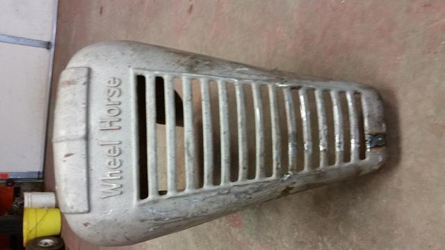

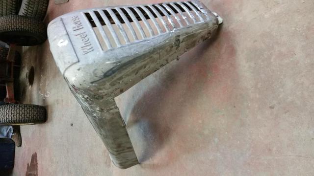

prondzy 3,891 #23 Posted January 5, 2015 Worked on the hood today stretched the hood 3 1/4" and stretched the grill by 5" to clear the 14hp kohler. Took some time to get it to fit the grill bars together, and it never seems to fail when you try to weld a pinhole shut it burns open to the size of a dime, got a little frustrated chasing holes so I called it quits for now. I have been wondering if anyone has used epoxy to fill these holes? ( this old rusty sheet metal is thin and burns out.) Hope you like it! and a pic of the grill Share this post Link to post Share on other sites
