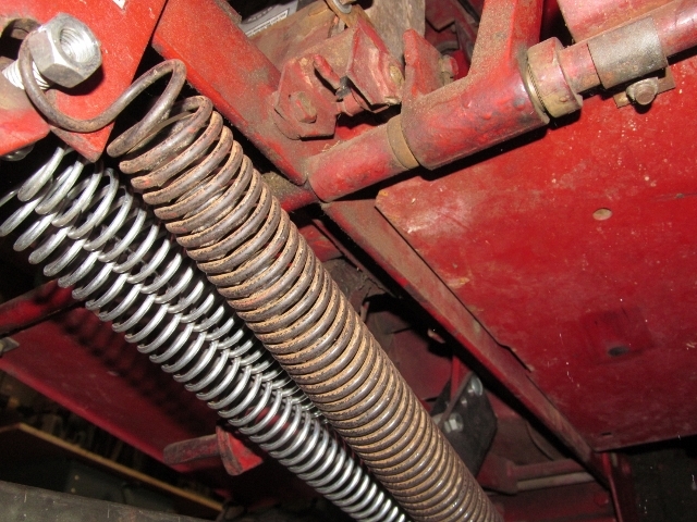

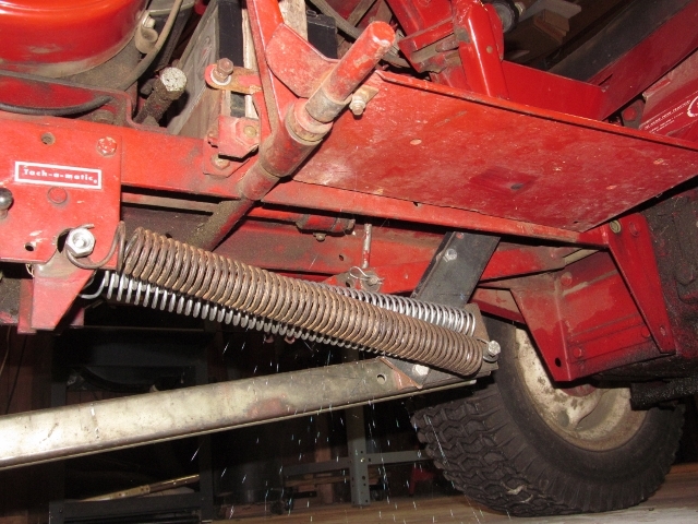

Ed Kennell 47,034 #2 Posted November 16, 2014 I used 3 springs on mine. This was before I got the 520H with hydro lift. 1 Share this post Link to post Share on other sites
skrusins 128 #3 Posted November 17, 2014 The spring part no.4629 is much thicker and shorter than the one in the picture. I'm using the factory one and does seem to give me ay problems also the book shows to mount the spring on the bar that is attached to brake and clutch pedal. Share this post Link to post Share on other sites
grinchsr 674 #4 Posted November 17, 2014 I am using the same mounting round bar you are talking about but it still pops off. I don't want to heat it up and reshape the end of the spring because that will weaken the spring. Share this post Link to post Share on other sites
Ed Kennell 47,034 #5 Posted November 17, 2014 The springs in the picture were made from old garage door springs and were attached to a rod in the mid attach-a-matic. They actually had enough lift to carry the blower about 2" off the ground. When the blower made contact with the snow, the weight of the snow would lower the blower. The springs could be adjusted to have -15 to +15 lbs. force on the lift lever. Gotta do what's required to git-er-done. 1 Share this post Link to post Share on other sites
