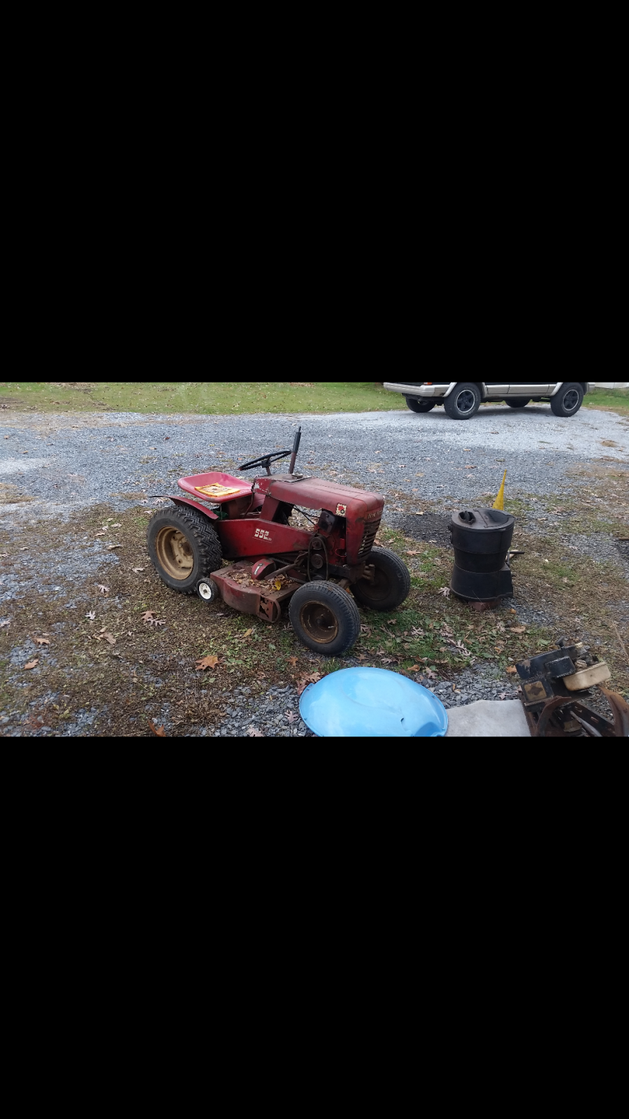

jwiss1995 17 #1 Posted November 15, 2014 Can anybody tell me what a 552 came with from factory? Share this post Link to post Share on other sites
AMC RULES 37,259 #2 Posted November 15, 2014 (edited) 552 1962 Lawn & Garden Tractor 552 4-Speed Tecumseh HT55C-3089 5.5 Wheel Horse 5025 Edited November 15, 2014 by AMC RULES Share this post Link to post Share on other sites
jwiss1995 17 #3 Posted November 15, 2014 What would be a good kohler to put in its place? Share this post Link to post Share on other sites
AMC RULES 37,259 #4 Posted November 15, 2014 Kohler 6HP K-161 8HP K-181 Share this post Link to post Share on other sites
jwiss1995 17 #5 Posted November 15, 2014 Ok cool, I have one of each sitting around, I'll see if I can get it driving today 1 Share this post Link to post Share on other sites
jwiss1995 17 #7 Posted November 15, 2014 Had a k141 laying round, put it on and she lit right off! I was out mowing alittle grass with it too 1 Share this post Link to post Share on other sites
AMC RULES 37,259 #8 Posted November 15, 2014 Looks like a good fit too. Share this post Link to post Share on other sites
slammer302 2,157 #9 Posted November 15, 2014 That's a sweet looking machine hope you get as much fun out of it as I do with mine 1 Share this post Link to post Share on other sites
jwiss1995 17 #10 Posted November 15, 2014 I really like this one and don't plan on getting rid of it anytime soon. Future plans include mild restore and fixing up the deck some Share this post Link to post Share on other sites
stevasaurus 23,856 #11 Posted November 16, 2014 It looks great and I would not change a thing, but the K161 is a 7 hsp Kohler and would make your horse a 702...which would be correct for the year...if you care about that kind of stuff. This is like wine...if you like it...it is good. 1 Share this post Link to post Share on other sites
jwiss1995 17 #12 Posted November 16, 2014 I'll just keep the k141 on it that I have. Seems to run great and plenty of power for this little guy Share this post Link to post Share on other sites
slammer302 2,157 #13 Posted November 16, 2014 You can still get the needle bearings and seals for that deck I just got mine today 28$ Share this post Link to post Share on other sites
jwiss1995 17 #14 Posted November 16, 2014 Oh nice! The only thing my deck really needs is rust repair Share this post Link to post Share on other sites
