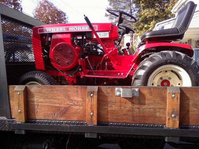

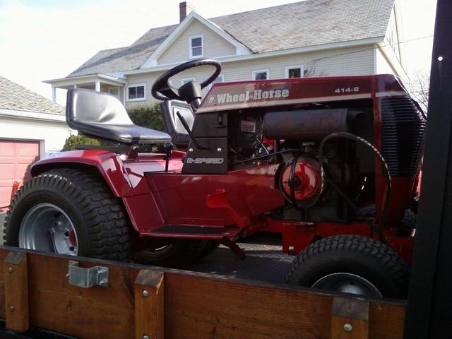

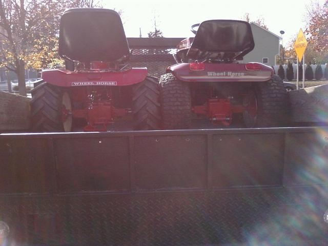

mrc 1,122 #1 Posted November 12, 2014 here is a C120 i got for my great grandson. he is only 4 years old now. hopefully they won't outlaw gasoline before he can ride it. just did a tranny swap because some PO welded the hubs to the axles. how would you change an axle seal with that setup? also in the pics is my 414-8 going to their winter storage home. (a friend's garage). hope you guys like the pics. mike in mass. 9 Share this post Link to post Share on other sites
