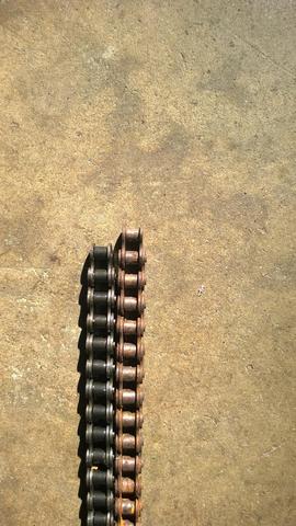

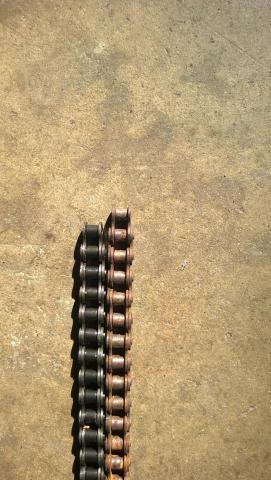

mbarb54 8 #1 Posted November 10, 2014 (edited) I have a 42" single stage snow thrower (Model 06-42ST04) attached to my 310-8. I posted a few days ago about a problem with the auger not turning when I engaged the PTO clutch. After removing the chain cover I was able to get a better look at the chain. The chain is stiff and links are locked up and it has no play. My guess is the chain is all rusted and/or gummed up inside even though there is no apparent rust on the surface. A couple questions. (1) is the chain shot or can I remove it and soak some life back into it to reuse? (2) I found the master link to remove the chain, but it looks tricky getting the chain put back on and rerouted. Any tips for getting the chain back on? (3) I see Partstree sells a new one for $95.35. Anyone know of cheaper alternatives? Help is much appreciated. Thanks, Michael Edited November 11, 2014 by mbarb54 Share this post Link to post Share on other sites
RMCIII 840 #2 Posted November 10, 2014 Chain may be ok to use, if you can get it off. Then just soak it in a bath of penetrating oil for about 2 days..... You may have to work the links a little to help the penetrating oil get into the links. If you are able to do so, the chain should be ok to use. But I would personally still get an extra one as a back-up. As for a place to get another 1.... TSC has the stock 40 link. just take that one and they will cut to link. You also may find something at Sohars if you have the part number. Chain is no difficutl at all to take off or replace. Rob 1 Share this post Link to post Share on other sites
Ed Kennell 47,611 #3 Posted November 11, 2014 Chain may be ok to use, if you can get it off. Then just soak it in a bath of penetrating oil for about 2 days..... You may have to work the links a little to help the penetrating oil get into the links. If you are able to do so, the chain should be ok to use. But I would personally still get an extra one as a back-up. As for a place to get another 1.... TSC has the stock 40 link. just take that one and they will cut to link. You also may find something at Sohars if you have the part number. Chain is no difficutl at all to take off or replace. Rob Glad you found the problem Michael. The chain is an easy fix...compared to new bearings or a bent auger. You probably know this, but I find it helps to loosen the one chain tension sprocket when removing or installing the chain. Looks like the SQUONK made scents again. Share this post Link to post Share on other sites
cheesegrader 436 #4 Posted November 11, 2014 I don't know if they are as common in the south part of the state, but Fleet+Farm is the cheapest place for those kind of parts up north #40 roller chain, the box I got was enough for two chains, about $20. Share this post Link to post Share on other sites
mbarb54 8 #5 Posted November 11, 2014 Thanks all for the input. I've since pulled the chain off and am soaking it in penetrating oil. The chain looks pretty bad, so I'm going to get another regardless of whether the old one comes back to life. Also found some other places on Internet that sell the new replacement chain as low as $80.00. I think I'll try either Fleet Farm or Tractor Supply as advised. Lesson learned on not taking proper care of the chain! Now, if the snow will just hold off for a while yet. Share this post Link to post Share on other sites

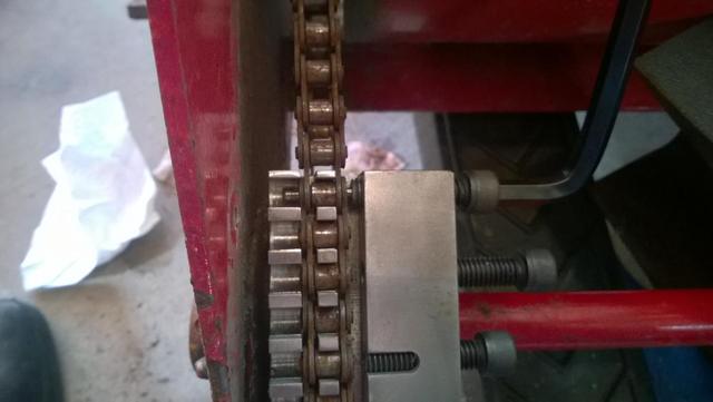

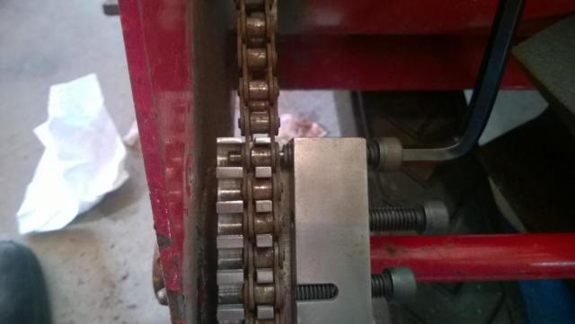

shallowwatersailor 3,222 #9 Posted November 11, 2014 I bought a 42" snowthrower this summer. Planning ahead I bought #40 chain at TSC and a new idler sprocket. The adjustment was fully used so I knew that there was a problem. I use a chain buster so I don't use the master Link. Turned out that the chain was stiff like yours plus streched almost a full link. The idler sprocket was gritty also. The outboard input shaft bearing is on the way out so I am going to replace that as well. Somehow the flanges were assemble wrong putting one on each side of the housing and didn't contain the bearing. 1 Share this post Link to post Share on other sites

shallowwatersailor 3,222 #12 Posted November 11, 2014 On mine, I counted 34 links. I made the new chain the same number of links although that may not be right after I change the bearing and install the flanges correctly. The adjustment had been at its limit. With the chain breaker I can adjust it very easily. I am not so sure that I agree with the comment to make the new chain the same length as the old one. I am a cyclist and I ride close to 10,000 miles each year. This means I install new chains 3 times a year and I always count the links and make the new one the same number of links. Chains stretch and (on a bicycle at least), you need an odd number of links to get the master link to work. Bicycles have derailleurs which account for some of the chain stretch but if you make the new chain too short, the bike will not shift properly. Fortunately, blowers only have to spin, but the chain adjustment is limited. Also, if the chain (on your bicycle or blower) is stretched too much, you will wear out the auger and cogs. For a bicycle, the stretch limit is 1 percent. How do you know if you have worn out the cogs? Put on the new chain and under load it will jump teeth. How do I know this? Not replacing soon enough resulted in me replacing a $300 cog set AND a $60 chain. And you think tractor parts are expensive??? Don, in my bicycling days I used to put the chain in a pot with oil on the stove. The thought was warm oil would saturate better. What are you using to lubricate your chains? Share this post Link to post Share on other sites
Forest Road 595 #13 Posted November 11, 2014 I'm with Doc. Wish I had his time to ride. Also consider replacing the cogs on your blower. Given that the chain was rusted I would assume the bearings are in rough shape too. The teeth should have a defind shape to them. If they are starting to get pointed with sharp peaks then they're shot. On a typical blower you'll probably need to replace this stuff every 3-5 years. Don't do it and regret it at the worst possible time. Good luck Kevin Share this post Link to post Share on other sites

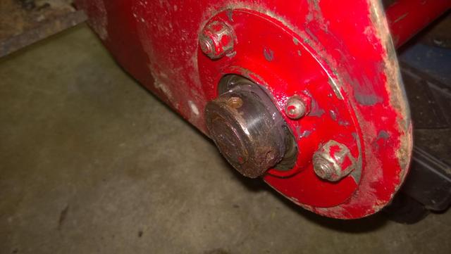

mbarb54 8 #14 Posted November 11, 2014 Pardon all my ignorance. This is my first adventure into snow thrower repair. There have been suggestions of checking and/or replacing the bearings. Is the recommendation all bearings or select ones. I see 4 different bearings on the parts manual I have for my model. Two are one either end of the auger and 2 are at either end of the drive shaft. I would assume the lower bearings would be more vulnerable due to their location. And on chain length, I assume if I bought OEM part, it would be the proper length? I found a cheap one. Michael Share this post Link to post Share on other sites
can whlvr 994 #15 Posted November 16, 2014 its a bit of challenge to do all the bearings,but well worth it,im doing my original thrower now,did it 4 years ago and it needed auger bearings after I left it out this year,they wre a bit gritty and as already stated it will break at the worst time Share this post Link to post Share on other sites
mbarb54 8 #16 Posted November 16, 2014 (edited) Conclusion. Found an OEM chain on ebay for $36 bucks. Was proper length and is now installed and working well. Would have gotten one at Farm Fleet for $12 but I didn't have a chain cutter and theirs cost $26. Was easier to order off ebay and have it shipped direct to home. The old chain did not come back to life after soaking in penetrating oil for 4 days. Throwing it away. As for bearings, keeping my fingers crossed I'll get through the winter. They seem to be ok right now. That'll be my project for next summer. Edited November 16, 2014 by mbarb54 1 Share this post Link to post Share on other sites
