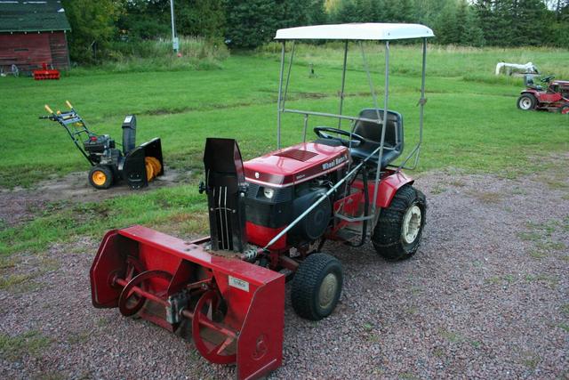

snowmoboyle 33 #1 Posted November 8, 2014 Hi guys - Been a lifelong rider/operator of Toro/Wheelhorse rigs. When I was 6 my neighbor purchased a 312 classic that years later, when I was 13 pursuaded my dad to also buy a 312 Classic with the singlestage blower as well. This rig helped me through the yard work, 5 mowing jobs, and our own property during my high school years and dad retired it a couple of years ago and sold it, 16xx hours and no rebuild, no smoking either on that big old 12hp kohler. It had seen better days, but was still working! Dad had picked up a deal on a 520H 1997 model I believe to replace it.. That then became my dream rig... nothing better then a twin sound.... Flash forward a few years, I have moved north more (northern Wi) and need something to keep up the yard as before a push mower covered the duty. In a small world, luck would have it I come across the actual 312 classic that my neighbor had purchased in 1985. He had long passed, but his son was still using it as a woods mower. Price was fair, and dad tore into it as a project. Alot of parts went into it, but I wasn't worried as it was going to be something I'd have for a long time. I get it up here, use it two weeks, and find a 520H with a two stage blower, and cab, for $450 that I can't pass up. What a wild ride - but here I am with winter storm watch coming for Monday and I have some work to finish before I'm ready to work this thing! (Side note, I've had it for a couple of months so I should've done the work a long time ago lol) The clutch idler pulley is completely worn - actually working down on the bolt that holds it in place. Also needs a cooling fan. Is replacing either of these a big deal? I see taking the wheel off will get me easy acess to the fan, but do I have to take some panels off to replace the idler pulley? Anything difficult or tricks I'll need to know? Bought from the 2nd owner, who inherited it from the original owner. The original owner purchased it new, and only used it for blowing. Has a front push blade that must've been used a couple of times. Fluid filled tires even! almost 900 hours I believe. I'm interested to see how it blows the snow!! Share this post Link to post Share on other sites
