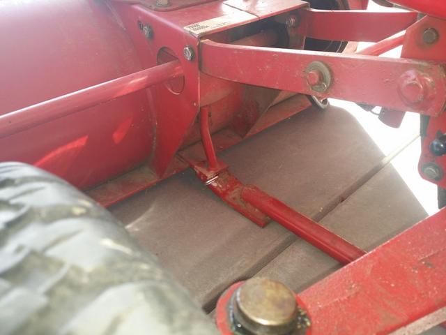

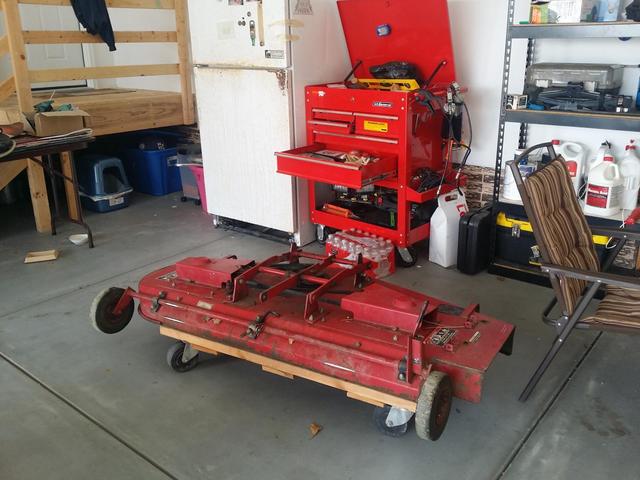

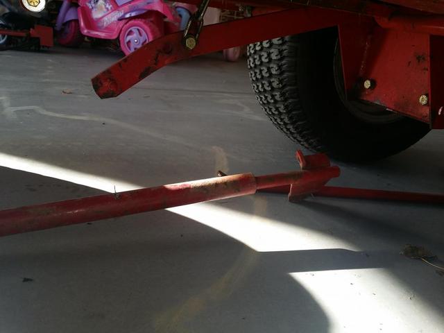

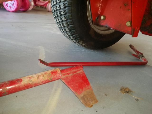

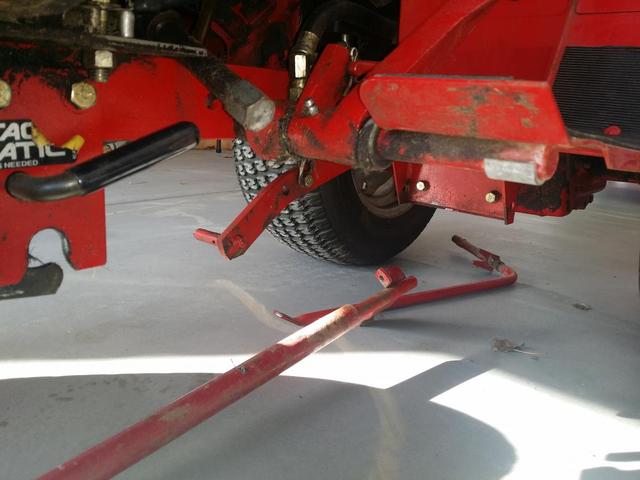

gabe911 23 #1 Posted November 8, 2014 Hey Guys..been a while..love the new look of the site! Tried doing some searches on this topic, however it always came back with no results which i thought was strange! Anyway can someone PLEASE give me a helping hand where these attachments go. I have the manual for the snowblower via this site (Thanks) but the pictures a pretty grady and still can't figure it out. Shoeboxlover where are you!!?? lol Took off the deck, going to winterize it...any other suggestions for prepping a single stage tall chute 42" snowblower? THANKS GUYS! Share this post Link to post Share on other sites
varosd 1,185 #2 Posted November 8, 2014 this should help Share this post Link to post Share on other sites
gabe911 23 #3 Posted November 8, 2014 Don, Appreciate the reply..but can anyone help with some pictures how to hook up these parts? Im stupid dumb when it comes to schematics..Thanks Share this post Link to post Share on other sites

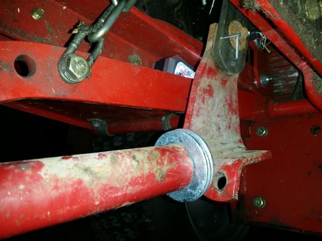

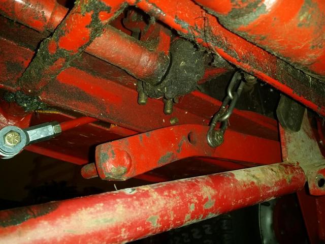

TT-(Moderator) 1,128 #4 Posted November 8, 2014 Here's the chute rotator rod bracket installed in the mid-hitch: From the manual: Location of lift lever shaft - looking up from under tractor: Lift rod attachment excerpt from the manual. (part in red is the downward-facing arm on the lift lever shaft of the tractor): Ignore the spring / eyebolt / locknut. They aren't needed on hydraulic lift tractors. 1 Share this post Link to post Share on other sites
gabe911 23 #5 Posted November 9, 2014 Wow that was actually pretty easy once I knew where everything went! Thanks again for your help you both! 2 Share this post Link to post Share on other sites

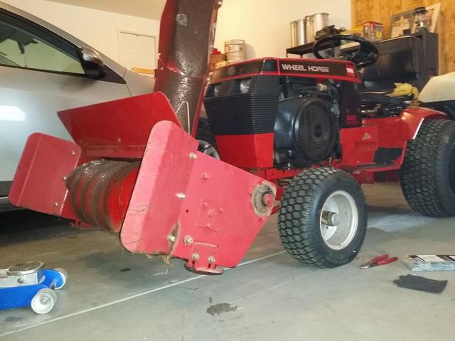

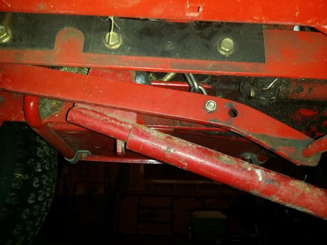

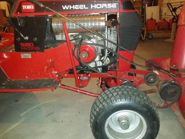

gabe911 23 #7 Posted November 14, 2014 Ok PART DUECE Can anyone please tell me how to hook up the lift arm to it? Getting ready for tomorrows snow!! Share this post Link to post Share on other sites
doc724 924 #8 Posted November 15, 2014 I think you are good to go. The lift arm (which you use to lift the deck) does NOT connect to the blower lift tube Share this post Link to post Share on other sites
gabe911 23 #9 Posted November 15, 2014 Huh, well Im stuck then, because when I try to lift it up with the control arm lever it only lifts up about 1/4 of an inch! I have it hooked on the first hole out of 3 on the top. Share this post Link to post Share on other sites
gabe911 23 #10 Posted November 15, 2014 With Mod TT's help I figured it out..added some spacers dropped it down one hole..and we got lift baby! Thanks ready for some snow..can't wait to see wait this baby can do..I'll post some videos of it in action once the snow accumulates some more. Share this post Link to post Share on other sites
