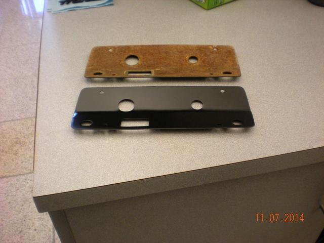

Geno 1,930 #1 Posted November 7, 2014 (edited) I talked to Terry today and wanted to get input if this is something you guys would be interested in. Terry mentioned to me the other day how much of a pain it was to install decals on these old dashes with the bump. I've also seen several very rusty and pitted dashes on here that could affect the look after the decal is applied and longevity as there is less for the decal to adhere to. I talked to Scot and we made one without the bump. The dash is inset so the more gradual bend still looks great. We can do a sharp bend in it but that affects cost as none of us can do that so it has to go to another guy down the street that has a hydraulic bender. The lighter and ignition switch will have to be moved upward about 1/4" to work with the bend so they sit flat and we get a more uniform bend. These could be powder coated black or just painted satin black depending on what you guys think the rear side of the panel should look like. They could also be done in stainless, bronze, etc, but that will only affect the rear side look and longevity. Once the plates are done I will send them to Terry so he can fit the decal to it. I just thought of something else that I think Terry can do, what about doing a metal dash to replace the plastic ones and have a nice decal for it instead of the plastic (pic #2)? Yea, he doesn't know about that one yet. How would you like to see this thing made? Keep in mind, everything above affects cost. What would you expect it should cost in the configuration you would want? These when ready will be shipped with the new dash plate and the decal already attached and done. Below is the first prototype, the second is in the works now. Edited November 7, 2014 by Geno 4 Share this post Link to post Share on other sites

Geno 1,930 #8 Posted November 8, 2014 I made sum from alum but never finished I will see if I can find them I crossed aluminum off the list at the start. I was afraid if a choke cable stuck and it was pulled on hard enough it could bend the plate. I have a guy 1/2 mile down the road that has one of those benders. I would be dangerous if I had that thing! I agree, I want dibs on 1st customer What if if cost $149.95. Share this post Link to post Share on other sites

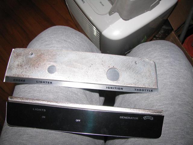

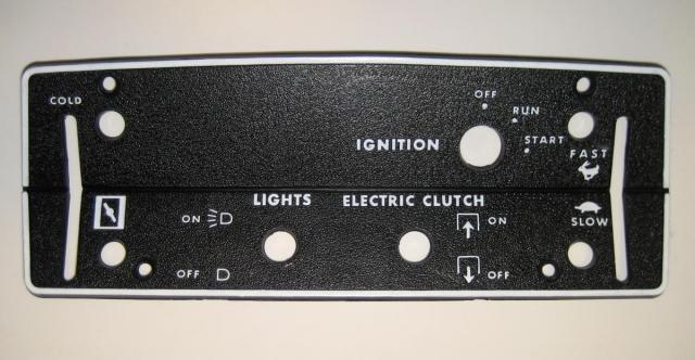

AMC RULES 37,256 #12 Posted November 8, 2014 (edited) I split both... my dash into two, and decal into three separate pieces. Edited November 8, 2014 by AMC RULES 4 Share this post Link to post Share on other sites
slammer302 2,157 #13 Posted November 8, 2014 How hard is it to split the dash plate 1 Share this post Link to post Share on other sites
Racinbob 12,901 #14 Posted November 8, 2014 I do the same thing as Bob with the plastic ones (only highlighting the stuff used) but I can see a need for a metal replacement. A lot of the plastic dashed are warped beyond repair. 3 Share this post Link to post Share on other sites
AMC RULES 37,256 #15 Posted November 8, 2014 Just locked it into a vice and rocked the bend back and forth a couple times... not much effort needed to perfectly split into two pieces...for me anyway. Seemed to me like it was pretty corroded, under the PO's white paint. Figured I had nothing to loose, but hard tellin', not knowin'...your results may vary. Share this post Link to post Share on other sites
Geno 1,930 #16 Posted November 8, 2014 (edited) I just paint the old ones. AFTER_DASH.jpg A lot of people have warped or damaged plates. I split both... my dash into two, and decal into three separate pieces. You had a pretty good dash to start with. I think the entire plate new with a decal on it may run around 75.00 if powder coated and done best way possible. I think the decal alone is around 25.00 at regular price with no discounts. Edited November 8, 2014 by Geno Share this post Link to post Share on other sites
