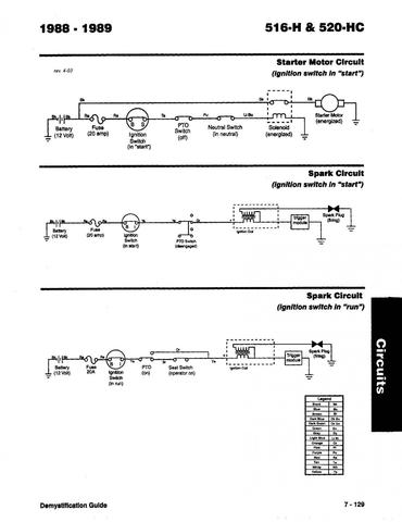

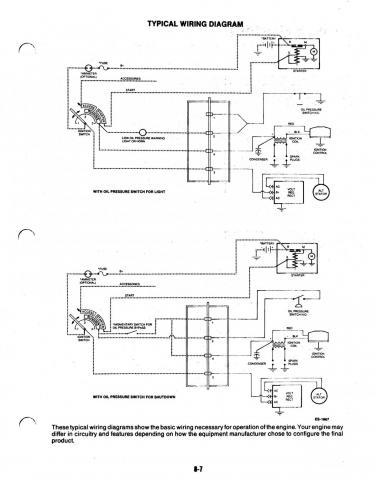

km3h 543 #10 Posted November 9, 2014 (edited) I am finding it hard to understand how you can be without voltage and spark while using a jumper wire from the plus side of the battery directly to the coil, unless the ignition module is acting up when hot. You are by-passing everything in the circuit when you do this. Have you replaced the ignition module? Read this page, 4th paragraph on right side. It would appear that if the oil pressure sensor reads low, it turns off the ignition module. The only other thing I can recommend and this is just a theory, is that there might be so much debris under the tins that after running it for a while it overheats to the point of shutting everything down. But electronically I can so no way for this to happen. I am stumped on this one. Onan Engine Manual 25.pdf Edited November 9, 2014 by km3h Share this post Link to post Share on other sites

Jess 29 #16 Posted November 10, 2014 Could be the coil or condenser heating up and quitting also Nick. Both are new as well as the ing module I am finding it hard to understand how you can be without voltage and spark while using a jumper wire from the plus side of the battery directly to the coil, unless the ignition module is acting up when hot. You are by-passing everything in the circuit when you do this. Have you replaced the ignition module? Demystification Manual_Page_473.jpg Read this page, 4th paragraph on right side. It would appear that if the oil pressure sensor reads low, it turns off the ignition module. Pages from Onan Engine Manual-2.jpg Onan Engine Manual 31.jpg The only other thing I can recommend and this is just a theory, is that there might be so much debris under the tins that after running it for a while it overheats to the point of shutting everything down. But electronically I can so no way for this to happen. I am stumped on this one. Everything is clean and yes ignition module is new Share this post Link to post Share on other sites
