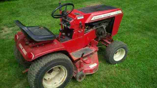

GreenMntRanger 38 #1 Posted November 6, 2014 Will implements(snowblower and rototiller)for a 314-8 work on a C-161? I have a chance to pick up a C161 and want to know if my existing impliments will work on it. Im on the road for work and dont have the time to so the research Thanks in advance GMR Share this post Link to post Share on other sites

MalMac 1,337 #3 Posted November 6, 2014 Yes they will work. Basically the same tractor. Just different fender pan, hood and hood stand. I change attachments all the time from 141 and a 314. Share this post Link to post Share on other sites
Racinbob 13,286 #4 Posted November 6, 2014 MalMac is spot on GMR. All the attachments will work just fine. Share this post Link to post Share on other sites

GreenMntRanger 38 #7 Posted November 6, 2014 (edited) Just found out that the tractor has been repowerd with a new BS 18hp engine...is this a problem Edited November 6, 2014 by GreenMntRanger Share this post Link to post Share on other sites
Racinbob 13,286 #8 Posted November 6, 2014 I wouldn't let it be a deal breaker but it does hurt some. Hopefully the Briggs fit without chopping the sheetmetal. If a quality job was done on the transplant it will be fine. Maybe down the road you can get a Kohler for it. Share this post Link to post Share on other sites

Don1977 606 #12 Posted November 6, 2014 If the engine was installed with the PTO in the same location their won't be a problem. If not you might need different length drive belts. I don't know what the PTO heigth is on a C-161. I installed a Vanguard 18 HP in my C-120 and used original belts. I had to raise the engine 7/8" to get the PTO at the right height. 1 Share this post Link to post Share on other sites
ericj 1,580 #14 Posted November 6, 2014 that's a c161 twin originally came with a16 hp briggs so it's an up grade to an 18 hp eric j Share this post Link to post Share on other sites
