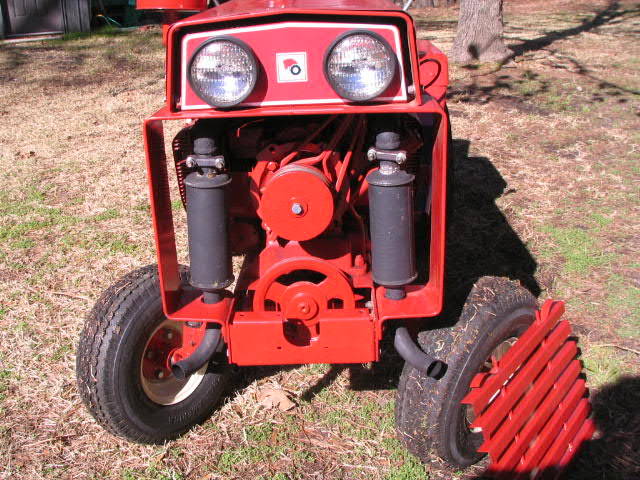

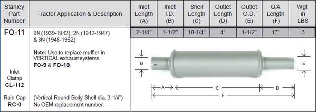

jdmitchjr@6dlam.com 5 #1 Posted November 4, 2014 (edited) The D-180 I picked up last year came with undersized non-original mufflers, one of which was falling apart. After a fair amount of research and good information from this forum, I selected the FO-11 muffler from Stanley as a replacement. See Stanley catalog listing below. Some of the research revealed that shell lengths have been less than accurate. This can be a problem when trying to fit the muffler into the D-180 front frame. The actual shell length came in a bit longer than specified, but it just fit. I ordered the mufflers from ruralking.com at a little over $15 each and reasonable shipping. The inlet was about right for 1" npt pipe. The outlet was a bit big for 1" npt pipe but with a slot and muffler repair tape I ended up with a good clamped joint. I used a 90 degree street elbow at the top which get the muffler as high as possible in the frame. I also used a 90 degree street elbow to turn the exhaust to avoid burning grass. The result was a tight fit and some contact with the front frame. I am not happy about the frame contact, but the solution is okay for now. The after photo was taken before I adjusted the angle of the outlet on the left (when viewing) side. Sound level is reduced by about 50% by ear, so a big improvement. Regards. Edited November 4, 2014 by jdmitchjr@verizon.net Share this post Link to post Share on other sites

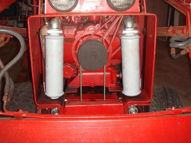

pacer 3,181 #2 Posted November 4, 2014 That looks similar to the mufflers I chose and it was also too long, being as I am retired and have more time than money, I cut about 3" out of each one and re-welded it back. For the bottom outlets I went to the muffler shop and had the guy bend me up some 90°s - I actually had him do me 4 of them and I have already found uses for the other 2. You're right about the difference in sound -- nice (mine had 2 of the 'biscuit' types on and they were almost like not having anything) Share this post Link to post Share on other sites

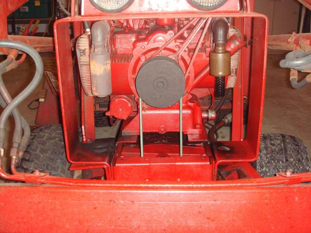

ericj 1,580 #3 Posted November 4, 2014 when i replaced the mufflers on my D200 i welded freeze out plugs into the ends and then drilled holes to make them look factory. i think it was 25/32 freeze plug but been to many years to remember for sure eric j Share this post Link to post Share on other sites
GT14 243 #4 Posted November 4, 2014 Nice choice, and clean install. Share this post Link to post Share on other sites

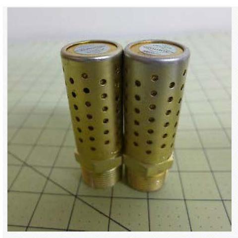

jdmitchjr@6dlam.com 5 #5 Posted November 4, 2014 I would have liked to have shortened the shells a bit as Pacer did (his post of the photo of his replacement was my main guide for mine), but I am without a welder and way out of welding practice. And it was not a big enough or meaningful enough project for my wife to okay a welder.... I am thinking about adding a compressor silencer like the one shown below. It will be an easy add as I ended with a 1" npt female elbow. My sense is that the selected muffler is almost a straight pass through and with one muffler per cylinder not enough out of phase sound waves are setting up, making it not as quiet as I would like. So restricting the outlet a bit with the silencer might help that, as long as I do not create too much back pressure. Any thoughts on that? Regards. Share this post Link to post Share on other sites
