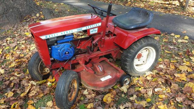

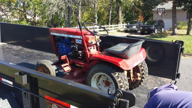

JERSEYHAWG / Glenn 4,487 #1 Posted November 3, 2014 Ok guys. Me and the brother just picked it up. The 50 dollar wheel horse. The owner let me have it for 40 dollars. 10 bucks off. At least it was saved from the scrap heap. AND only about 3 miles from my home. Glenn 9 Share this post Link to post Share on other sites

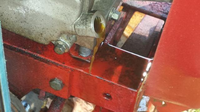

JERSEYHAWG / Glenn 4,487 #2 Posted November 3, 2014 Went to check the oil. What you see pouring out is a gas oil combination of ****. But...75 percent gas. Gee I wonder why the engine won't pull through....must be broke. Lol Glenn Share this post Link to post Share on other sites

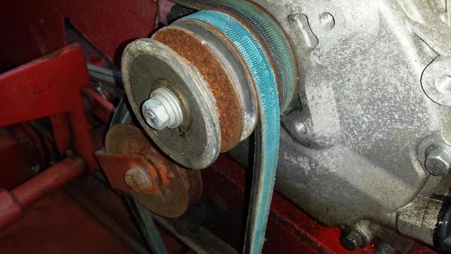

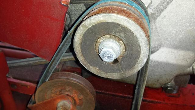

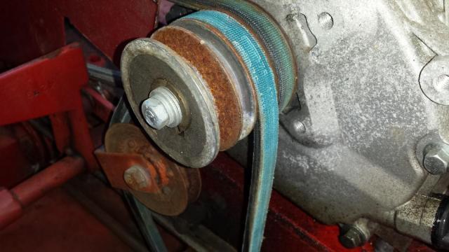

JERSEYHAWG / Glenn 4,487 #9 Posted November 3, 2014 Ok...to start I thought at least pull that motor off to throw it away. Does this pulley set up look right? In other words should I save them or toss them? A real ham n egg set up. Just don't want to throw real wheel horse stuff away. Ty. Glenn Share this post Link to post Share on other sites

C-101plowerpower 1,605 #11 Posted November 3, 2014 looking at the stuff that is coming out of the oil hole, looks a lot like the oil a mate of mine had in his home made atv, it had a carb that didn't stop overflowing, might want to check that and get it running for now so you can test the trans and deck Koen 3 Share this post Link to post Share on other sites

slammer302 2,154 #13 Posted November 3, 2014 I would save the pulley setup for sure 1 Share this post Link to post Share on other sites
ol550 830 #14 Posted November 3, 2014 Ok...to start I thought at least pull that motor off to throw it away. Does this pulley set up look right? In other words should I save them or toss them? A real ham n egg set up. Just don't want to throw real wheel horse stuff away. Ty. Glenn 20141103_154812.jpg20141103_154755.jpg Normally the double pulley would be to the outside. The bushing just lets you use the 1 inch pulley work with the 3/4 shaft. Share this post Link to post Share on other sites
buckrancher 2,678 #15 Posted November 3, 2014 right pulley Glenn just on backwards Brian 2 Share this post Link to post Share on other sites
Molaker 15 #16 Posted November 3, 2014 looking at the stuff that is coming out of the oil hole, looks a lot like the oil a mate of mine had in his home made atv, it had a carb that didn't stop overflowing, might want to check that and get it running for now so you can test the trans and deck Koen What he said.^^^ There may be nothing wrong with that motor other than a float valve leaking. A carburetor kit could be all it needs. 2 Share this post Link to post Share on other sites

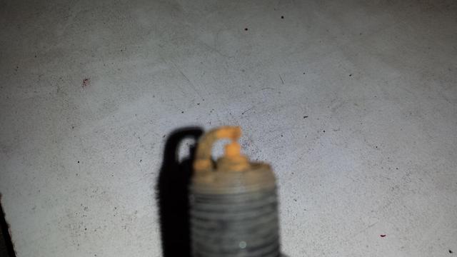

JERSEYHAWG / Glenn 4,487 #18 Posted November 3, 2014 Hey. How's this spark plug look? Glenn Share this post Link to post Share on other sites
RMCIII 838 #19 Posted November 4, 2014 Kind of hard to tell. The guy taking the picture has a shaky hand! 1 Share this post Link to post Share on other sites
Desko 552 #20 Posted November 4, 2014 Looks pretty rusty to me 1 Share this post Link to post Share on other sites
