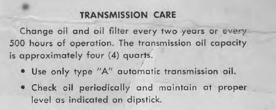

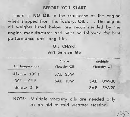

rmaynard
Ok so you could run engine oil in the transmission. Gotcha
Sort of...
SAE 30W is what was recommended for engines, and later model hydros used 10W30 or 10W40 motor oil.
Here is a snapshot taken from the 1075 owners manual.
post-2221-0-31839300-1414934763_thumb.pn
Edited by rmaynard
ericj
you can run engine oil 10w30 or 10w40 in the hydro trans on the early one and as stated above the later one called for it. bur if you want you can run automatic trans fluid in the early hydro's. if it was me i would run the motor oil in mine if i had to change it
