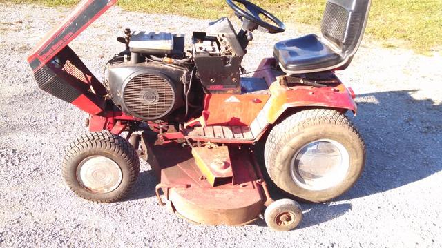

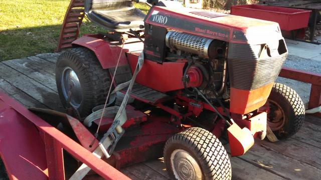

rollingflat 123 #1 Posted November 1, 2014 Just brought home a 520-h here are the raw pics. Have not touched it other than backed off trailer and tested the mower. got the wagon in the deal too! Looked up numbers and looks like a 1991. Motor runs great hydro works great po said mower cuts uneven. will keep u posted on cleanup. 5 Share this post Link to post Share on other sites

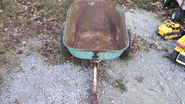

rollingflat 123 #8 Posted November 1, 2014 I remembered dtallon restored a wagon just like this one on this site and it turned out great. So add another project to the list. Share this post Link to post Share on other sites

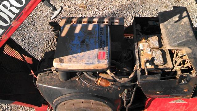

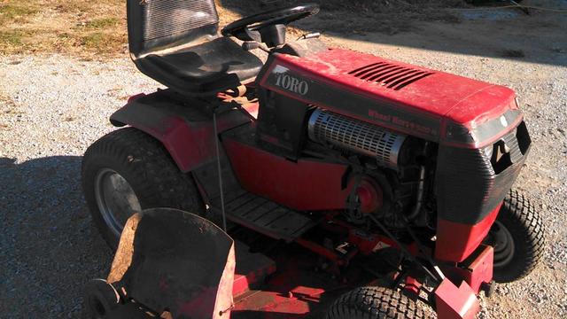

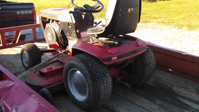

rollingflat 123 #10 Posted November 1, 2014 OK did not have much time w the tractor today but did mow a few passes in yard and it cuts great. As nice or better than my zero turn! Found the pin on the lift arm broken off that slides into slot on deck. probably why po said it mowed uneven? also noticed oil psi light came on and blinked when mower was engaged not sure why? so very happy with my new ride I think will use it for second mower on property. heres more pics after unloading. Share this post Link to post Share on other sites
motox25 36 #11 Posted November 2, 2014 Wow great score, even has the awesome 60" deck. That deck gives the best cut of any deck I've used. The lift arm lifts the front of the deck while the rear rides on the deck wheels. I would imagine it would cause an uneven cut or scalp. Oil PSI light flashing is either due to insufficient oil pressure or a bad sensor. Sensor is located behind the fan shroud near the rear cylinder. The Onan engine manual details how to test the sensor. Great machine! Share this post Link to post Share on other sites

dtallon 320 #13 Posted November 2, 2014 Looks like a nice find. Your specified location is pretty vague, but that tractor didn't come from central Illinois did it? I thought I remembered seeing one like that on Craigslist earlier this week and thinking it looked like a pretty good deal. Those carts are fun. I put way too much work into mine, but was pretty happy with how it turned out. Dave Share this post Link to post Share on other sites
rollingflat 123 #14 Posted November 2, 2014 Dave yes that was the one in central il.I'm tickled to get it. And loved you thread on rebuilding the cart. Where r u located? Share this post Link to post Share on other sites

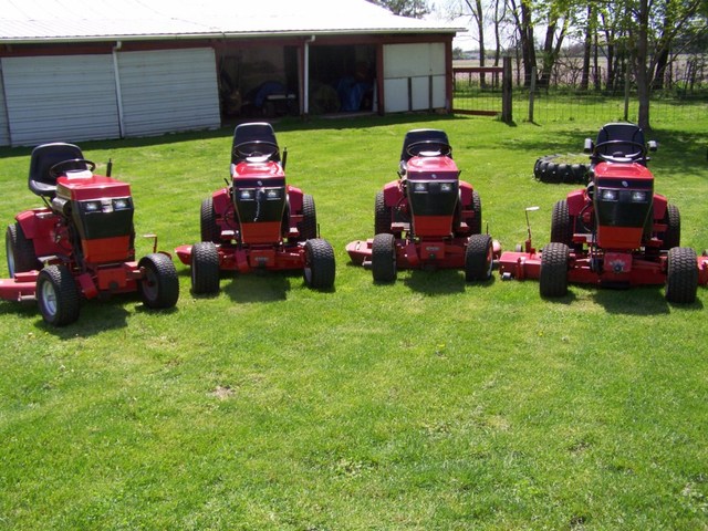

546cowboy 302 #22 Posted November 3, 2014 I had a 516H quite a while back before I got my first 520H and after that the 516 had to go. I think I've had 6-520's now including the elusive 520-8. Two with 60" decks and all the rest had 48's. Here are a couple pictures from when I had a 500 Herd. The 516 on the left, then 1990 520-8, 1988 520H and 1990 520H w/60" deck. Enjoy! 1 Share this post Link to post Share on other sites

rollingflat 123 #24 Posted November 4, 2014 Ok made some progress on 520 tonight, took off deck and repaired lift arm post. (welded bolt into hole). Found the mid attach a matic loose on one side repaired. fixed head lights and tail lights. Found oil drain pipe loose and leaking, will tighten when oil is changed. polished all chrome, hood and fenders. Next will b to clean deck and weld acouple of cracks. change oil, and all filters. remount mower and test it out. Share this post Link to post Share on other sites
rollingflat 123 #25 Posted November 4, 2014 (edited) Question, there are no roller wheels on front of deck...should there be? I would think there should be.? Sorry one long roller in middle front but none on outer sides of front. Edited November 4, 2014 by rollingflat Share this post Link to post Share on other sites
