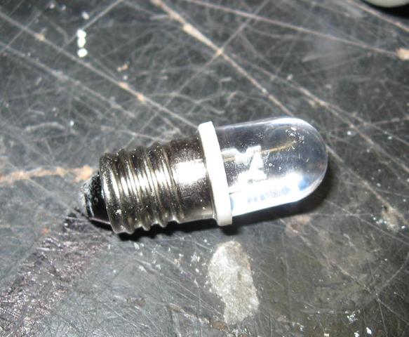

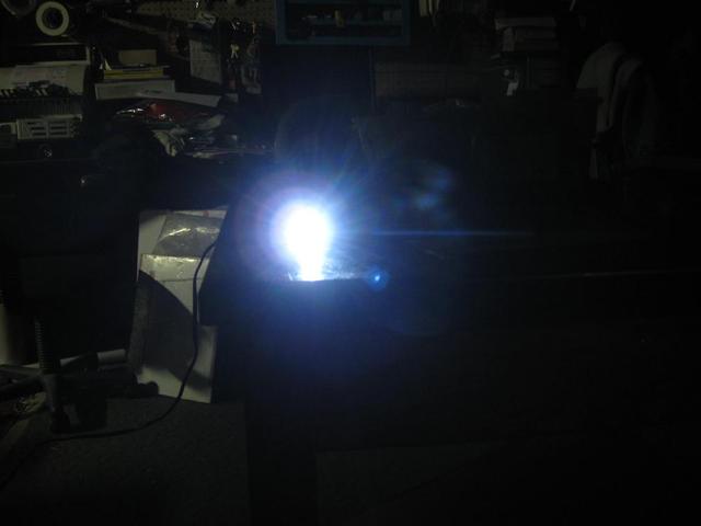

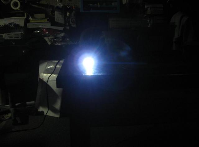

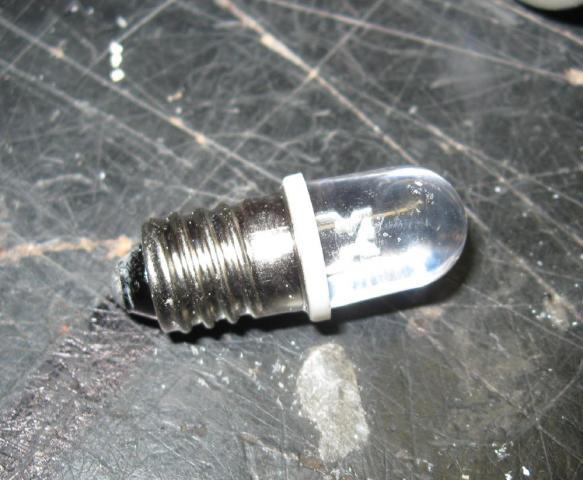

N3PUY 1,031 #17 Posted November 8, 2014 OK .... I'm back ..... with pictures of LED on AC and DC. I would have done it sooner but this computer gave up. Now it's a 10 year old computer running Windows7. CPU runs 100% most of the time. Anyhow .... In one pic the bulb is on AC and the other pic is DC. I forget which is which 'cause that was last week when I took the pics. The bulb is a 12V LED used in Marx and Lionel trains. The brightness looked the same to me. Share this post Link to post Share on other sites
Save Old Iron 1,576 #18 Posted November 12, 2014 (edited) N3, thanks for getting back to me on this. The assembly you have used is essentially a single LED with (most likely) a current regulator or resistor mounted in the screw in base. Since this is a single LED unit, the LED will likely light up with anything more than 3 - 4 volts applied to its contacts. Any additional power supply voltage in excess of 3 - 4 volts is likely restricted by a regulator in the base of the led. Do you have a way of measuring an AC input and varying the input to see when the LED comes on? So 12 volts DC - no problem 12 volts AC - which is really pulsating 6 volts DC will also light the single bulb just as brightly. Taillights or marker lights most likely do not use a single LED like yours since the bulb would have to be screwed into the socket with the dome facing outward toward observer and this would lead to a very "thick" lamp housing. I will have to look into how LED taillights are constructed - and I'm sure they are not all the same. Each white LED takes about 3 volts to bring allow it to operate. If several 3 volt LED's are wired in series, lets say 4 of them, the lamp assy will need in excess of 12 volts to glow at full brightness. If the manufacturer wants the lamp to be illuminated at say anything over 9 volts, they could put 3 LEDs in series and use internal current regulators or a ballpark dropping resistor to allow full current allowed by the LEDs to flow at about 15 volts (the highest expected in an automotive environment. So I guess the most accurate answer to Tankmans question would have been "It depends". The answer that will work for sure is "use incandescents off the headlight circuit." Good reply. I'll have to grab a set of LED taillights one of these days and check how they are wired. Edited November 12, 2014 by Save Old Iron Share this post Link to post Share on other sites
