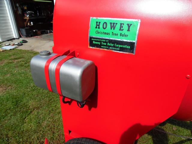

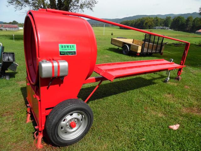

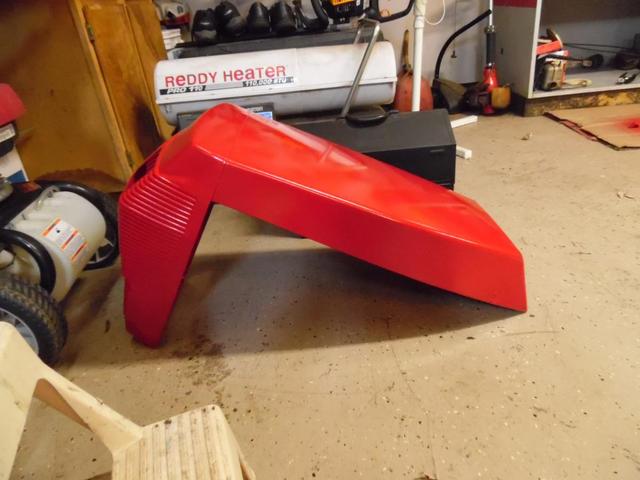

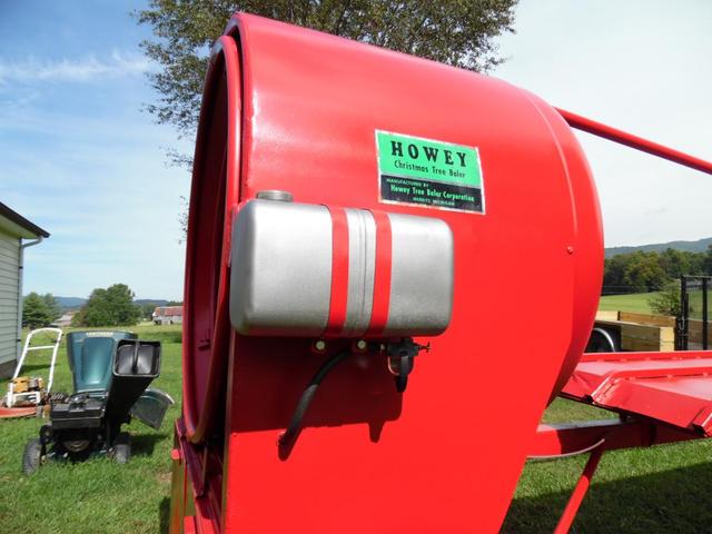

BryanRTenn 11 #12 Posted November 2, 2014 looks great. I just bought a blade (well bought a whole c81 just to get the blade) & want to get it painted this week. I love the rubber idea, will see if I have anything laying around I can use. I used the IH red majic from TSC on my 416 hood & fender pan & misc. parts. Looks great but takes forever to dry unless its in direct sunlight or under heat which is gonna be hard for me to do this time of year. Thinking about using rustoleum sunrise red. Real close color wise & dries quick. I dont know how either really stands up yet to weather & abuse. Back in the summer I painted a tree baler for my neighbor with the majic IH red, looked great. We will see how well it holds up in a couple weeks when he starts baling christmas trees! 1 Share this post Link to post Share on other sites
