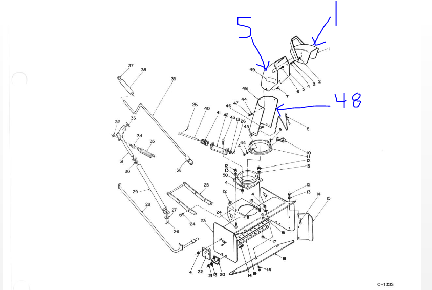

PaulC 342 #1 Posted October 29, 2014 has anyone made tall chute blower parts? I am just concerned with the sheet metal parts for the chute. I just picked up a nice tall chute blower from a local member and it is missing the chute. Two of the 3 pieces can still be bought through partstree but they would cost $175 bucks!! They look simple enough to make so im wondering if anyone has converted a short chute at some point? if not anyone out there with a tall chute that would want to take measurements for me? I want to make the parts for the blower I just got but also thinking maybe I could make more for the other two short chute blowers I have? see my attached screenshot where I point out the parts im referring too. number 1 might be tougher to make so im thinking maybe just number 5 and 48 would be enough? any of you guys that have or have had tall and short chute blowers feel free to speak on the difference and benefits of each. thanks paul Share this post Link to post Share on other sites

PaulC 342 #4 Posted October 30, 2014 Thanks Brandon but I do have both units so im aware of the different turning setups. The tall chute parts bolt on to the turning ring and on the short chute I think the lower chute shroud is welded to the turning ring so I would think if the welds were cut tall chute parts could be put on with some modifications but maybe it hasn't been worth it to anyone? My short chutes do work fine but from most of the stuff ive read people say the tall chutes are much better? I have lots of access to sheet metal and am a former fabricator so paying that kind of money for parts that look fairly simple to make is really tough for me. Now that I realize I am missing item 28 that would be another $130 bucks. I love this stuff just as much as the next guy but I have trouble spending big dollars on some of these parts. If I did indeed spend $300 to get these parts I don't ever think I could get that for the blower if I decided or for some reason had to sell it? Not everyone would look at it that way and that's fine but I do. Im sure I can figure out how to make what I need but it would be a lot easier if I had to do less "figuring out" 1 Share this post Link to post Share on other sites

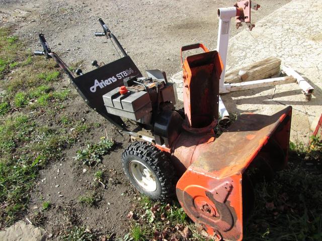

baerpath 517 #6 Posted October 30, 2014 Here's parts 1 and 5 and the worm gear shoot turner Ton's of old snowblowers out there. This ones got a broken auger worm gear so I sold it to a parts guy for $50 and he'll part it out The crank holder is only a piece of rod easlily made Just a thought Share this post Link to post Share on other sites
