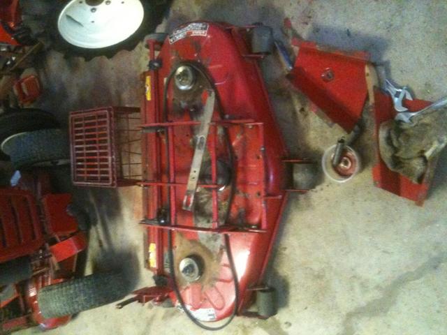

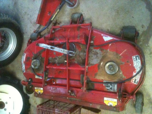

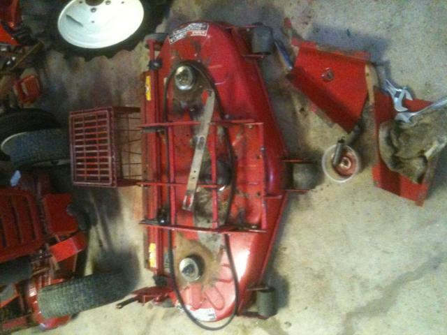

KyBlue 655 #2 Posted October 29, 2014 I have a 42" that does the same thing ... Found out that when I picked it up the deck shell was twisting from a few cracks and prior WTF rust repairs ... There's my thread and pictures...might give you some idea of where to look for trouble spots. I'll be media blasting the shell next weekend and getting busy with repairs ... Share this post Link to post Share on other sites

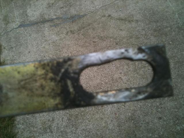

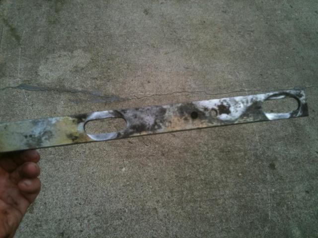

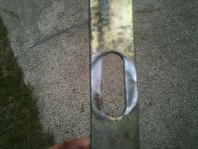

Lane Ranger 11,976 #3 Posted October 29, 2014 (edited) I have a recycler deck 42 inch with the baffles inside. The deck is in good shape and has the same reinforced edge on it Cod. What I found by investigating is the idler arm on the deck had been wallored out in two places (one underneath the idler pulley) and the deck lift frame that attaches in the center to the tractor lift also had wallored out holes from use (20 years or more). I replaced both of these pieces . I have not used the deck again as I am waiting for Spring to do so. But I think that had a lot to do with the bad cut I was getting on the 42 inch recycler deck. Edited October 29, 2014 by Lane Ranger Share this post Link to post Share on other sites

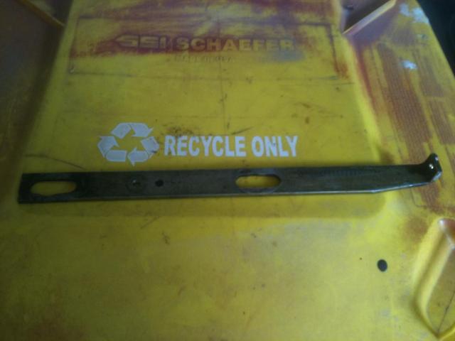

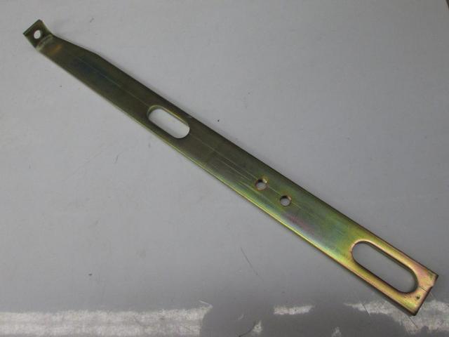

Lane Ranger 11,976 #5 Posted October 29, 2014 (edited) Here are a couple more pictures of the wallored out idle arm off my 42 inch recycler deck! Here is a picture of the new idler arm piece for comparison to the old one I had on the 42 inch recycler deck: Edited October 30, 2014 by Lane Ranger Share this post Link to post Share on other sites
PaulC 342 #6 Posted October 29, 2014 That idler arms only purpose it to keep the belt taught it has nothing to do with the way the deck cuts and I believe those slots should be slots not holes. The one is a little worn in the opposing direction but I would think it will be fine. What do you mean it doesn't mow smoothly? cuts good but it loud? doesn't cut good? the proper way to set it up is to measure from the ground to the blade tips when the deck is mounted on the tractor and in cutting position but there isn't much room so it sure aint easy. Share this post Link to post Share on other sites
Lane Ranger 11,976 #7 Posted October 29, 2014 (edited) The idler belt can not run tight when the idler arm is not flat or bounces side to side as this old one did Paul. It was made with slots not holes but the holes or slots were not worn thin and wide like the pictures show. A new idler arm and the nylon bushings were installed and it is now tight. The mower deck carriage had dthe same basic problem. The slots the lift arm rides in were wallored out wider than original specs which made the deck bounce. The cut of the three blades in the deck was uneven before the two parts were changed. As I indicated I will see in the Spring what it does on the cut. I did check the blade height from the ground to blade tips at the start of my use of this mower deck and they were fairly even height from concrete garage floor. Edited October 29, 2014 by Lane Ranger Share this post Link to post Share on other sites
