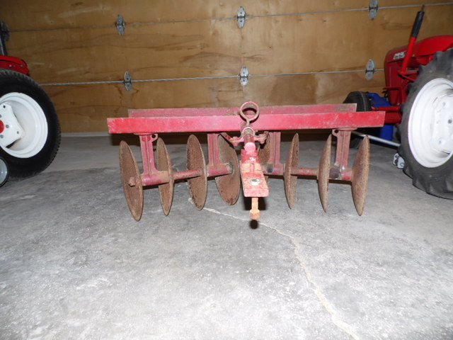

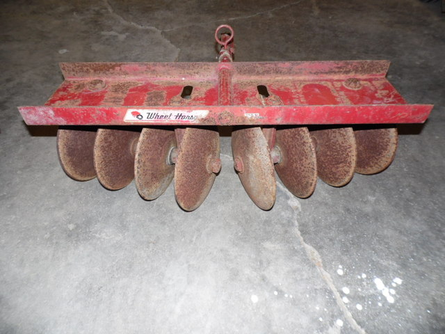

Molon_Labe 731 #1 Posted October 29, 2014 I placed an ad a few months back for a garden tractor disc and pretty much forgot about it until a gentleman contacted me last night and asked if I had found a disc and if not he had one at a very reasonable price. Then he informed me that it was for a Wheel Horse and I was speechless. Here's what I picked up this evening. It's in great condition but the first thing will be a complete tear down, clean up and paint. Then a call to Terry for decals. 5 Share this post Link to post Share on other sites
KyBlue 655 #2 Posted October 29, 2014 that'll be beautiful when you get it all redone ... GREAT score!!! 1 Share this post Link to post Share on other sites
rollingflat 123 #3 Posted October 29, 2014 NICE find MB been looking for a disc myself. Keep us posted w pics of the restore. 1 Share this post Link to post Share on other sites

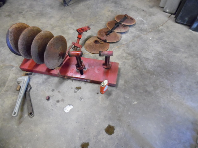

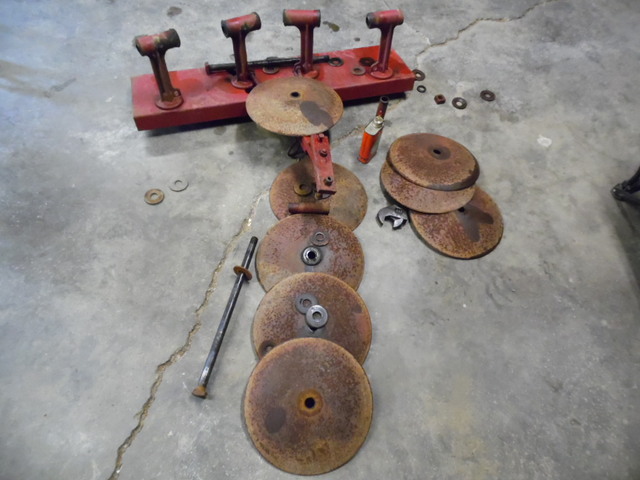

Molon_Labe 731 #5 Posted October 31, 2014 Progress on the tear down so far. 50+ year old bolts are a real challenge to get loosened up. 2 cracked bells to order, luckily Brinly uses the same size. 2 seized gang bushings, thank goodness for the press. A healthy dose of rust converter on the good bells. Wait for parts! Share this post Link to post Share on other sites

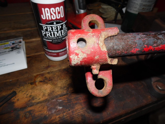

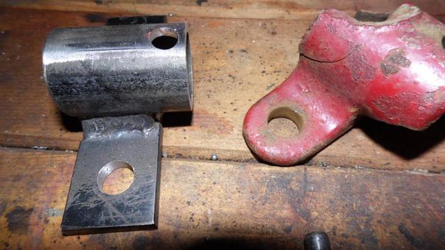

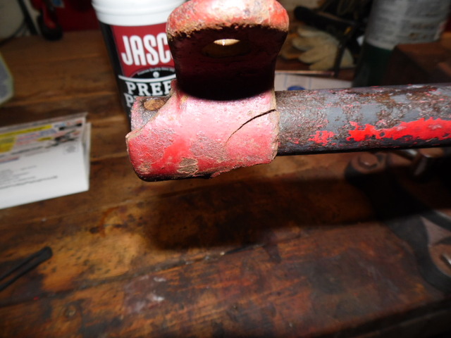

Molon_Labe 731 #10 Posted November 1, 2014 Thanks for the comments guys. With any luck I can start putting everything back together some time next week. In the mean time I have to fab up a replacement trip-lever, the part that sets the gang angle. The original is cast iron and pretty well busted up as the photos below show. Looks like some one took a hammer to it at some point. Never a good idea when working with cast iron. Share this post Link to post Share on other sites
KyBlue 655 #11 Posted November 1, 2014 Gotta love it when the previous owners tear it up with copious amounts of stupid... You'll get it back to better than new 2 Share this post Link to post Share on other sites
Molon_Labe 731 #12 Posted November 1, 2014 Gotta love it when the previous owners tear it up with copious amounts of stupid... You'll get it back to better than new If that doesn't sum it up I don't know what does It seems the previous owners create more work than they fix for the most part. Just part of the fun, huh? Trying to figure out just what the heck they were thinking when they did what they did to tear up a perfectly good piece of equipment Share this post Link to post Share on other sites

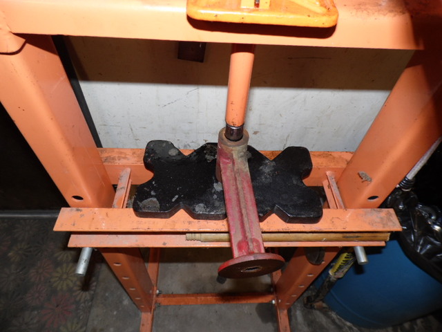

Molon_Labe 731 #13 Posted November 2, 2014 (edited) Spent the day fabricating a replacement trip lever for the disc. Made from a 3" piece of 1" black iron pipe and a 4" section of 1/4" steel strap, fits great. More to come and thanks for following, I probably should have posted this in restorations section, I just had no idea at the time there were this many problems with it. Edited November 2, 2014 by M_Bailey 2 Share this post Link to post Share on other sites

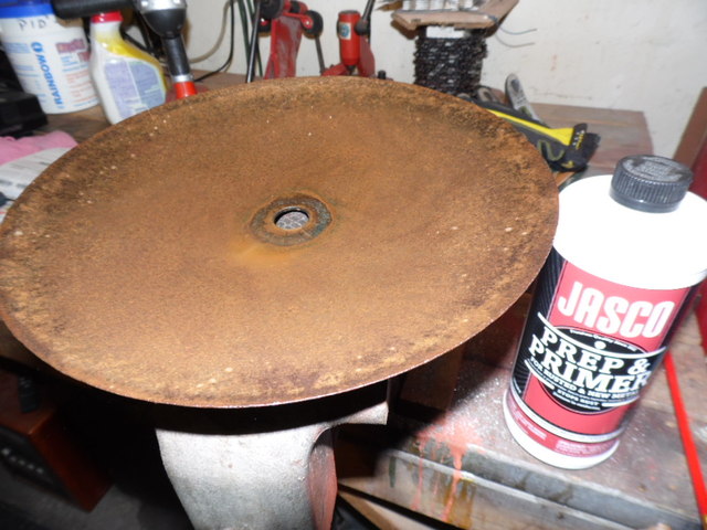

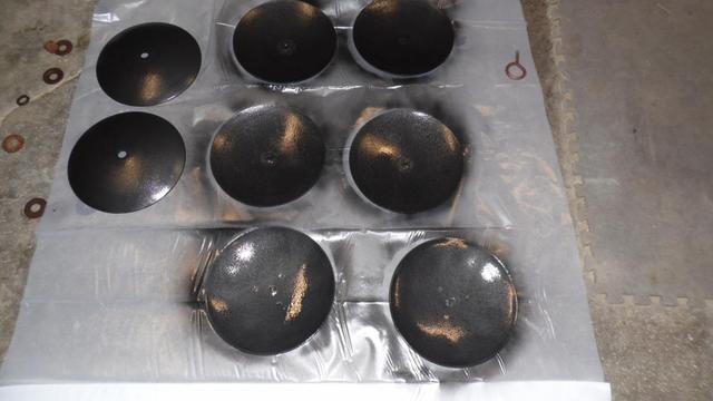

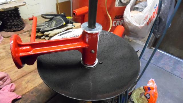

Molon_Labe 731 #17 Posted November 5, 2014 (edited) Today was parts day, the bushings, bells and misc all showed up at once. After originally thinking the bells would be painted red as the originals I decided to paint them with RustOleum hammered black as Lane (thanks) had suggested. Two of the gangs are re-bushed now, two to go (the bushings required fitting to the gangs) and painted now and have the other two soaking over night in solvent to loosen up the 50+ year old combo of grease and dirt. The 2 bells in the foreground are the ones ordered from Brinly, same diameter but slightly more concavity than the originals. This project is turning into a lot more work than I originally thought it would. Edited November 6, 2014 by M_Bailey 1 Share this post Link to post Share on other sites

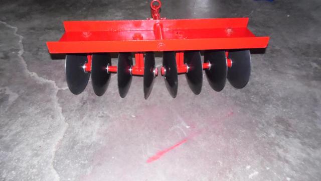

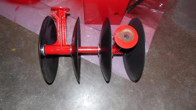

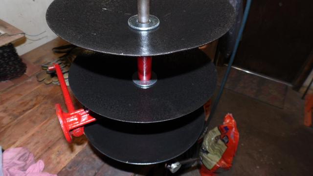

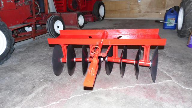

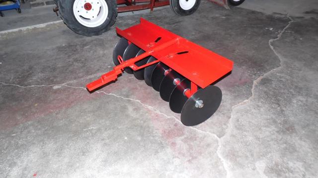

Molon_Labe 731 #24 Posted November 8, 2014 (edited) Today was assembly day but first I had to build up the axles where the discs had spun on them. Drat, out of shielding gas for the welder. A quick trip to TSC and I'm back in business... not quite, the new argon/co2 tank was dry as a bone. Back to TSC, exchanged tanks and was loading the replacement when I saw it was labeled oxygen, one more exchange and they gave me the right gas. Weld, grind and assembly time finally! First step, lock the axle in a vise and start stacking on the parts. After the washers, bells and gangs are all in place, tighten the axle nut and then the lock nut. Test to make sure there is no binding when the discs are spun on the axle. The rest of the reassembly was a piece of cake (kind of, a 3rd hand would be helpful at times). The decal from Terry should be here some time next week and that will finish it off. I'm gonna hate getting this thing dirty was the first thing my wife said. She's right, as usual! Next project is the 400 Suburban A note to anyone rebuilding one of these; There is room for a 12" disc blade on these in lieu of the factory 11" and the 12" discs are half the price Brinly charges tor their 11" disc. If I ever have to tear this one apart again I'll go with a full set of notched 12" discs. Edited November 8, 2014 by M_Bailey 3 Share this post Link to post Share on other sites
Geno 1,931 #25 Posted November 8, 2014 I was wondering when the next installment would show up, looks great! I think you should keep that one clean and get another one for a worker. 1 Share this post Link to post Share on other sites
