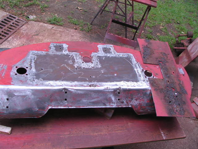

pacer 3,180 #14 Posted October 29, 2014 As more and more time passes our decks are getting more and more scarce and necessitates some drastic steps to keep them in use - and some other horse parts too!! This is one that was REALLY bad, but I figured I didnt have anything to lose by taking that huge chunk out of the middle of it. And, it did warp a bit but doggone if the thing doesnt cut pretty good. I had in mind to have it dedicated for use as strictly a leaf/pine straw 'picker-up' deck to use with my 'Cyclone' vacuum and it does that well. 1 Share this post Link to post Share on other sites

pacer 3,180 #16 Posted October 29, 2014 Whoever designed that stiffener plate on the decks must've wanted to get it to be able to retain water between the plate and shell --- and it certainly does that :eek: Share this post Link to post Share on other sites

Butch 194 #19 Posted November 6, 2014 As more and more time passes our decks are getting more and more scarce and necessitates some drastic steps to keep them in use - and some other horse parts too!! This is one that was REALLY bad, but I figured I didnt have anything to lose by taking that huge chunk out of the middle of it. And, it did warp a bit but doggone if the thing doesnt cut pretty good. I had in mind to have it dedicated for use as strictly a leaf/pine straw 'picker-up' deck to use with my 'Cyclone' vacuum and it does that well. deck 1.JPG What did it cost to buy the steel for that plate? I keep getting sticker shock when I see the price of steel around here. Share this post Link to post Share on other sites
pacer 3,180 #20 Posted November 6, 2014 I am fortunate to have 2 local scrap yards that allow us to roam freely looking for goodies and that piece came from there. I havent been in several months but at last visit steel was 30 cents a pound, so it was probably something like a couple bucks. I would imagine new cost would indeed give sticker shock! Share this post Link to post Share on other sites
