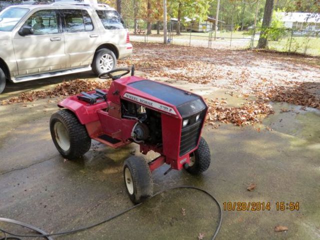

Molaker 15 #1 Posted October 28, 2014 I just obtained a Wheel Horse C-125. If I read the tag accurately, it is a 11-12K802 w/ 28022 following. That's all I can read on the tag. It is a black hood with steel fenders. Can anyone tell me what model year it is? 2 Share this post Link to post Share on other sites

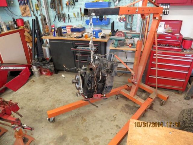

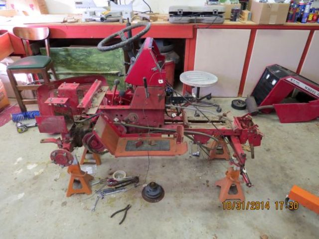

Molaker 15 #13 Posted October 31, 2014 If you plan on sticking around here and want to add the military member identifier you can do it here: I made my profile photo my old '69 Craftsman (sorry guys, but it has been in the family since it was new). I didn't want to use my new-to-me WH because it doesn't have a seat...yet. As for how long I plan to stick around, it kind of depends on how long I stick around, health being the dictator here. But, so far so good. I ordered new tubes all the way around yesterday. That rascal is a bear to move with flat tires. I may replace the front tires soon, but the rear tires may have to do until I find that pot of gold. I'm getting set up to disassemble the old steed. I'm going to pull the engine and clean it up on a stand. Then I'll put the tractor on jack stands and pull the wheels. Then I'll sit back and wonder what I'm doing. 1 Share this post Link to post Share on other sites

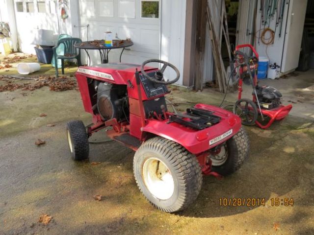

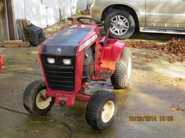

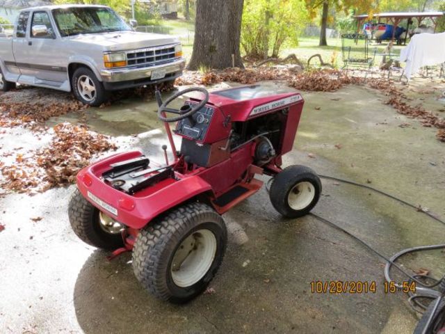

Molaker 15 #14 Posted October 31, 2014 First, thanks, Karl, for the Navy decal. It's a nice touch. I have a few more photos of my C-125. The question I have is, Now what? This WH seems to be in pretty good shape except for missing attachments. However, since its main job will be pulling a big trailer (yet to be built), this won't be a particular problem. I wouldn't mind having a blade someday, but I have a good mower and don't want to plant garden anymore. 1 Share this post Link to post Share on other sites
AJ_Thanatos 516 #15 Posted October 31, 2014 Did it run fine? I would check the trans oil, make sure it's not milky. Share this post Link to post Share on other sites

Trouty56 568 #19 Posted November 1, 2014 Hi Molacker..... If I were you at this point....I would take the tins and carb off the engine....(get carb kit )....plug any openings like the intake and then powerwash it using something like simple green as a grease cutter.... drain the oil from the tranny then hang that carcass that you have left on the cherry picker and do the same thing...... Then power wash the tins you have off..... wipe any water off using a spray and wipe wax.... change the oil in the tranny and motor when back together....get a new boot for the shifter if rotten.....enjoy!!!! Oh yeah....take that old mule off the front tachomatic too....lol....doesn't have pulleys any way...save it for a future homemade attachment........ And get a new seat..... 2 Share this post Link to post Share on other sites
Molaker 15 #20 Posted November 1, 2014 (edited) Hi Molacker..... If I were you at this point....I would take the tins and carb off the engine....(get carb kit )....plug any openings like the intake and then powerwash it using something like simple green as a grease cutter.... drain the oil from the tranny then hang that carcass that you have left on the cherry picker and do the same thing...... Then power wash the tins you have off..... wipe any water off using a spray and wipe wax.... change the oil in the tranny and motor when back together....get a new boot for the shifter if rotten.....enjoy!!!! Oh yeah....take that old mule off the front tachomatic too....lol....doesn't have pulleys any way...save it for a future homemade attachment........ And get a new seat..... My sentiments, exactly! Of course, it's 35 degrees out there this morning and not very conducive to playing in the water. I did note the shifter boot needed replaced. Anyway, I was planning on putting the wheels back on today and rolling it outside for a bath - carcass, too. As for wax, not yet. I've got a little painting to do. Speaking of paint, I noticed some parts are not the same color. Most are typical red, but the foot rests, pedals and a few other pieces are more orange. Is this typical? The seat bolt holes are the standard 7 1/2" x 7". Will probably get one of those seats from Northern Tool unless someone has a better source. I think I prefer the low back for ease of mounting/dismounting. How hardy are those ABS or whatever gas tanks? I guess if there's a crack or hole, a little JB Weld would fix it. Edited November 1, 2014 by Molaker Share this post Link to post Share on other sites

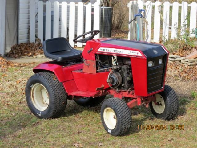

Molaker 15 #23 Posted November 3, 2014 I took the mule off the front. Then I got to looking and that big ol' mower deck lever which is useless to me (no deck and no plans on getting one) and kinda in the way, so I removed it, too. I'll bundle them up and store them away for a rainy day. I noticed one end of the left-side tie rod was worn out and would pop off easily. Same thing happened to my old Craftsman. Anyway, I ordered replacements for both sides. I, also, ordered new tires all the way around and will be ordering a tranny shifter boot and carburetor kit soon. That should about do it for replacement parts. I haven't done anything with the engine yet, but it looks like it is going to be good. At least, there is no apparent evidence it has been abused. Besides rebuilding the carb, I need to change the oil and check the points. Then I'll probably remount it and fire it up. I'm confident it's going to be an easy job. The more I look at it, the more I want to get it running and working. I may not be so diligent about restoring and just finish cleaning it, making it mechanically sound and get it going. 3 Share this post Link to post Share on other sites

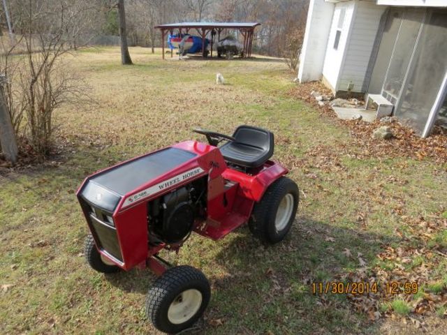

Molaker 15 #24 Posted November 30, 2014 It's back together and running. As I had indicated, I was getting anxious to put it to work, so I did not do an extensive redo. I settled for some new paint in the more obvious areas and the rest of the effort was in the mechanics. The engine seems to be in near perfect condition. I changed the oil (which, BTW, wasn't all that bad shape), cleaned out the gas tank and replaced the fuel filter, cleaned and put a kit in the carb, removed the deck lift, adjusted the brake, replaced the tie rods and put 4 new tires on it (I went with turf tread since I don't plan to do heavy work with it). The local power company replaced my feeder pole (about 40' pole) a few weeks ago and just dropped the old pole in the yard (my request). I just tied a tow strap to one end of the pole and put the WH in low-low and walked off with the pole. It didn't even hit the governor. I'm happy with it. For about $250-$300 I have a fine addition to my "fleet". 3 Share this post Link to post Share on other sites
Wheel-N-It 2,978 #25 Posted December 1, 2014 (edited) Good work on the C125. I had one of those and was amazed how smooth and quiet the rubber mounted 12hp engine is. I sold it to one of my best friends who wanted to try a Wheel Horse and he loves it. A good running one of these is a keeper. Good luck with it in the future. Edited December 1, 2014 by Wheel-N-It Share this post Link to post Share on other sites
