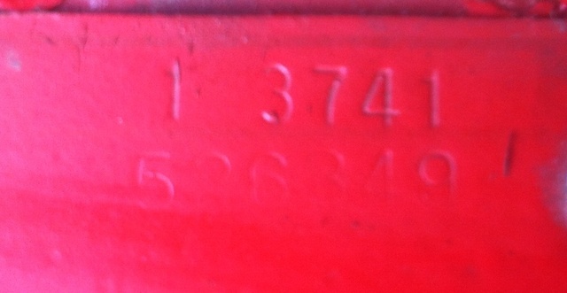

Sean Keys 57 #7 Posted October 27, 2014 Deck appears to have a 33" cut, and is a rear discharge. I could not find a tag on it or any form of identification. I will post a pic of the tractors id tag here directly. Share this post Link to post Share on other sites
Sean Keys 57 #8 Posted October 27, 2014 Here is a pic of the tractors id tag. Unfortunately someone painted over it. Let's try that again..... Share this post Link to post Share on other sites
gwest_ca-(File Mod) 11,760 #9 Posted October 27, 2014 Your tractor model number is written with a dash 1-3741. When you go to the attachment list they show deck models 5-2322 replaced by 5-2323. They also show 5-2362 but it is the same deck in a 36" width of cut and not 32" as Toro states. The parts lists are shared so easy mistake to make. 5-2322 ipl 1-3741 operator manual ipl and wiring The 16" blades #7908 and 7909 have been replaced by 8777 2-blade set from Toro The 18" blades #7906 and 7907 have been replaced by 8014 2-blade set from Toro Garry Share this post Link to post Share on other sites
