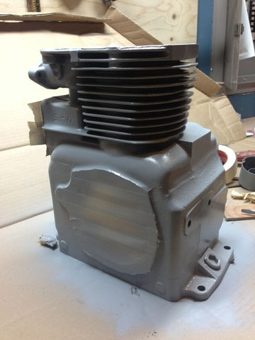

Forest Road 595 #33 Posted December 30, 2014 It's back from the machinist. Waiting on some seals. Share this post Link to post Share on other sites
Desko 686 #34 Posted December 30, 2014 Nice what all was done at the machine shop Share this post Link to post Share on other sites
Forest Road 595 #35 Posted December 30, 2014 Bored .010 over, valves cut and installed and media blasted 1 Share this post Link to post Share on other sites
AMC RULES 37,259 #36 Posted December 30, 2014 Price wise, for the machine work... what are we looking at there? Share this post Link to post Share on other sites
Forest Road 595 #37 Posted December 30, 2014 $300 also included balancing crank. 1 Share this post Link to post Share on other sites
