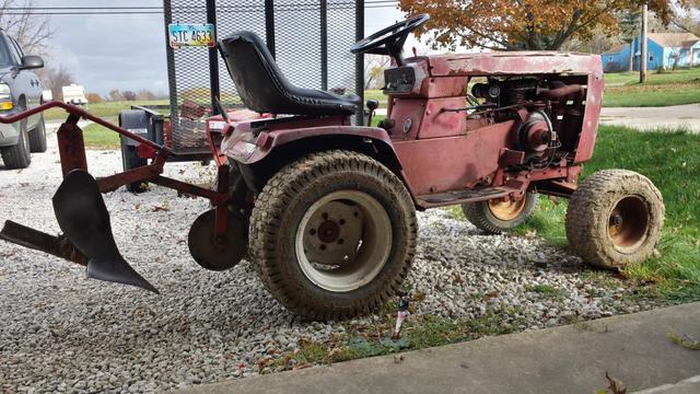

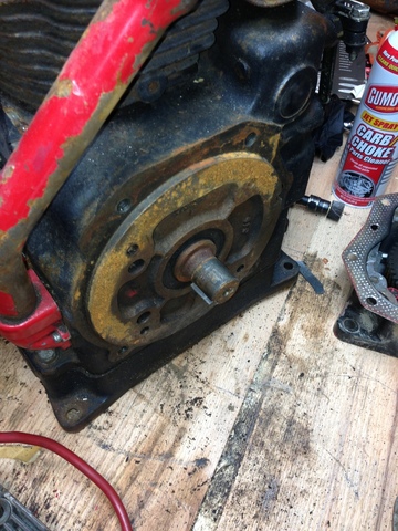

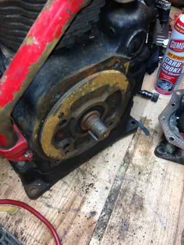

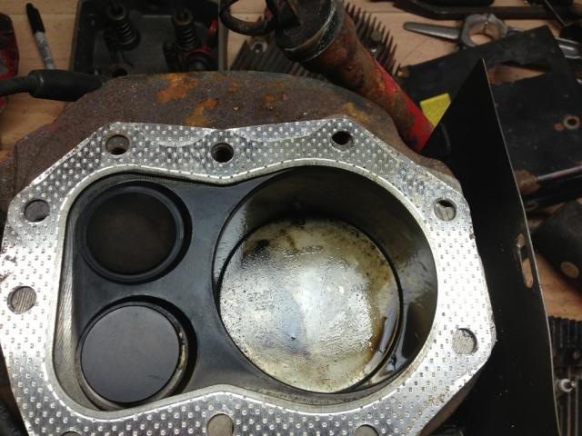

Forest Road 595 #1 Posted October 24, 2014 (edited) I've finally begun! Just finished tearing down a perfectly good motor. So good the cross hatches are still visible! Looking for some feedback from our motor heads!!!! Good, bad, or ugly. Let me have it. Im going to be putting Magnum parts back on this block. I plan to tap the points plunger hole and stick a screw in there and use a Magnum bearing plate. I'm willing to gamble on the camshaft NOT leaking any oil. The PTO side was dry. Plan is to clean up the rough spots in the valves from the casting. Also planning to blend the deck into the valves. Have the head checked and possibly cut down for a hair more compression. Balance gears IN or OUT? I considered having the cam ground for cheater specs. I just don't want to spend another $200. Original piston, rings, valves are going back in. Doubt this thing had 100 hours. Agree?? If you've got any other low budget suggestions I'm all ears. Thank you Kevin Edited October 24, 2014 by Forest Road Share this post Link to post Share on other sites

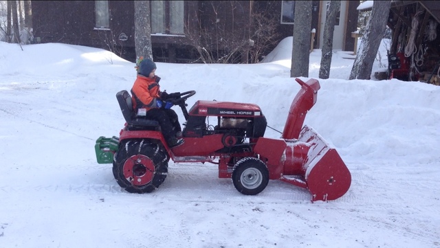

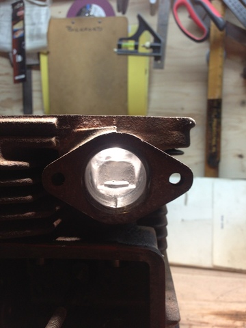

Forest Road 595 #8 Posted October 24, 2014 All I can say is WHY. What is your plan for this motor? Finally the big $$$ question!!! The tractor is a very clean worker at our family vacation home. General chores are no problem for the existing 225 hour Magnum 14. I WANT more power for the two stage blower. I'm no fan of Onans and refuse to spend $1200+ on a new V-twin. Although a standard K or Mag 16 would've been better than what I have. I really wanted to try my hand at minor motor modifications. I've read quite a bit on various pulling sights concerning these builds. Yet my favorite is David Kirk's Killer Kohlers. Short sweet and to the point. I've also spoken with a couple guys who build pullers and they pointed me down a similar path. Now back to the Cam. I'm definitely having second thoughts. @ $100-150 I was all in. $200+ shipping has me second guessing. Share this post Link to post Share on other sites

tbarnhart 240 #16 Posted October 25, 2014 Obviously, power and torque can be improved with a few simple tweaks. Think of an engine as an air pump. The more flow through, the more air/fuel is burned and the more power. People have been porting and tuning engines forever. The question is, how much can be gained. The basic valve-in-block architecture of the Kohler is not the most efficient design for airflow, but as the pullers have proved, can be helped considerably. Your biggest gains will come from some simple port and valve work, decking the head or head gasket elimination for more compression and the ability to adjust the ignition timing. The Magnum ignition is not adjustable without offset flywheel keys or slotting the mounting holes on the magneto. Faster ignition would give a fair bit more power, but could cause difficulty starting. Some of the fancy electronic automotive conversions have a bypass that retards timing for cranking then advances it for running. Works, but not cheap. The cam is another big piece of the airflow puzzle. Big percentage gains to be had there as well if your willing to take the plunge. For that two-stage, I would think you would want peak torque to be in the 3000 rpm range close to operating speed. You don't want the motor bogging to 2400 just to pull through a drift. The low rpms would limit the blower. Best of all, get a dyno and do the mods one at a time and share the results. Share this post Link to post Share on other sites

Callen 64 #19 Posted October 26, 2014 Your engine relies on atmospheric pressure to push air into the cylinder during the intake stroke, it doesn't suck air in. You need to maintain velocity through the port to carry and pack more air in before the valve closes. Grinding in the port if it's already borderline on the size needed for the rpm range will slow the velocity. Keeping the walls of the port slightly rough will help remix fuel when the valve opens and motion starts again, it does this 1800 times/min at 3600 rpm. You will probably be good just removing casting flash. For relieving the top of the block, I would just knock off the sharp edge of the eyebrows. I wouldn't mill the head. Anytime you move the top of the combustion chamber closer to the top of the block the flow over the edge of the cylinder is restricted. Getting the cylinder pressure up by filling it with air is better than trying to get the compression ratio up. 1 Share this post Link to post Share on other sites
Forest Road 595 #20 Posted October 27, 2014 (edited) Thanks again! I'm onboard with you. Builder I spoke to said dam near same thing. You explained it better. I'm not going nuts with the valves. Just eliminating the rough spots leftover from casting. The lip on intake was so bad it felt like a finger nail hanging out just under the valve. Can you recommend a shop to have the cam done? Hackman gets almost $250 w shipping. I wont buy from Miller. Edited October 27, 2014 by Forest Road Share this post Link to post Share on other sites

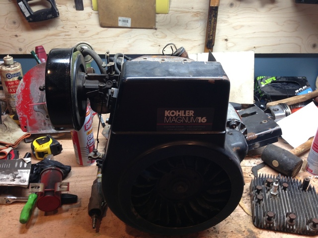

diamondred 63 #23 Posted October 30, 2014 (edited) There is no replacement for displacement. I'm sure the folks at Kohler back in the day did a great job designing engines. I have a C-81 (1979) that I just finished plowing the garden with. Although probably would not use it with a snow blower, point being it's 35 years old and still does the job. As far as getting rid of the points... bad idea. Points , coils and spark plus are easy to find. Points run off the cam, therefore only firing on the compression stroke. Point gap can be deviated from to adjust timing somewhat, can't do that with a Magneto. Only advantage of a magneto ignition is you don't need a power source, but the magnets could weaken. Along with the M series Kolhers came the non-adjustable main jet carbs If I had a choice between the two, it would be a K series, although I have both. Onan? ...thats the Horse on the other side of the fence, have them too. But don't cross that fence til you're ready! :ychain: Edited October 30, 2014 by diamondred 1 Share this post Link to post Share on other sites

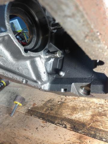

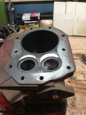

Forest Road 595 #24 Posted November 3, 2014 Went ahead and pulled the trigger. It's not "if" it's "when" I'll get around to it. Had some time to grind the reliefs tonight. With 3 boys under the age of 6 time is precious. I was really surprised at how little it took to grind. A gentle hand and a lot of patience pays off here. Another issue with this block is lack of a WH dipstick. It does have a short tube at the base. Id prefer to have a standard set up. I have a tube and stick from a magnum. The castings are in place for the tube bolts. I'm contemplating installing one. This may be better left to a machine shop. Share this post Link to post Share on other sites

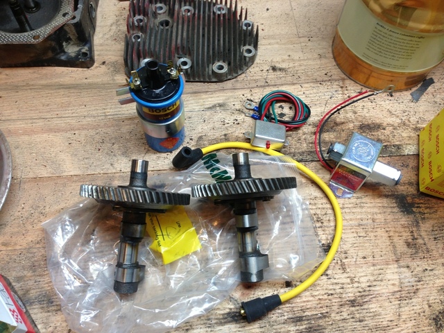

Forest Road 595 #25 Posted November 8, 2014 Christmas came a little early. Had some communication with David Kirk. It would seem that I now own his last cheater cam. Dropped the block off at a local machine shop. Hope to have it back next week. It's amazing how some things have come together in the past two weeks. With a little luck I might be ready for assembly by Thanksgiving . 1 Share this post Link to post Share on other sites
