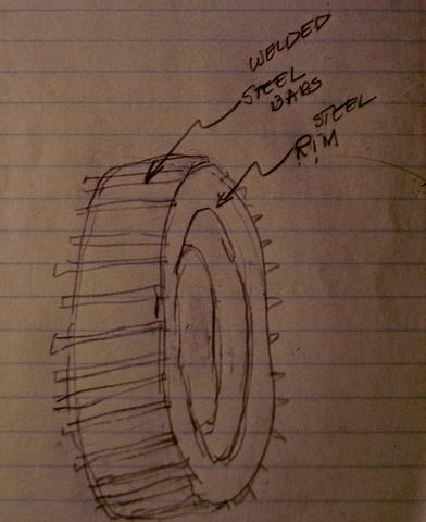

tarcoleo 120 #1 Posted October 22, 2014 (edited) I recall that early 20th Century farm tractors were furnished with cogged steel wheels. I don't recall seeing any such wheels fitted to Wheel Horse tractors. Why not? Surely for snow plowing such wheels would be superior to rubber/chain wheels for traction.. It would not be a big deal to weld cogs on a 15-16 in. auto steel rim with an appropriate 5-lug bolt pattern. Would look something like- Come to think of it, wheel might have to be 18 in. or so depeding on cogs used. Edited October 22, 2014 by tarcoleo Share this post Link to post Share on other sites

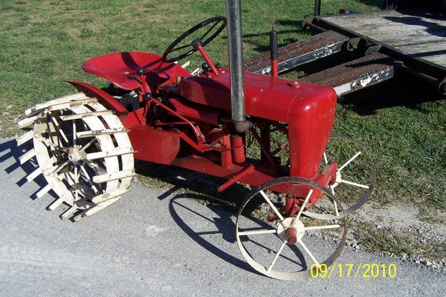

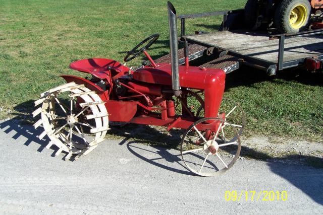

Lane Ranger 11,935 #5 Posted October 22, 2014 Here is a photo on some on a Wheel Horse in northern Indiana! Share this post Link to post Share on other sites

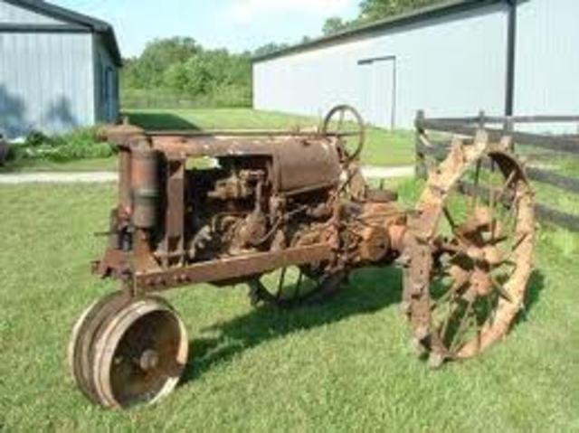

Ed Kennell 45,687 #9 Posted October 23, 2014 Not much traction on this one. Share this post Link to post Share on other sites
