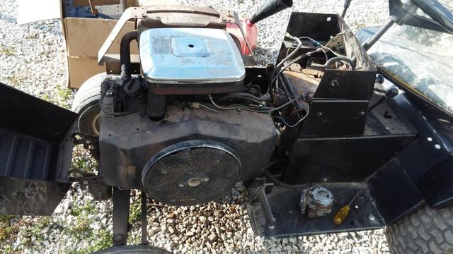

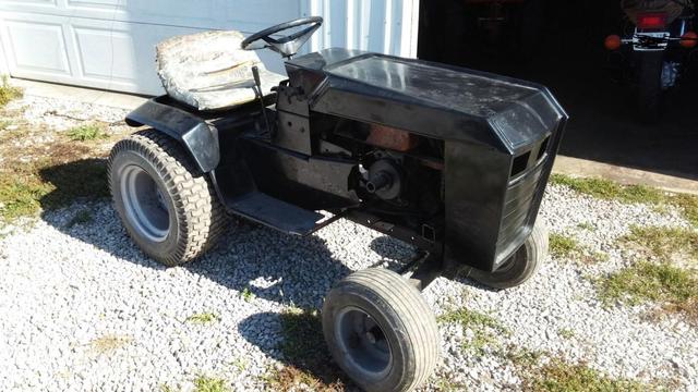

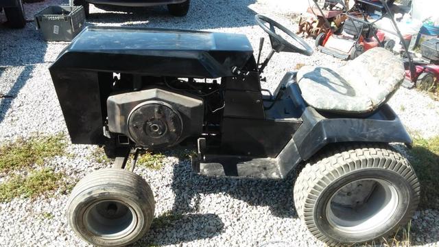

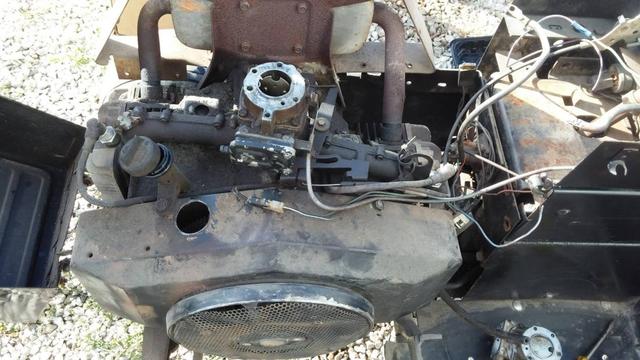

rustyoldjunk 127 #1 Posted October 21, 2014 (edited) It is in rougher condition then I thought ( I should know better by now ). It needs a drive belt,a fuel pump,and some wiring work. It has been almost completely re bodied. The paint job is actually one of the better repaints that I have seen but I am not crazy about black. He hadn't put it on yet but he gave me the top piece for the dash to make the re body complete and to make the hood fit right. I am not sure what I will do with this one yet. When I checked the oil it was pure black gas. I drained out at least a quart and a half. It also is missing some engine tin. He said he thinks it is the original engine but the main engine tin and screen do not look right for what was used on the Work Horse tractors. Here's a few pictures. What would you do with it ? Edited October 21, 2014 by rustyoldjunk Share this post Link to post Share on other sites
Martin 2,134 #2 Posted October 21, 2014 (edited) clean it up, get it running right and make it look they way you want. fuel pump is just some gaskets (pump is on the side of the carb), the tins on the engine look right, the screen on the flywheel needs to come off and maybe that round part as well, its been a while since i had my screen off, but its really just missing the screen that covers that whole flywheel side of the engine. my 1848 had pump problems when i got it, easy fix, the gaskets and diaphragm are easy to replace on the side of the carb, run some decent oil in the engine and change it out a few times and see what you've got..... heres the thread on when i got mine...... Edited October 21, 2014 by Martin 2 Share this post Link to post Share on other sites

Aldon 4,832 #5 Posted October 22, 2014 I really like the black. But it's eye of the beholder thing. Make it your own...and let her run! Horses like to work! 2 Share this post Link to post Share on other sites
rustyoldjunk 127 #6 Posted October 22, 2014 I did grab a fuel pump out of my carb stash and put on it but of course it needs a rebuild too. Putting a little gas into the carb it starts right up and the engine sounds good so it sounds promising. Share this post Link to post Share on other sites
Pullstart 71,187 #7 Posted October 22, 2014 looks like the 18 horse engine on my wood splitter! heavy cast base, square air cleaner on top... Share this post Link to post Share on other sites

Ken B 3,203 #9 Posted October 22, 2014 Get her running and see what you got. If she runs good and the hydro works nice a super cleaning is in order. Personally, I'm not into the black. If after the cleaning the black paint on the frame, suspension parts and rear diff is good enough to leave then I would. I'd repaint the rest of the tins red and put some new decals on it... Share this post Link to post Share on other sites
Geno 1,931 #10 Posted October 22, 2014 Since it's already all black wonder what it would look like if you switched colors. Everything normally red would be black and paint the normal black hood part red? 1 Share this post Link to post Share on other sites
