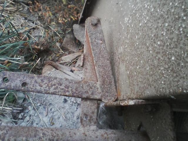

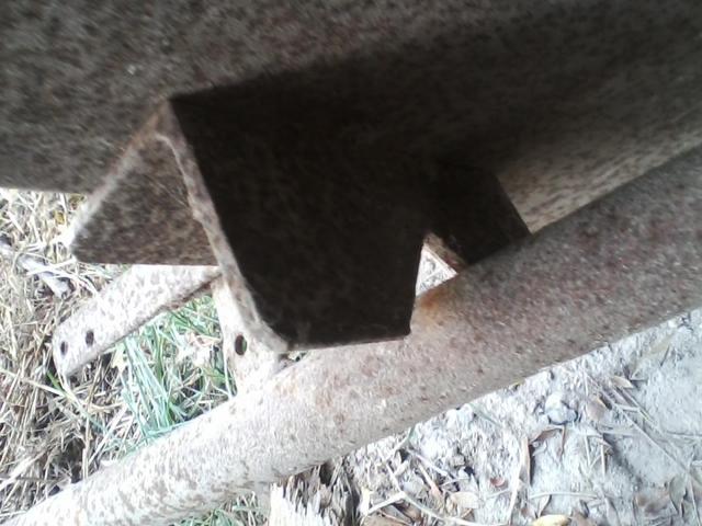

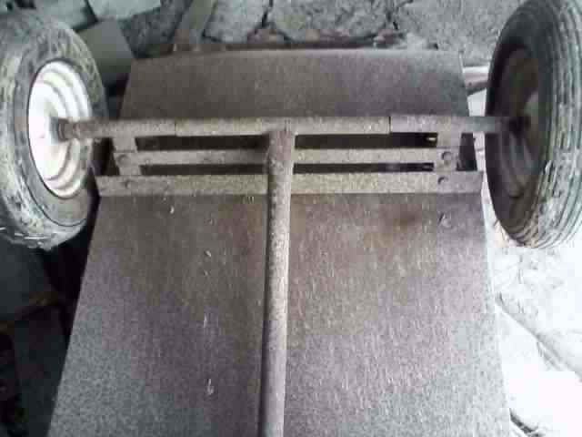

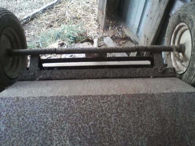

Japple67 3 #12 Posted October 20, 2014 The larger one out of sheet metal I think was boughten not home built but it's 12" deep, 26" wide, the floor is 32" long and the top is 44" long. 28 3/4" long axle tube is cut in two places to allow the tongue to hinge on the axle. axle tube is mounted via a triangle the lower point being, the axle tube, and the top points being angle irons welded to the trailer bottom. the rear slope is 17" and the tongue is 36" with a slight bend in it. the axle center is 22 3'4 from the front of the bed. That's a mess I know, but I have another I'll Get some of the same info and pictures for. it's also a dump bed but welded out of garage door pieces and angle iron with plywood sides and floor. 1 Share this post Link to post Share on other sites
